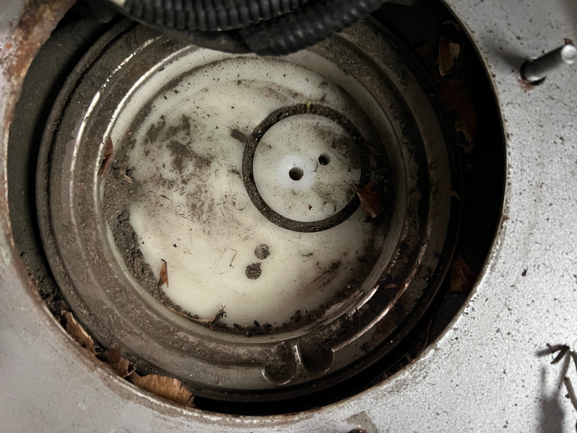

Would a 03 s60 2.5t awd fall under this? I do not have a FPS on the fuel rail, and can not find the PEM unless ingot to drop my plastic fuel tank?

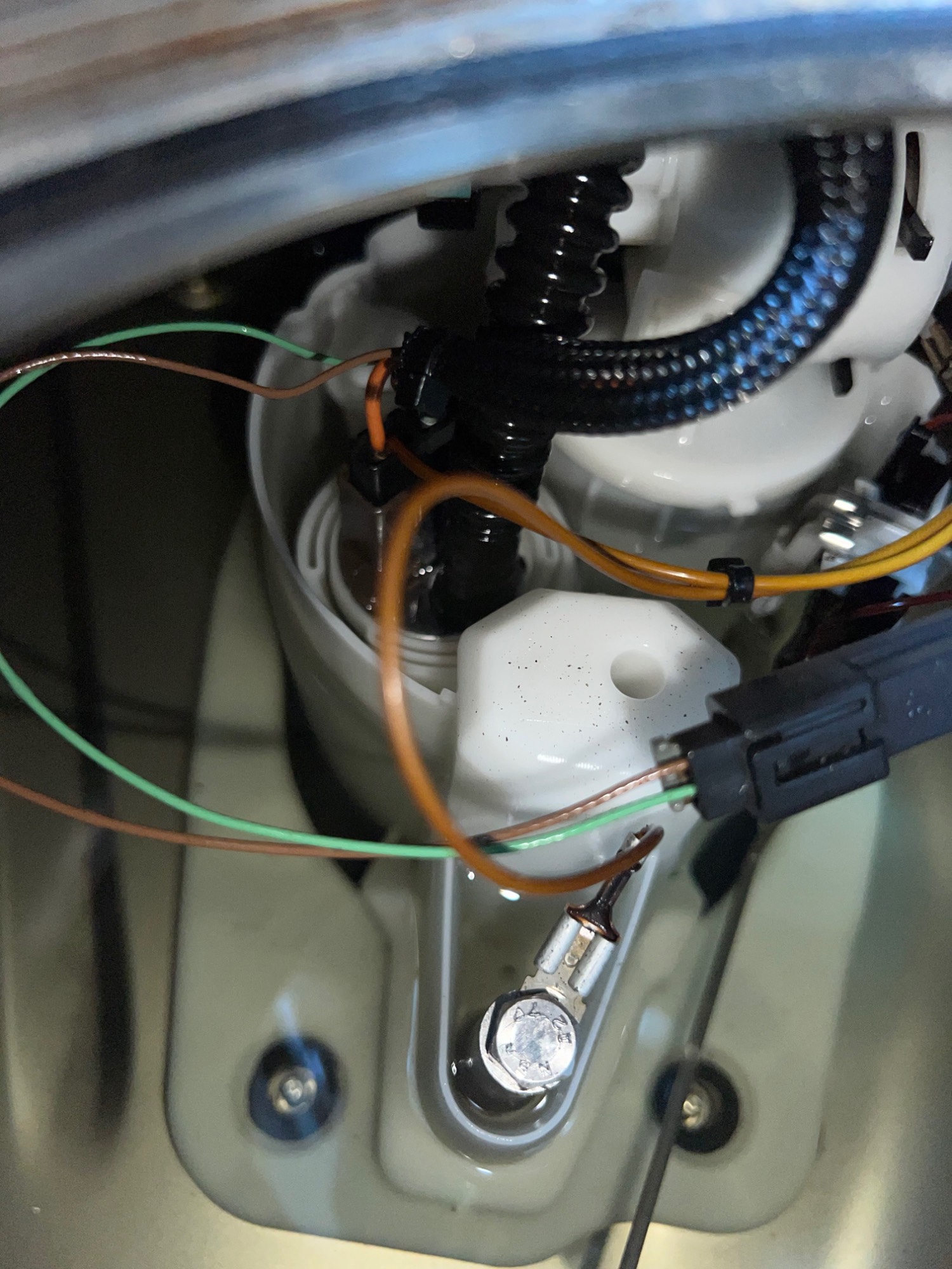

My son and I are swapping a fuel pump out on his 95 850, but the replacement comes with three wires. A red / black in a connector that fits fine plus a thin black wire. Is this a second ground?
Thank you in advance!

LuthierIan wrote: 16 Sep 2021, 01:10 I know this is an old thread but it’s still being accessed, so I offer some additional info that has taken me 3 weeks to work out;
there are several different fuel control systems on P2 V70s, XC70s and XC90s dependant on year/month.
the system often discussed has a PEM (or FCU) which controls fuel pump output via a PWM signal from the CEM, this system has a pressure sensor on the end of the rail and a (mechanical) regulator somewhere between the send and return lines, can be in the engine bay by the RHS drivers wheel or actually in the head of the fuel pump! The PEM can be located near the fuel filter, or in the spare Wheel well in the boot or on top of the fuel tank!
However, you may not have a PEM at all. A few models are ‘controlled’ (just switched on really) directly from the CEM (via the fuel pump relay). These pressurise the fuel line, but have no pressure sensor (or even fuel damper in my case), and rely on a mechanical pressure regulator built in to the fuel pump head on the return line in the form of a pressure relief valve.
How can you tell? Apparently from the VIN - but this didn’t help me. The clues are; no pressure sensor on the rail, possibly no fuel pressure damper fitted, no PEM anywhere! The definitive test is to take the pump out and look up into the head, if there is a metal insert with a hole in the middle and a star clip holding it in place, then that’s the regulator on your system.
You will need a replacement pump with one of these built in if the regulator has failed. If you get one without this, it might fire up and idle but will likely falter under load.
To compound the problem, several different wiring configurations exist,
1) with all the connections on the RHS
2) with all the connections on the LHS (where the second fuel sender is located)
3) with a combination of some on each
In searching for your PEM (which you may not have), follow the wires away from the pump, if you have none heading towards the fuel filter area, spare wheel well, or top of the fuel tank, then you probably don’t have a PEM (like me!)
I highly recommend getting the correct tool for removing the pump and/or second sender - at only £20 they will save you breaking the plastic locking rings.
This post should be stickied!

Hey thanks for the great info!!!, so it turned out that my V70 has the steel gas tank!, which I know a lot of peeps know that there was a weird year or 2 that the switched some stuff up why I have no clue but for my version 2004 2.4L FwD it has the steel gas tank and the fuel pump itself is accessible only on the passenger side back seats and doesn’t have the the sender which Iv seen In other videos on Utube, so the sending unit is build on top of the pump itself. The lock ring is a metal ring (not like the tool Iv seen online or in videos) I had to use a big screw driver and just tap it and it came off easily enough. But after replacing the pump itself a week later I was having the same issue from before. I brought it to a mechanic and they couldn’t figure out of it was the pump itself or the PEM. So I took a gamble and replaced the PEM and it fixed my issue!!!, for my version of the car it was located in from of the passenger side rear wheel well on top of the gas tank! :o)
