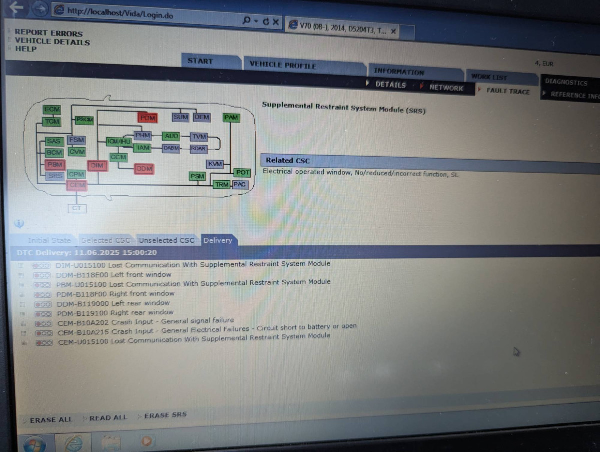

It shows multiple codes for "lost communication with srs module" that's why me and David E7 were leaning into checking that module first.

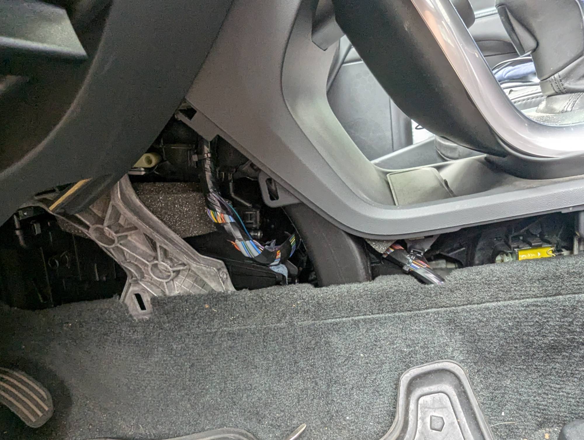

I found the module with the green connector, but I couldn't take of the middle console because I cannot find a tutorial. Just the sideplate of the middleconsole and you can get the connector

there are youtube videos.

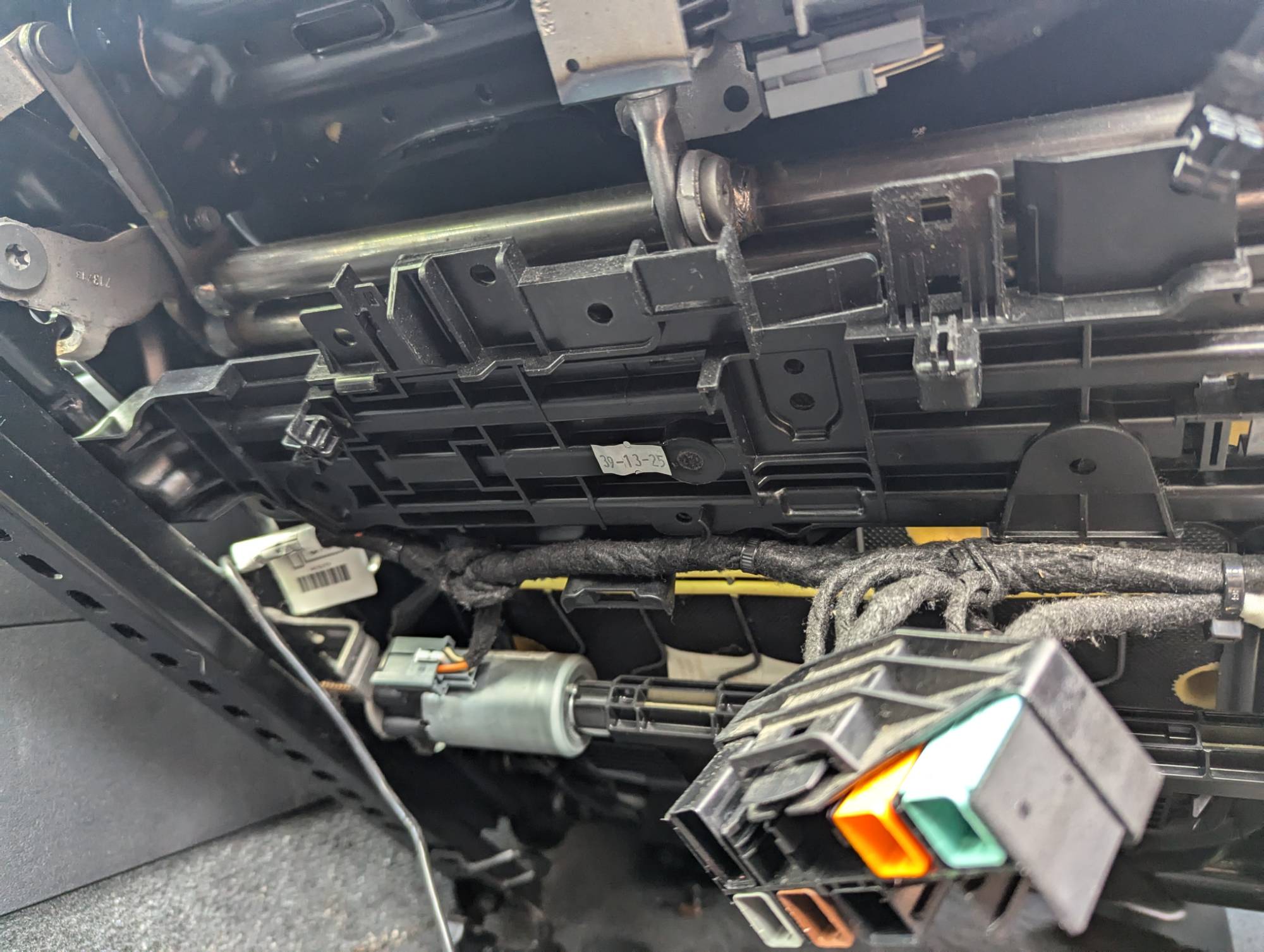

Today I took out the seat and removed the seat belt pretensioner. The sensor is defective. It had no change in Ohms or electrical flow.
I made a bridge to simulate a closed seat belt and the SRS module is still showing of the same issue.
I ordered another seat belt pretensioner and maybe I will need a srs module. Can I just swap the modules or do I need to install programm it with vida?

Yes, I've erased it but it still isn't turning yellow.
I wait for a replacement belt lock pretensioner since I thought this may be the problem. It showed something above 3 Megaohms on my multimeter
