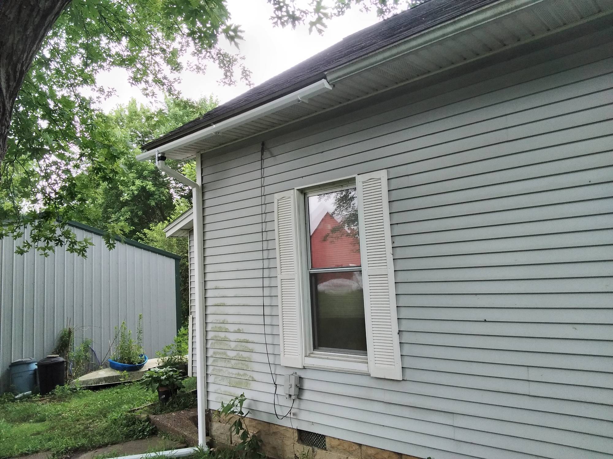

I hate getting up on a ladder to clean gutters, so I devised a solution. Why not make removable gutters? I got my first 10' section installed and it seems to be functioning as planned. It takes maybe 2 minutes to remove and 2 minutes to reinstall. My roof is about 29' 6" so 3 gutters will cover it. They're not as sleek as the 1 piece gutters but it's a small price to pay to avoid the ER. The house is very near 100 years old anyway.
The downspout is not fixed to the gutter, it hooks to the gutter and clips to the siding. CAD skills and a 3D printer would be good to make more esthetic hardware, but those are skills I don't possess. In addition, I might just be a kook.

I have trees around the house and get a lot of debris from those. Sticks, leaves, seeds. That stuff gets into the gutter outlet then the downspout and plugs up quickly. So, I decided to do the removable gutter.
