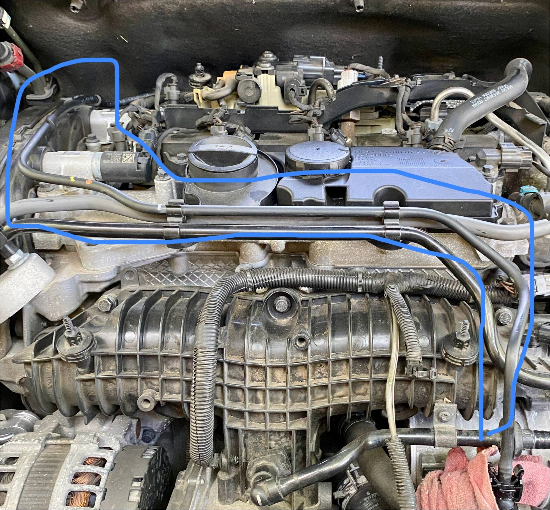

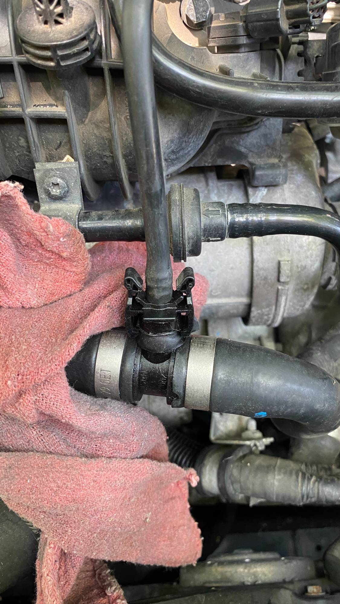

New user and needing some help identifying a hose sitting atop the engine. I believe it's tied to the turbo but can't locate a part number but I've attached a photo. There's a small leak near the bottom of the photo where the red rag is. I've searched a few sites but no luck.

That looks like the turbo cooler line that runs up near the firewall #23 on the Volvo parts diagram. The connecting line is #39 on the diagram, I believe. Both should be available from FCPEuro cheaper than the dealer, but I know for sure they had the turbo coolant line in stock last week when I ordered it. It’s a bitch to get the line on the turbo so hopefully you’re looking at the line with the connection instead since that’s a fairly simple removal and installation comparatively.
You’ll want to confirm but the turbo coolant line part no. I have on the packaging is 32222278.

Thanks for the guidance. I happen to have the same part number but wasn't sure as the connection looks different.

I think there’s some variation based on VIN for line configuration so some of it may look different than the parts diagram so you can confirm by tracing lines off that connection to see what they connect to and then verify against the parts diagram.

Just wanted to provide a follow up - SUCCESS. I was able to get everything back together and the vehicle is running great. I'm dealing with another issue but appreciative of the guidance provided on this forum.
