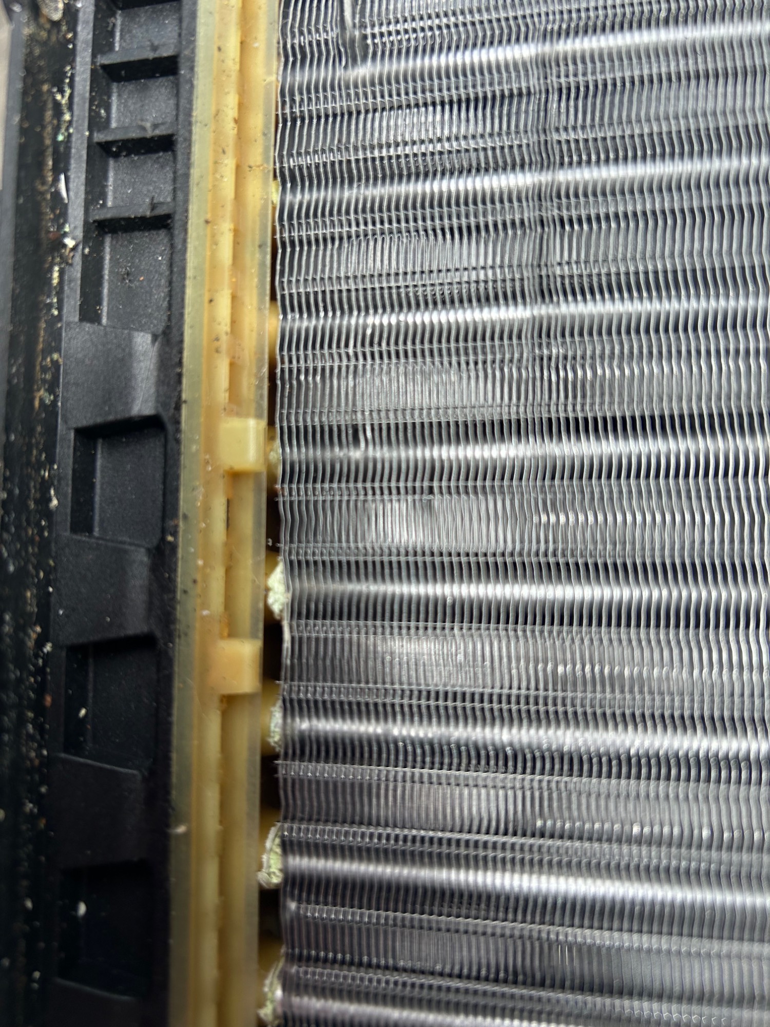

Here’s a picture of early heater core seep on one of my 1999s, found during a hvac evaporator R/R
I might have added 100 ml coolant every 6 months to this car?
I think it is dated 2014 and we’ve added about 80k miles to that, estimated.
I didn’t notice that the Al frame is lifted where it is seeping, I wonder if that’s related?
