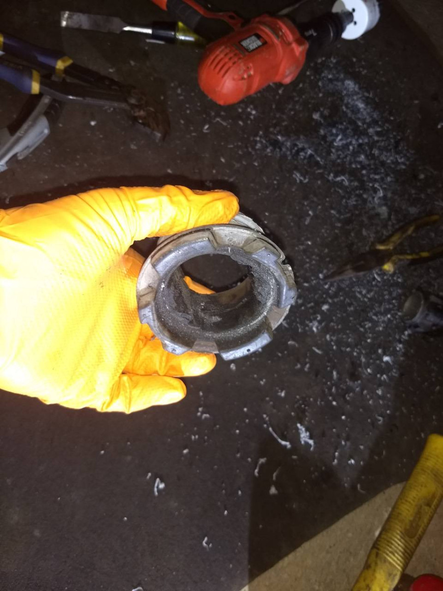

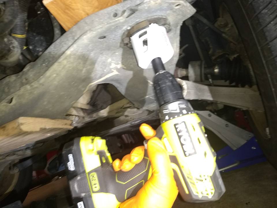

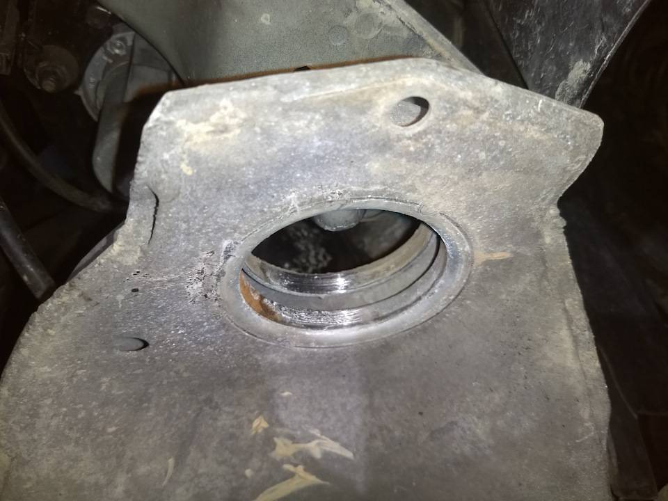

I just drilled the front ones out with 2-1/2" hole saw (it happens to be the perfect size). Need a good one, and a mighty drill. No need to drop or lower the subframe other than one corner at a time.
(this drill didn't cut it)
