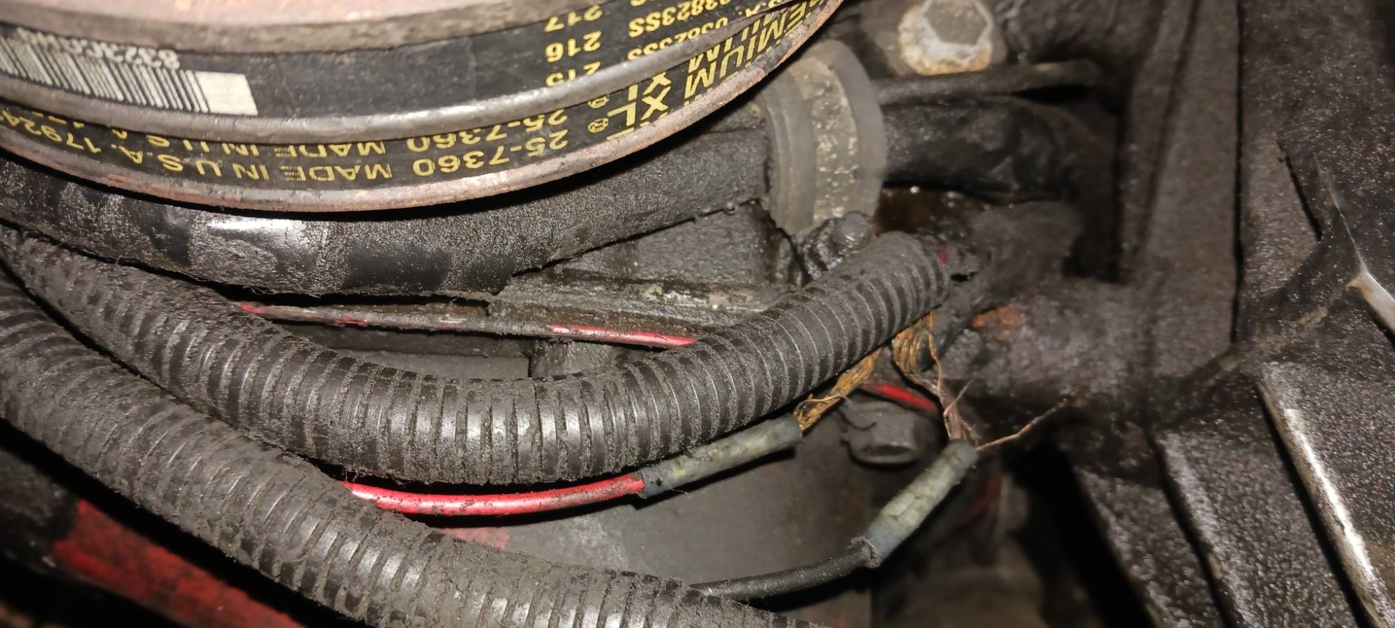

Thank you for the suggestions. I fiddled around with the wires inspecting them. I think I am pretty sure what the problem is, the wires for the exciter and oil pressure sensor. have attached a photo of the wires they are at the position of under the crack case. I Any suggestions where to find replacement or splicing?

Cut out and replace bad wire with crimp connections covered with shrink tubing. Even better, use soldered connections covered with shrink tubing.
Cover the finished wires with new split wire harness cover.
