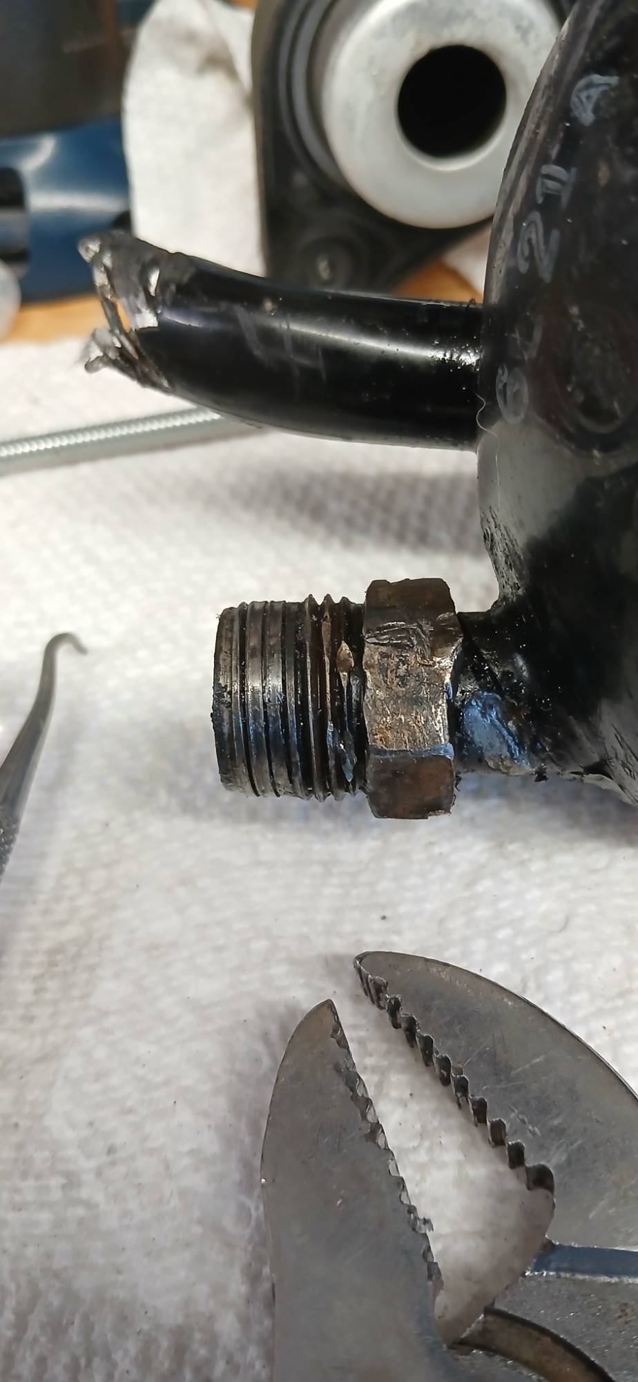

Had to put torch to it and a lot of muscle like others, but it finally came off stripping the old threads.
Now hose won't thread on new drier.
Any options other than buying new hose?

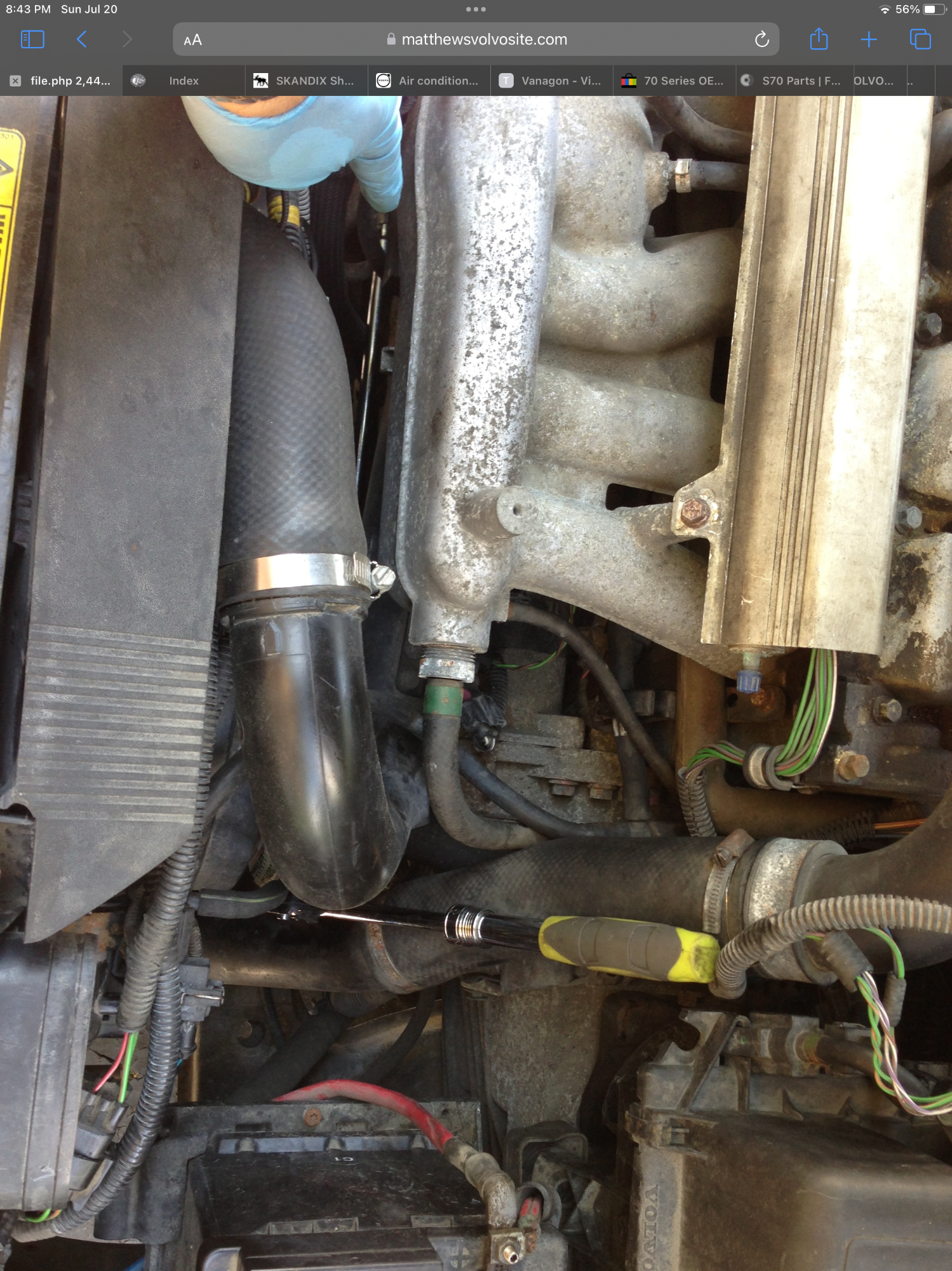

There is a link in that thread about pushing 24 inches of socket extension from the left side of the engine ( driver side) and getting the internal m6 but firm;y into the screw that holds the suction line in. It’s tight but doable.
If the internal hex strips, go to an external fluted screw extractor, that will get it.
Here is the access on a turbo. A ball head hex bit will help with approach

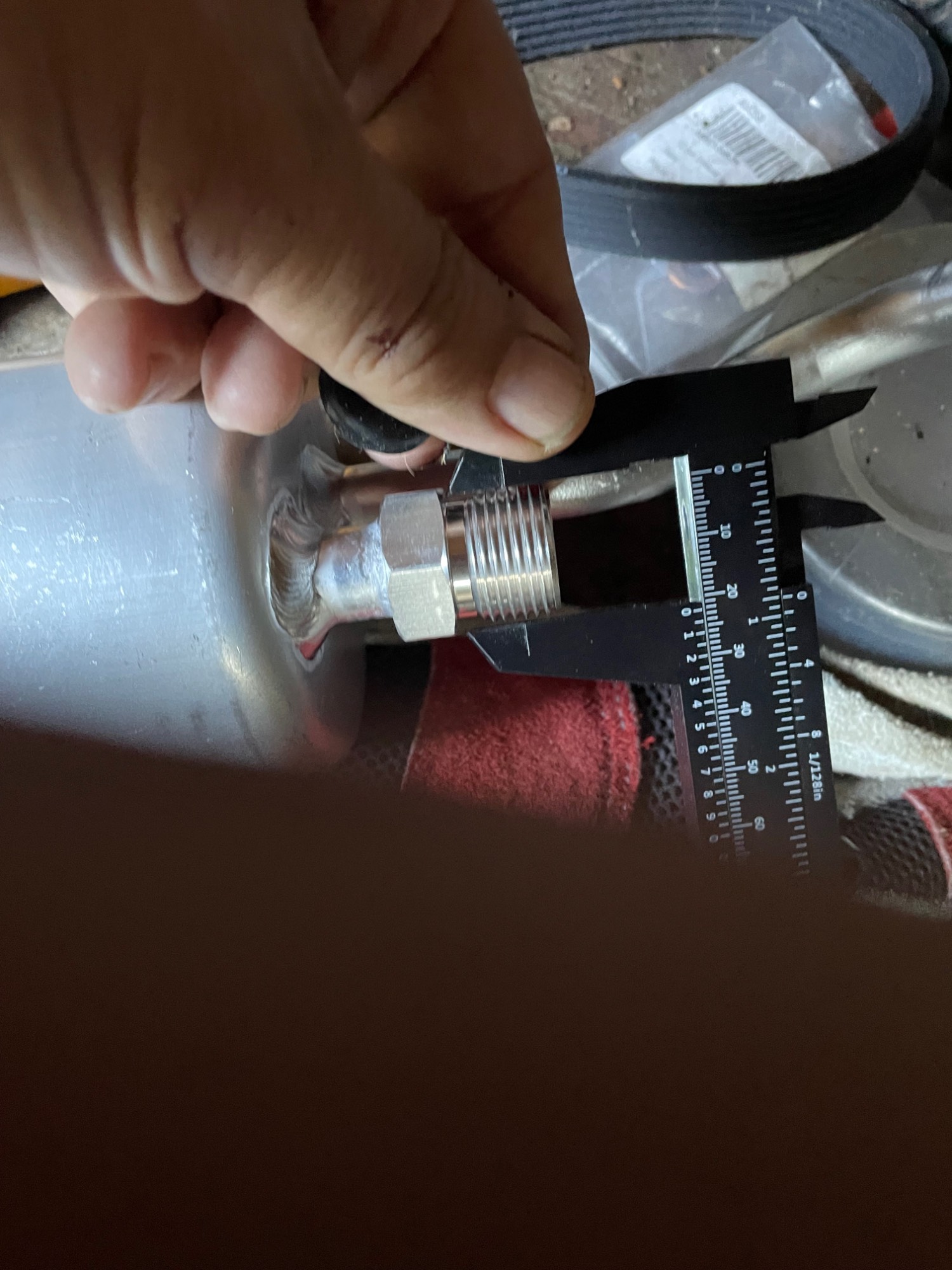

I’ll measure the size and pitch this morning. Maybe worth a tap to try and recover the expensive hose ?
Skandix has it for $100, there are a couple of scary $15 options on RockAuto
Suction hose , dryer fitting
O ring seal , not a swage or a flare
27 mm nut size
24 mm counterhold
Thread pitch M22x 2mm pitch thread

abscate wrote: 20 Jul 2025, 18:21 There is a link in that thread about pushing 24 inches of socket extension from the left side of the
When I look at your photo it looks like the compressor is on top. My 98 has alternator on top with compressor underneath it

The 1999 model still has ps pump, alternator, ax compressor mounted in descending order but all three components are 1999-2000 only in both function and fitting.

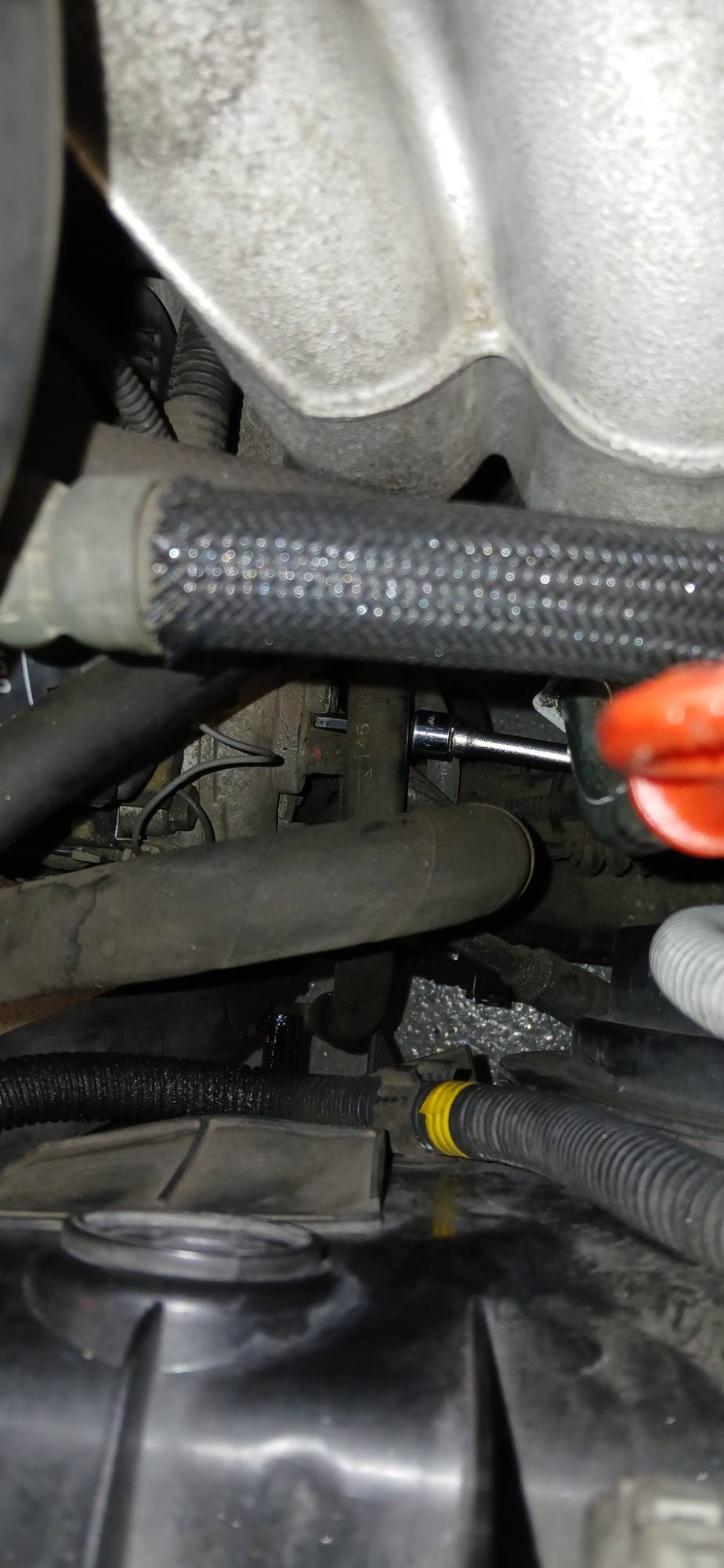

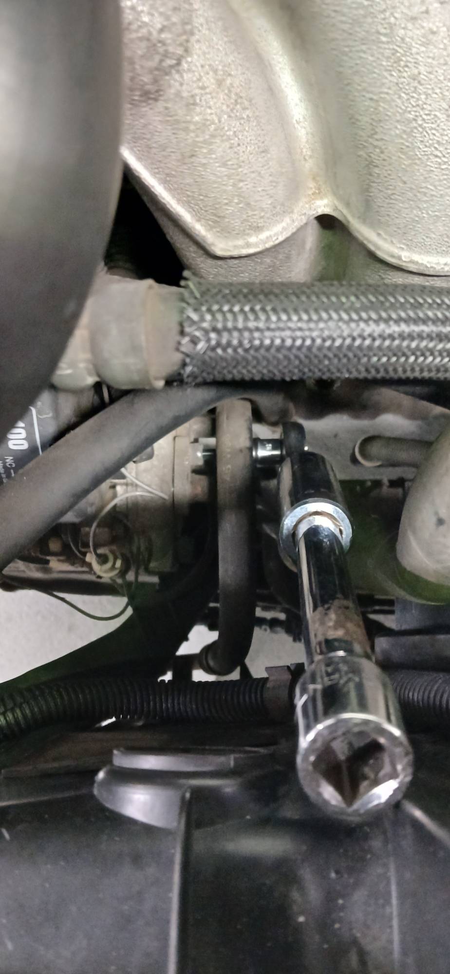

Had to remove dipstick and used a shorter handle 3/8 socket wrench with a deep socket over it and an extension on the socket to get leverage.
Because I opened the drier I got an Amazon suction hose that came the next day. Got that on put it on the vacuum for an hour, let it sit overnight and no leak.
