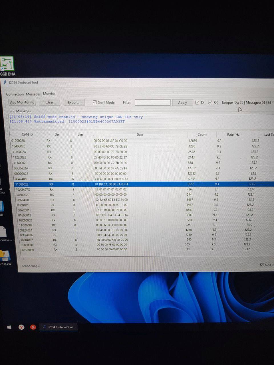

Yeah, man, it's work. That’s cool, but it works a bit slowly. For example, my DIY CanHacker based on Arduino works noticeably faster. Still, it’s a good job

GUI is slow or message receive is slow(aka missed messages)?

Message receive. The delay is about two seconds.
