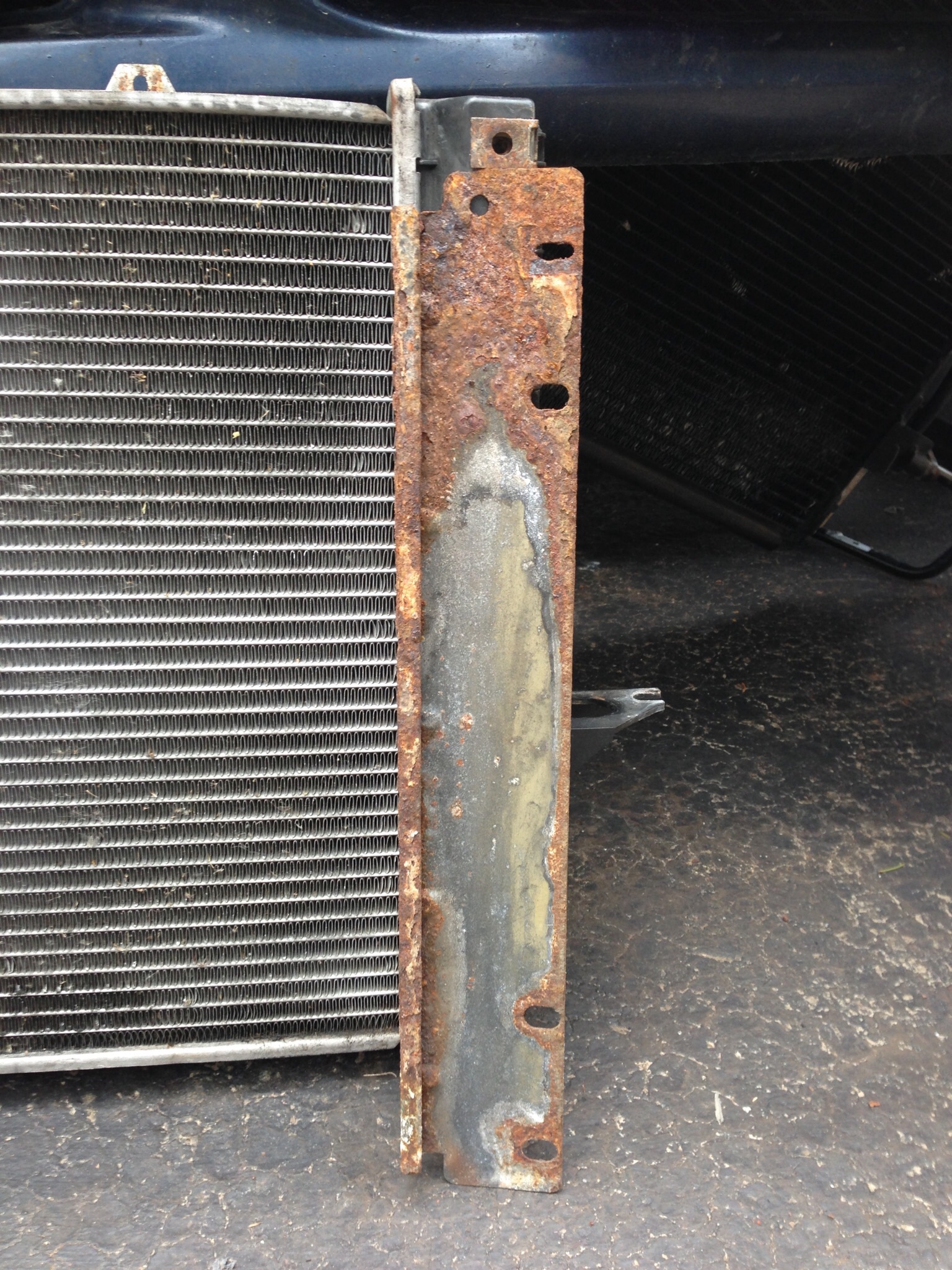

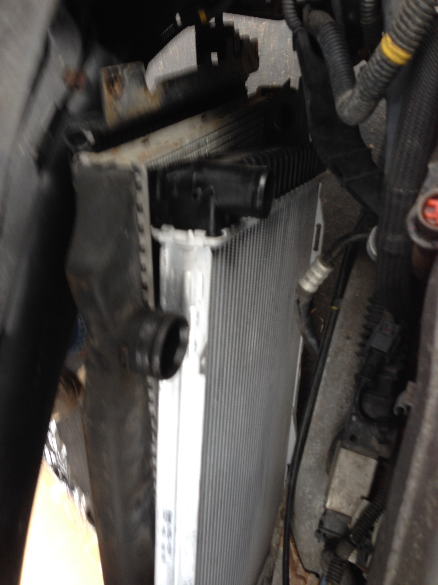

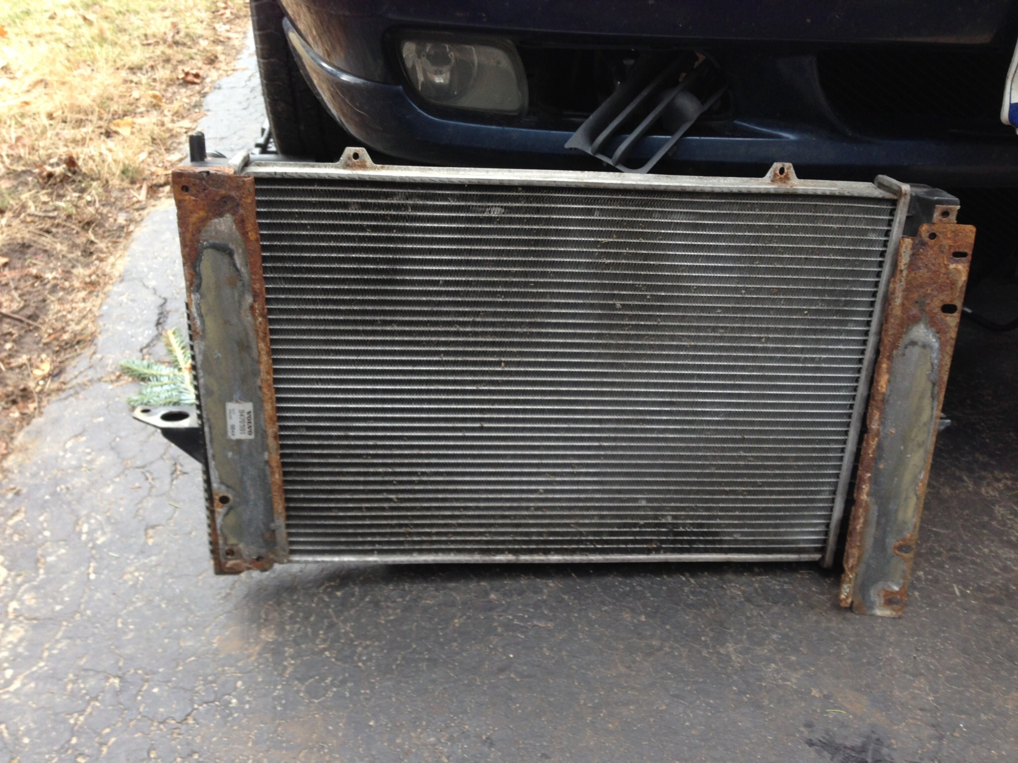

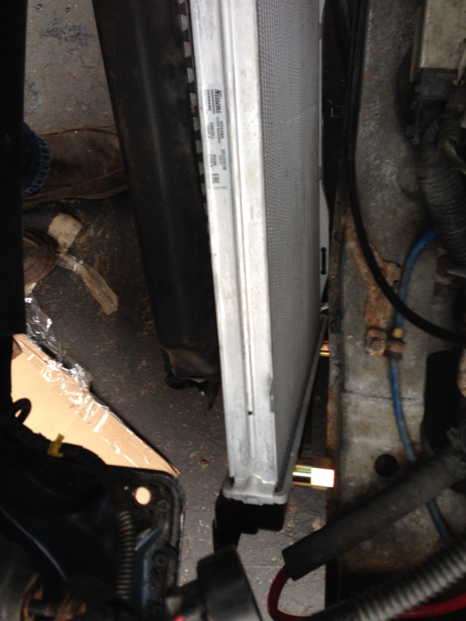

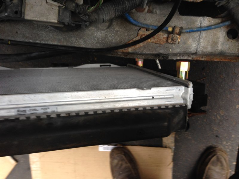

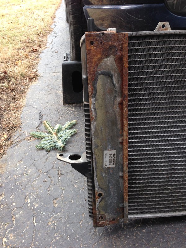

Tricks to this job. I'll write up more on plane
There is a metal sand which of 5 pieces...AC condenser, intercooler, radiator, and two metal plates which position the intercooler. They are different and go in one way.
The VIDA procedure is to evacuate the AC and bench assemble the sandwich. It's possible to skip this and do it on the car.

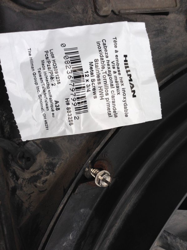

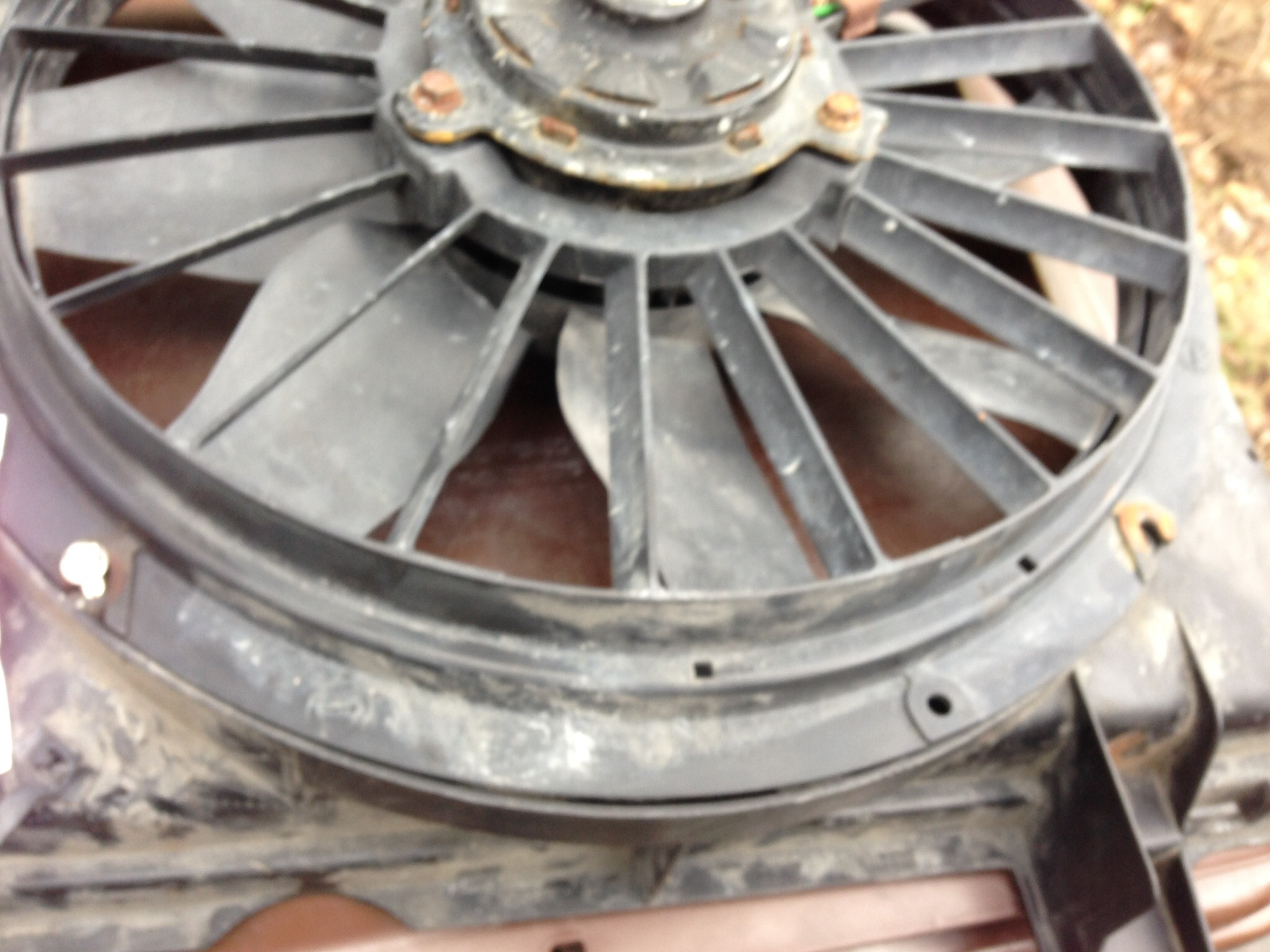

On my T5, removing the fan and shroud means releasing the two upper screws on the fan, loosening the lowers, the slipping the fan up and out. The fan shroud unbolted but you need to remove battery and tray to move it left and out to clear the ETB.
With the fan and shroud out, you are ready to deal with sandwich.

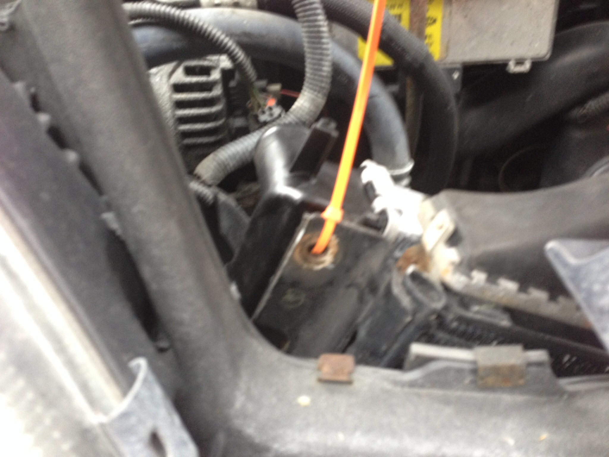

The condenser will come down on the driver side, and stay up on the pass side , so you have to reassemble the five pieces cocked at an angle working under the car. I pinned the top corner, pass side with a zip tie, leaving off the plate at first , this made it easy to get the bottom driver side 10mm bolt nut washer in. Once you have one bolt in loosely, the sandwich is much easier to manipulate and get bolts in. I replaced the clip,nuts with SS M6 hardware from Lowes. I loaded the washer with a pick, and held the nut inside with needle nose pliers..access is tight. I'll document the length, you don't want the M6 too long or you will crack the radiator!
The bottoms are easy to access, the tops are a bit harder.

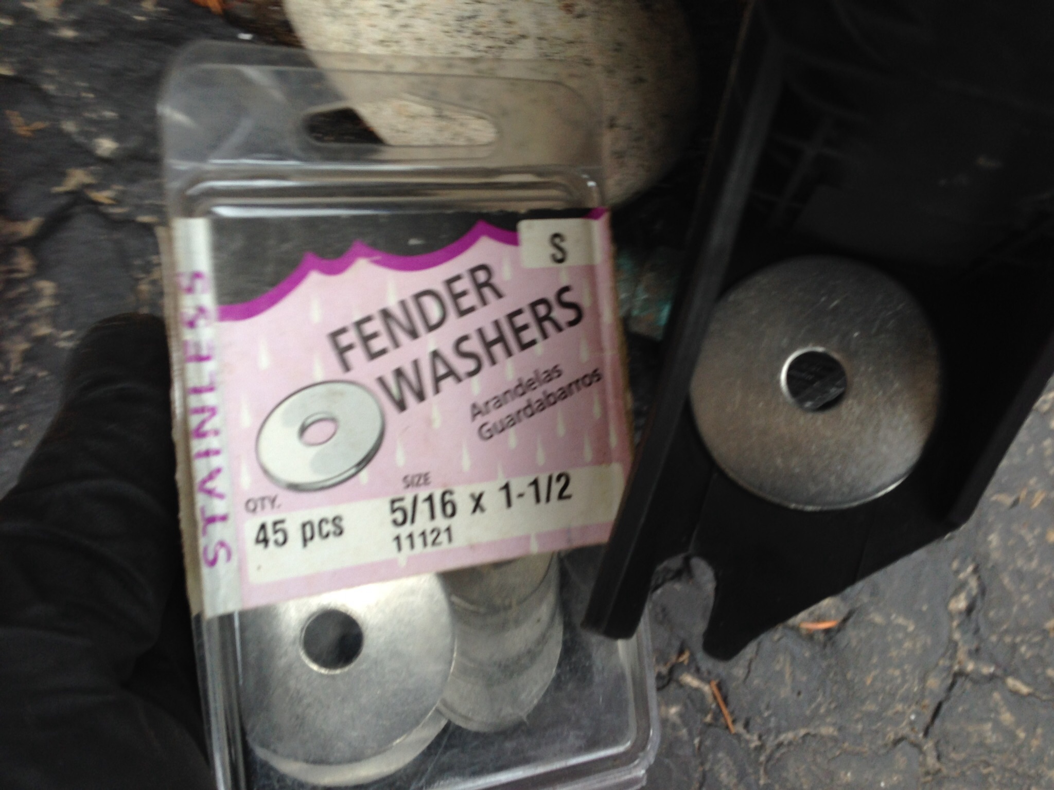

I replaced the captive M8 radiator bolts, notorious for freezing up, with SS M6 and heavy washers. You could probably triple zip tie these.j

Thanks for posting this stuff, Steve. I love when folks give bolt/screw/washer options! All that rust... Wow...

I forgot to close loop on this
This “ early failure “ was self induced. My SS bolts on the passenger side mount got loose and left my radiator bouncing on one mount which surely stressed the side tanks and caused the leak.
User fail.

abscate wrote: 11 Jan 2017, 11:10 I went with Nissens again. I think my 3 year+ life was on the short end of the stick, and by 5 years I know Ill have passed it on. It was a 50-50 call, to be fair.
Three huge time savers on this job
1. I replaced the 4 fan screws with SS and left the bottom two loose enough for the fan to slide out without fussing
New M6 SS for the four 'sandwhich screws which hold the condenser, intercooler, and radiator on this car.
2. I ditched the M8 radiator mount bolts for two M6 bolts with Nylocks and washers - so I didn't have to fuss with that captive nut that always breaks loose and then leaves you with a mess
Purists stop reading here.
3. put two 3/4 inch holes in the plastic apron so I can access the two top M6 sandwich screws EZPZ
Ill plug them with hole plugs from Lowes.
Well, it’s 2025 and 8years later I’m still driving this one. I guess the Creator laughs at our plans…..
I have 8 years and another 80,000 miles on the Nissens radiator with no issues
rrres
- Posts: 123
- Joined: 24 Mar 2022, 11:42
- Year and Model: 1999 v70XC
- Location: So CA
- Has thanked: 12 times
- Been thanked: 34 times
Did your Nissens radiator come with the rubber mount bushings? The Nissens radiator I received, for some reason, didn't come with the rubber mounts and I had to pull the rubber mounts from the old radiator. They were pressed in so I had to slice them a little bit to get 'em out.
