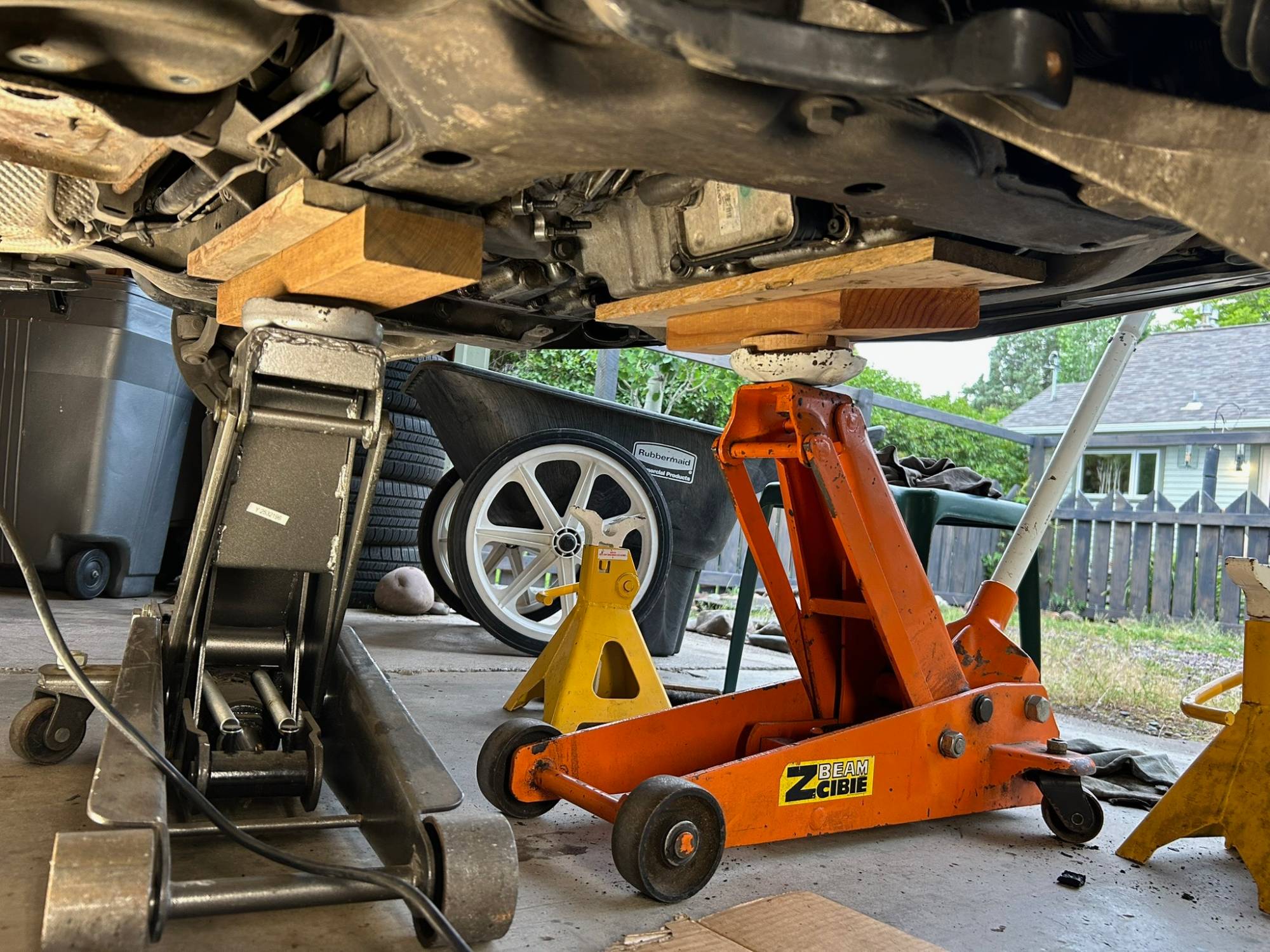

Just FYI, I supported mine from just behind the rear subframe brackets. There's a reinforced part of the floor where they attach. then I could move around anywhere forward of that. I borrowed an extra floor jack to multi-task. Since it was coming all apart anyway, my plan was to combine the subframe bushing job with new IPD sway bar & links, replace the RF axle and dust seal, replace the angle gear oil, and replace all the motor mounts. Maybe bit off too much and was out of a car for a week.

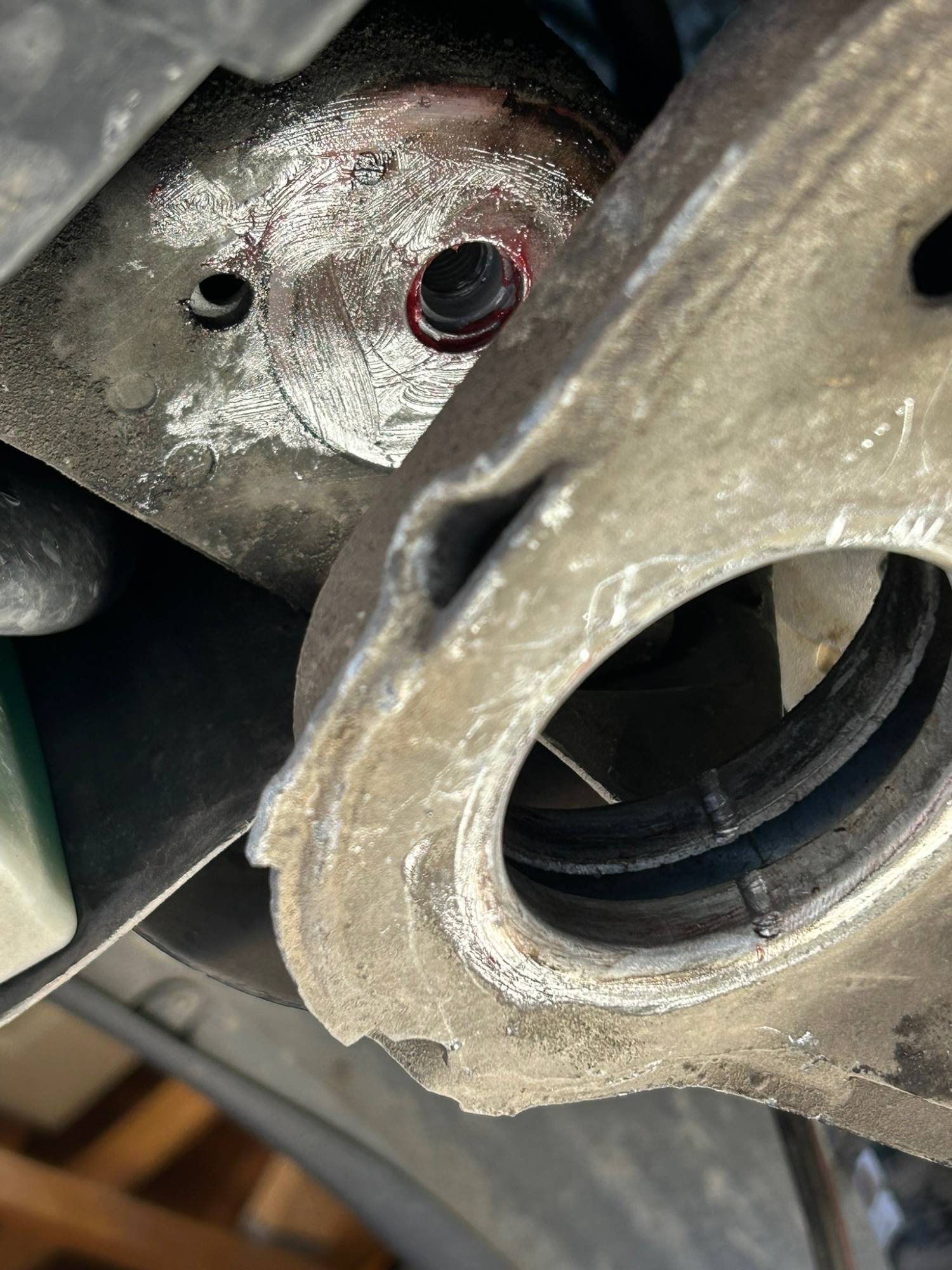

That led to my first major mistake. You want to drill out near the perimeter to catch the plastic ring, but not so far out that you gouge or score the steel ring on the subframe. I heard it and should have stopped right away. There is an upper and a lower steel sheet with a gap inside the bore.
Doesn't look too bad, a scratch, clean it up with a round file and continue.
