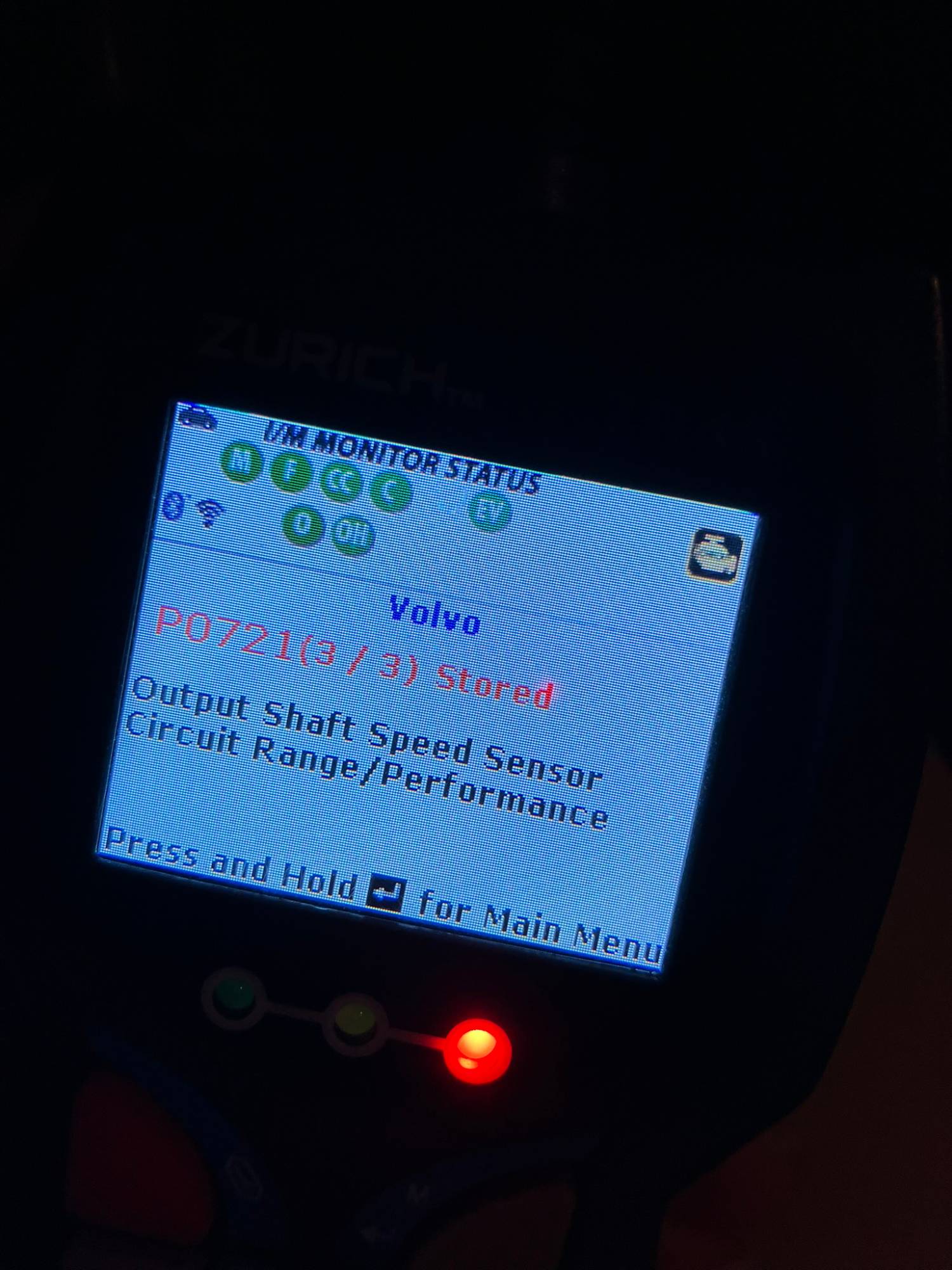

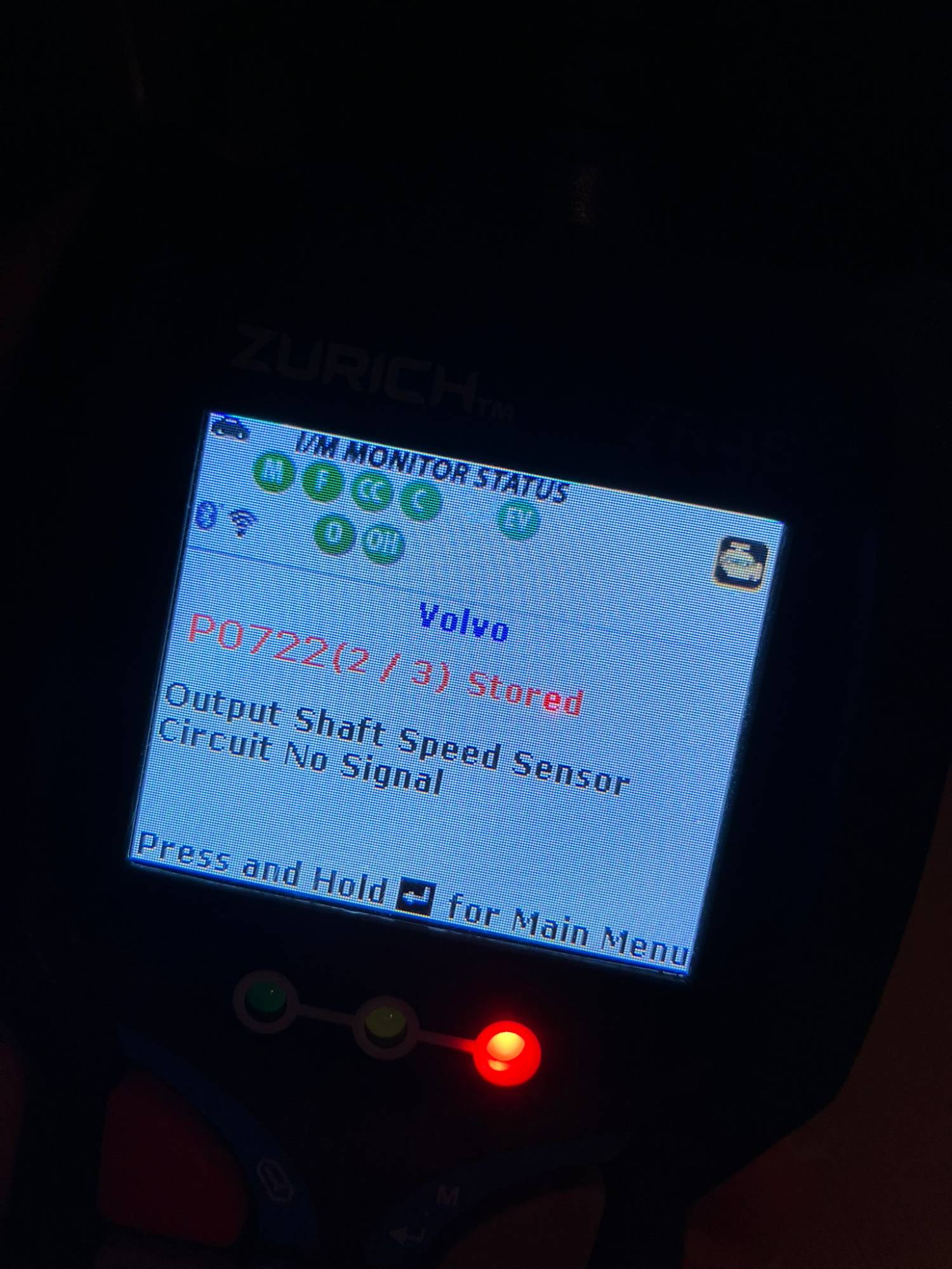

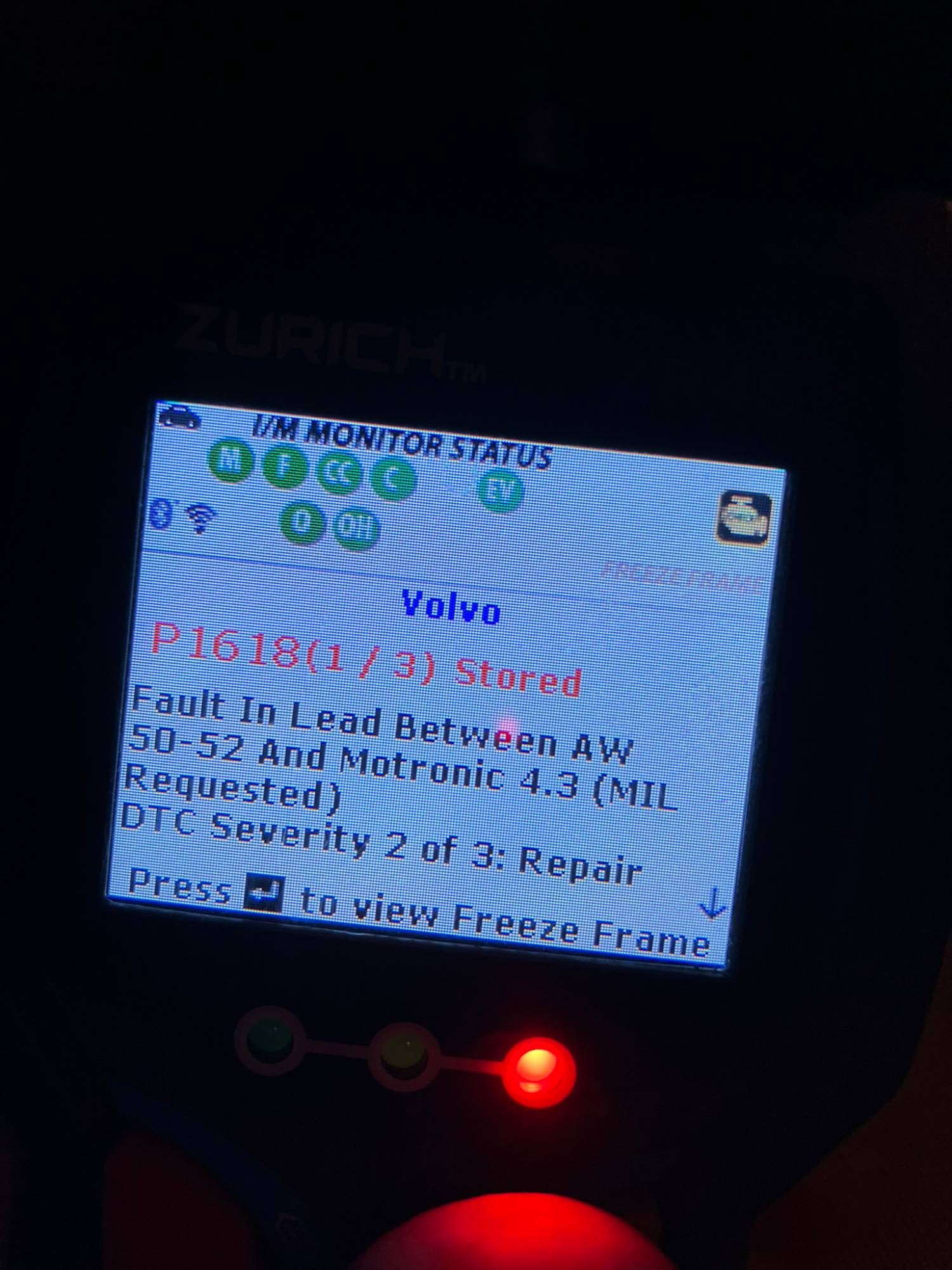

Has codes for P1618, P0721 & P0722. Local shop is unwilling to attempt a repair or install a used transmission.

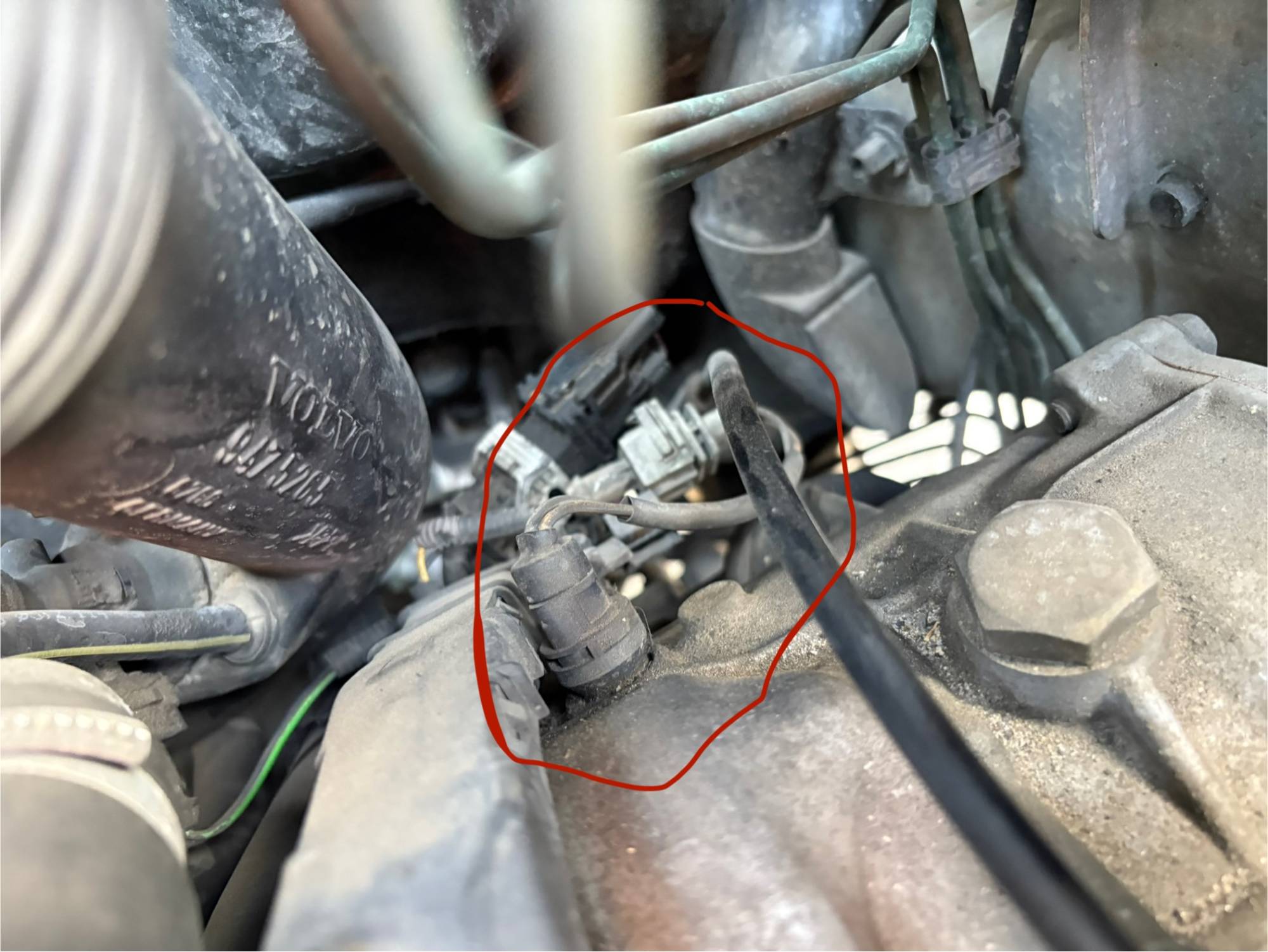

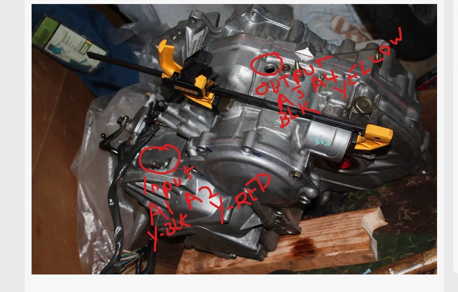

Sure, there is a speed sensor under the airbox, but that is the input sensor. The output sensor (that was replaced) is near where the lower coolant hose connects on the engine side.
Here are direct quotes via text: "This (below) is a screenshot from a post on Swede speed. Any AW transmission 01-04 p2 should have the same speed sensor, and the wire color coding will match if they pull the output sensor off another car (which makes wiring it in easy, since 01s have unique wiring for the speed sensors a used replacement will likely need to be wired in)"
"This (below) is where the sensor is on your 01. The pipe in the upper left is the inlet pipe for the turbo."
