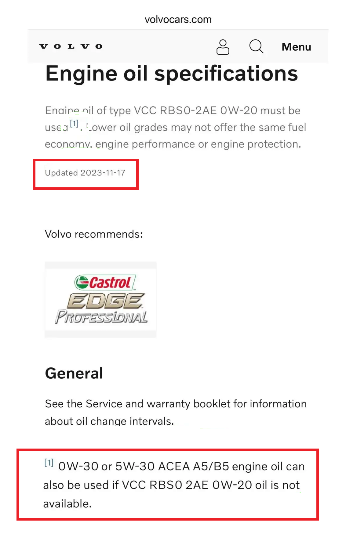

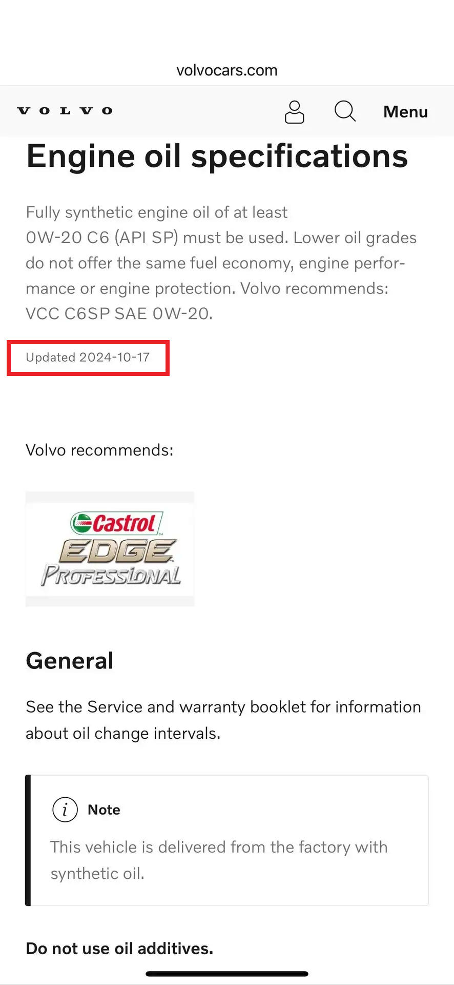

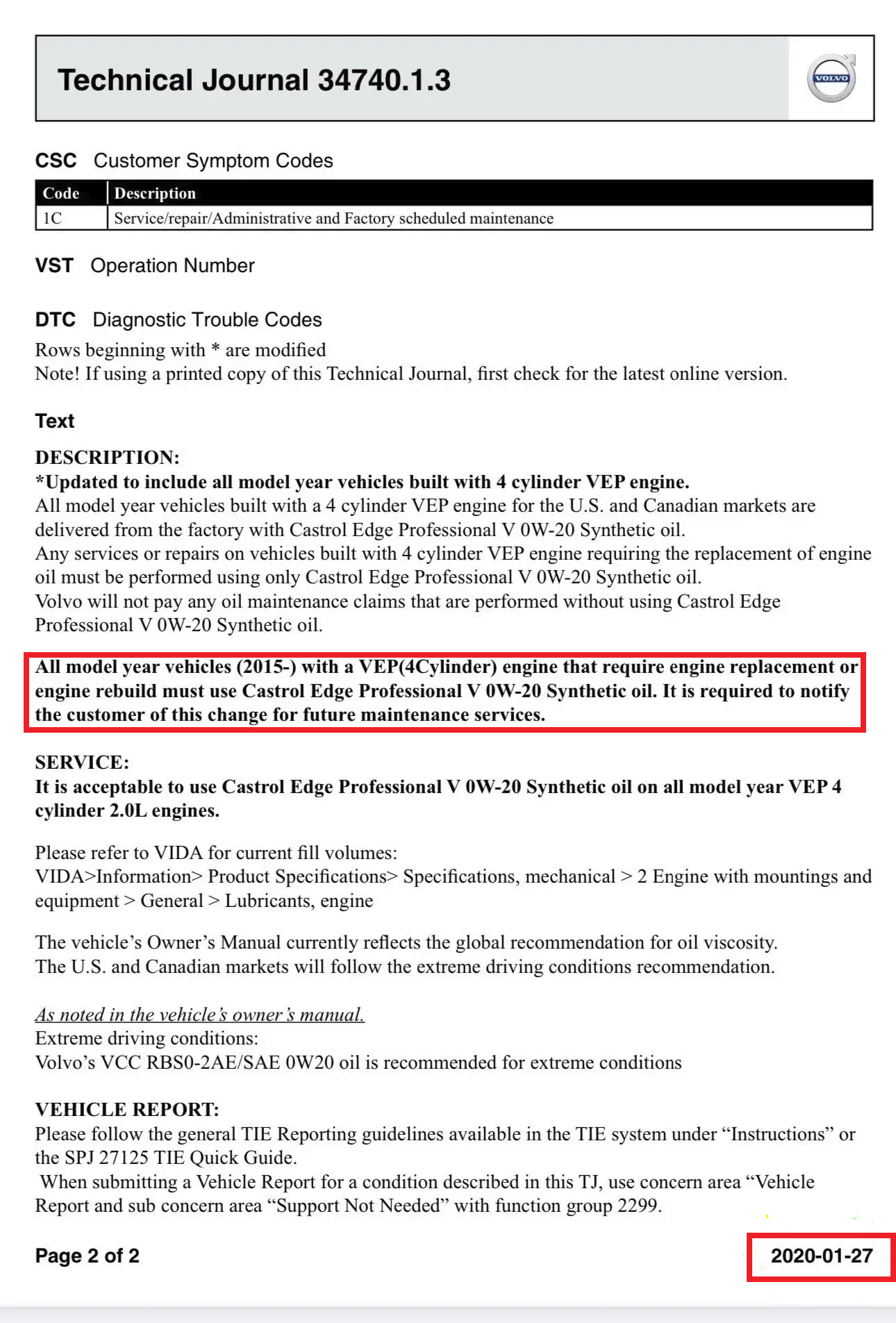

I think for 2.0 4 cyl engines Volvo originally recommended 5w/30. Then they run into some problems and issued TSB reccomending 0w-20. If unavailable they were recommending 0w-30 or 5w-30. I think Castrol was the preferred brand.

.Vova585 wrote: 14 Aug 2025, 14:56 I think for 2.0 4 cyl engines Volvo originally recommended 5w/30. Then they run into some problems and issued TSB reccomending 0w-20. If unavailable they were recommending 0w-30 or 5w-30. I think Castrol was the preferred brand.
It's back to 0W20? Probably their legal working with engineering to cover their behinds. Unfortunately the consumer is the test bed for these ultra high stress 2.0 motors going against the limits of physics. Use 5K or 6 month intervals whichever is first.

Per Tech Journal above Volvo 4 Cylinders had engine replacements and rebuilds. What was really the problem? This video is interesting.
