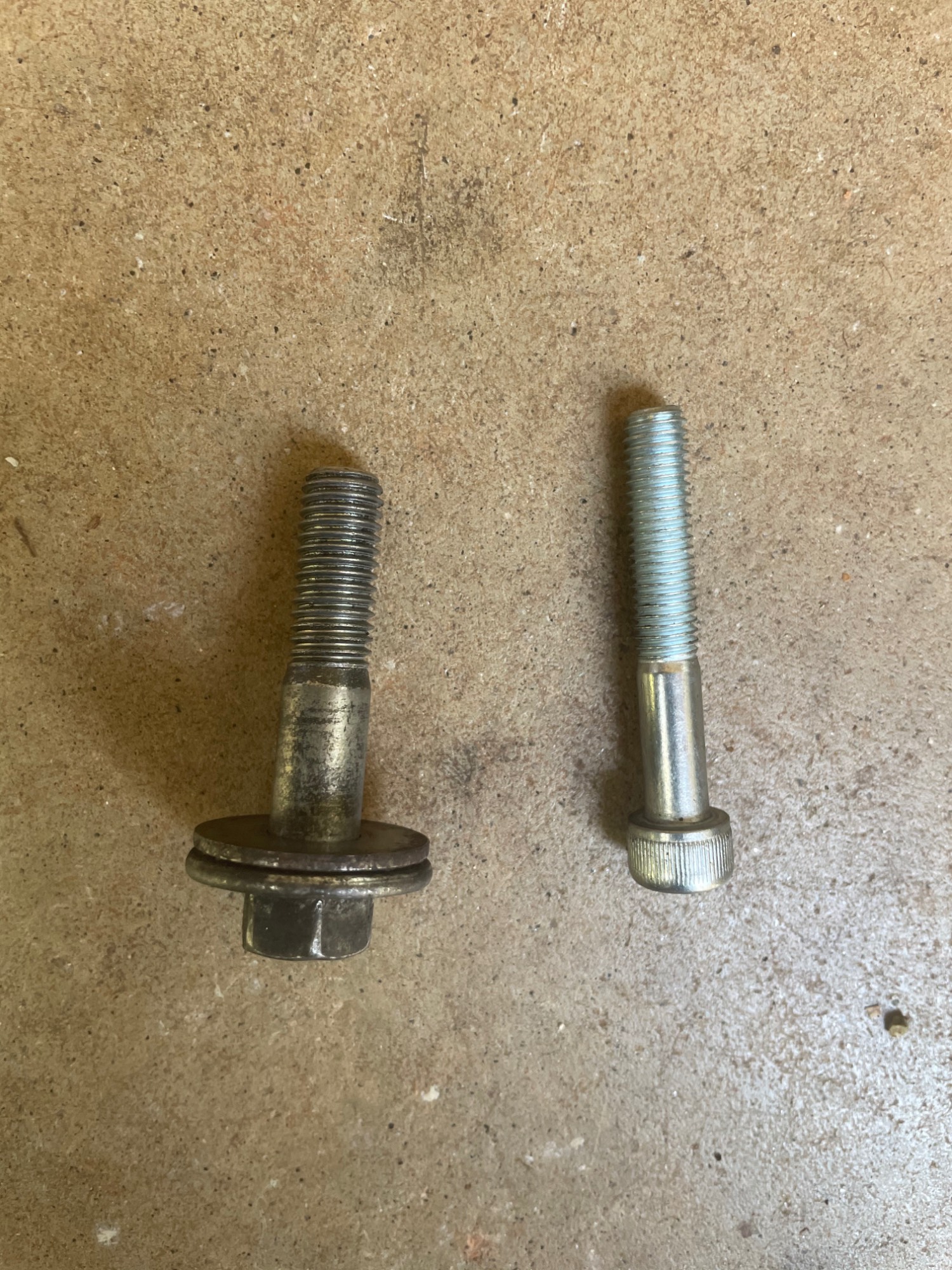

In the post here it states that the center bolt for tensioner pulley is an M8 on the block, where as later style is M6 with a Torx head. However in the following:
viewtopic.php?f=2&t=43798
it's stated that the tensioner pulley bolt is a M10 bolt size so, I am a little confused here.
Additionally, it appears recommended, in the first post noted, that you can drill out the sleeve and simply use the original tensioner pulley bolt on the later style roller however, listed in that second link it's stated you need a custom, longer M10 bolt for the later style tensioner pulley.
Lastly, a little confusion on the bolts for the tensioner itself as well. It was stated in this post that you need:
However, on FCP it shows these https://www.fcpeuro.com/products/volvo- ... 3-5-987498 and are listed as, "fitting all volvos."longer 40mm thread size hydraulic tensioner bolts 8mm X 1.25mm from later model 850 or 960 X 2

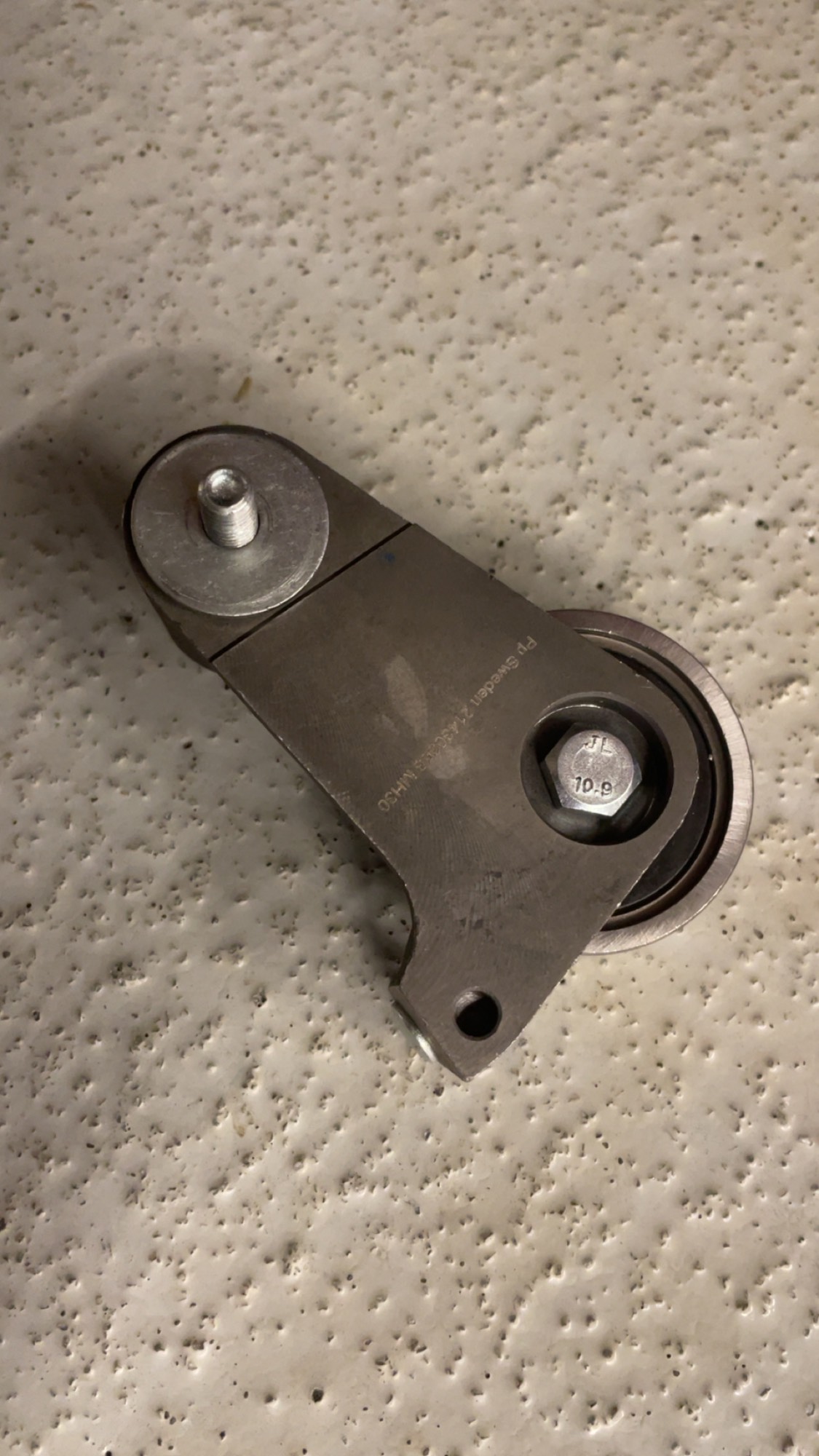

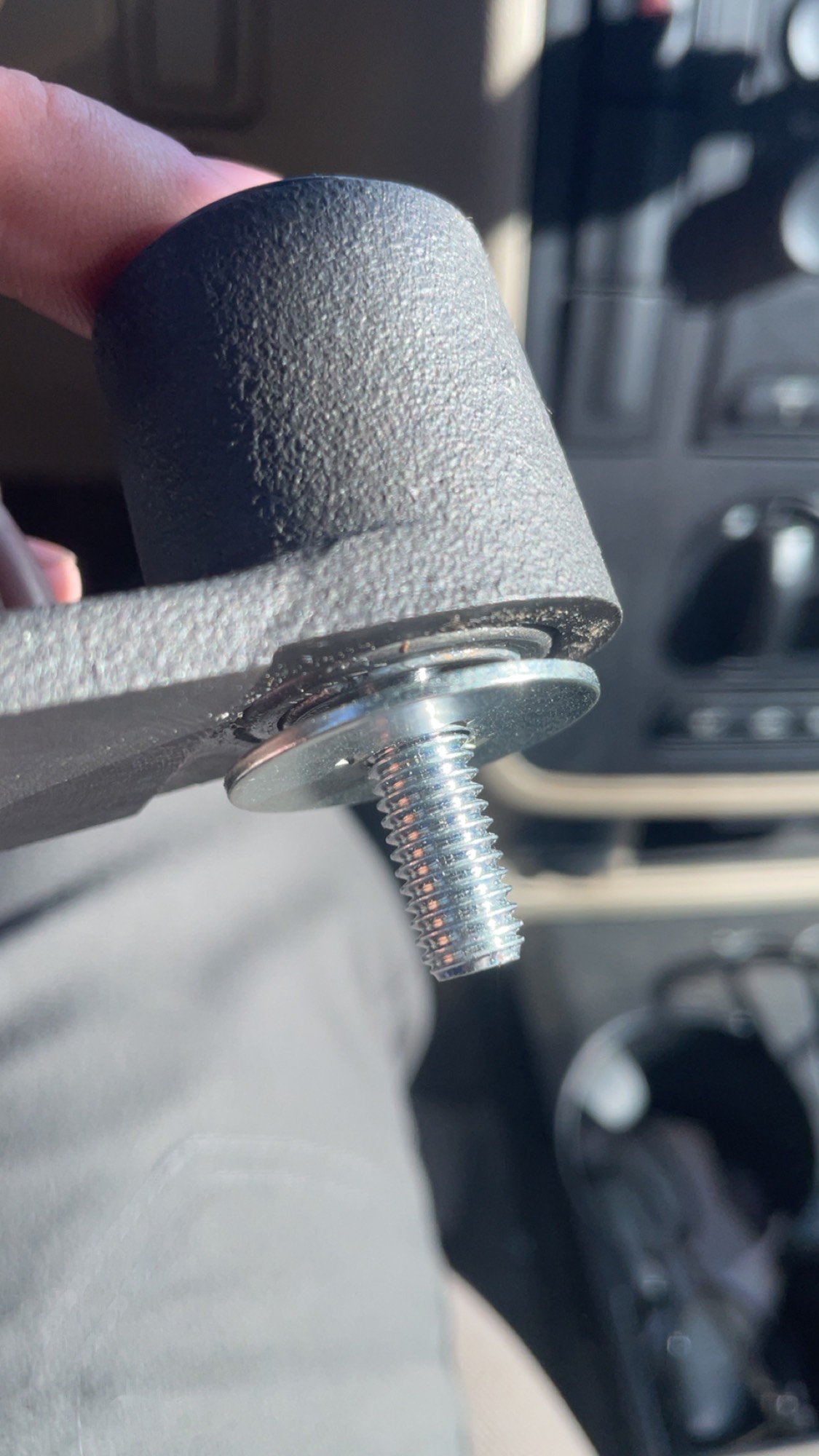

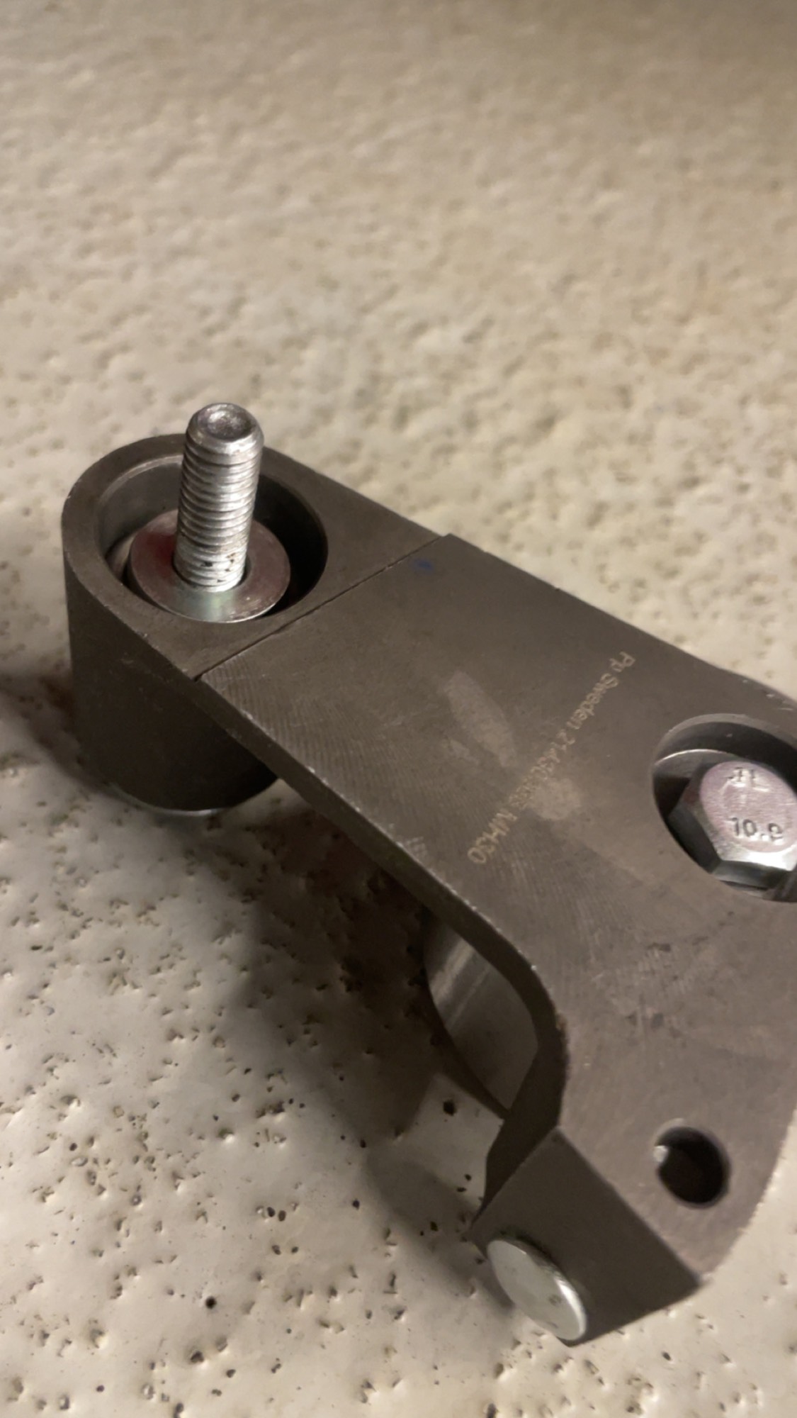

I currently already have the later style tensioner installed on my 1993 (had no option at the time) and noticed it was a little offset on the tensioner roller (which is still the original 1993) and it was the original bolts I used simply reinstalled. I assumed this offset was simply due to it not being the correct tensioner roller and would sit proper on a later style tensioner roller. Is this correct or will using the original tensioner bolts continue to cause this issues even on the later style roller?
tl;dr
1) Can I simply drill out the sleeve on later tensioner roller and use my original 1993 tensioner roller bolt, or do I need the custom (from bolt shop etc) longer bolt that listed in linked conversion post?
2) Same with tensioner bolts: Do I need to find and order the bolts you listed in your convert post or will the bolts I linked from FCP work the same (you list 40mm needed theirs appear to be ~53mm). Or alternatively, can I simply re-use the original 1993 tensioner bolts from my vehicle on the later style tensioner (as I am currently already doing) and it will sit/work properly?
