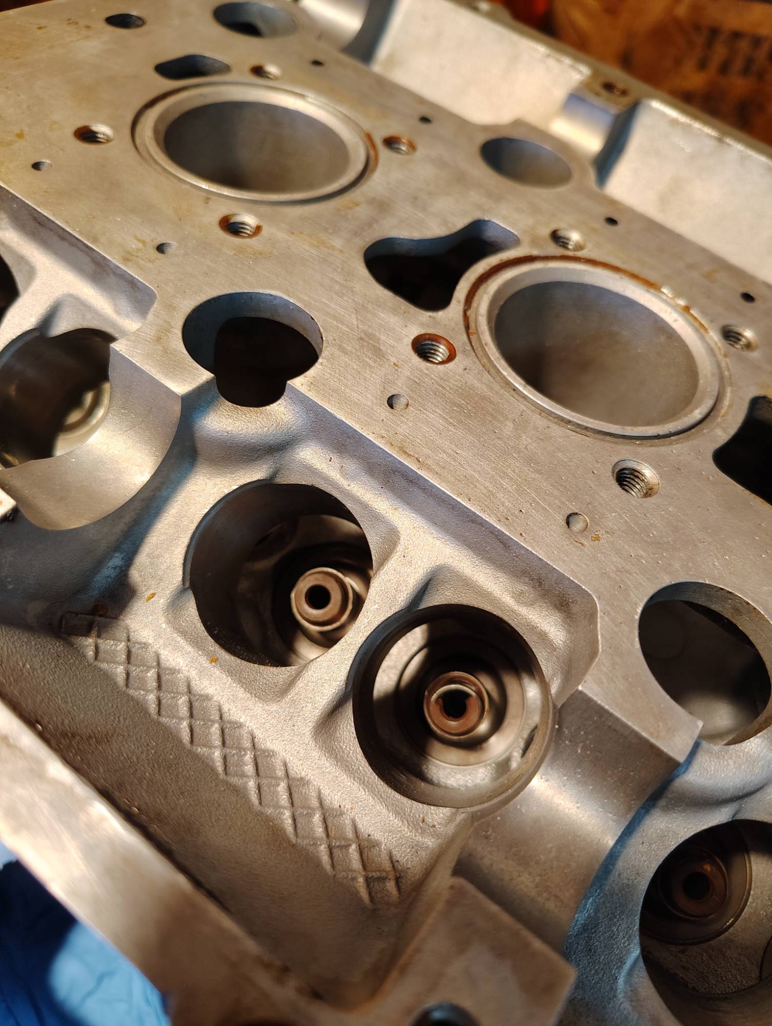

Went to remove the valve seals on the 850's head so I can lap the valves later this week, and found this broken seal on the intake side of the cylinder that burned a valve. Not exactly sure how that could happen except during install. Now I'm beginning to have some doubts about the shop that did the rebuild, since they also used a tube of anti-seize on the head bolts. I've been cleaning that stuff out of the holes in the block as well.

I’ve got some spare Elring valve stem seals I can send. Intake stem seals are less important since intakes don’t get hot and burn coke into the valves. Worst case you can replace one stem seal with the head in place without too much pain, doing all of them in situ is like going around with Mike Tyson
