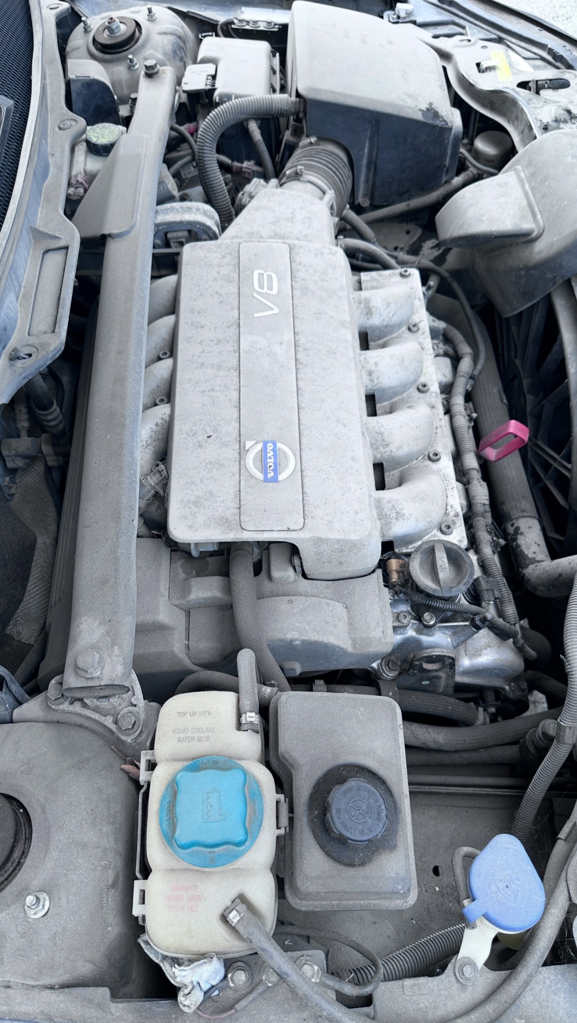

2005 XC90 V8
Need to wash this very clay-dusty engine bay.
No pressure washing, just with garden hose ‘rain’ setting, after spraying all with Simple Green.
What should I be watchful of, or a must cover, before washing?
Cheers

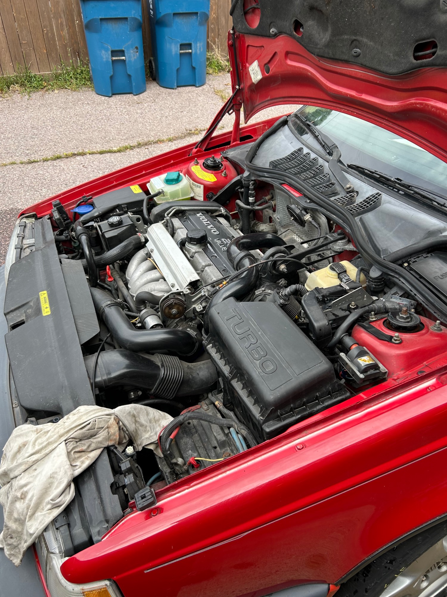

Agreed. I can’t tell you how many valuable timing belt stickers etc I have worn off with strong degreasers and spraying.
Lately I use a vinegar and Dawn soap mix in a spray bottle, a cloth and a toothbrush, and either just a dribble of water to rinse or a spray bottle with water.
Not a great job here - just got the worst of it…

A 2005 does not have a drain hole at the bearing end of the balance shaft. From prior research over 5 years ago when I was considering a V8, it was moisture that damaged the bearing. Around 2007 or so Volvo began drilling a hole from the factory. Lots of info online on this topic so before washing do some research.

.Oka wrote: 24 Aug 2025, 15:43 IMG_6586.jpeg
2005 XC90 V8
Cheers
Haven't used Simple Green for sometime. Label I believe use to say do not use on Aluminum as it will etch the surface. The entire intake I believe is Aluminum.

Hole dates and vehicle application are hit or miss IMO, can see here for a 2006 (16k SN) and a 2008 (32k SN), one has a hole and the other does not- viewtopic.php?p=591510#p591510 . Motors below SN 6833 were supposed to be an issue requiring recall level rework as far as I ever read.
Motor wash and the V8 is a concern you get water into the CB shaft "well" where the rear bearing is installed and it sits then rusts the bearing. If you choose to wet up the motor- do it warm, go easy on the front mid to top (belts, alternator) and don't dump a bunch of water right down the top rear (see where valley is located). Then take the vehicle out for a nice run afterwards and get the motor up to hot. When you park, leave the hood open and let everything dry completely. V8's a big motor and between that spot is part of the block. The idea of spraying the motor down with some Simple Green does not sound like a problem to me, just be a little careful where you're spraying and how much water you put down the top.
**For those wishing to scope out the V8 CB shaft rear bearing well themselves, location is articulated here- viewtopic.php?p=517385&hilit=valley#p517385 and the scopes are real cheap these days (phone based or standalone). You have to do a little bending and twisting to get the camera properly positioned but once you figure it out it's pretty easy to see.

My battery is in the rear. Surely, the alternator. Seems all the harnesses seem, or looks, sealed.johnleeh wrote: 25 Aug 2025, 04:01 Yes, it’s definitely a good idea to wash the engine bay,
but do it carefully. Make sure to cover the battery, alternator,
and sensitive wiring before using water.
Best to use a mild degreaser and a low-pressure spray for safe cleaning.
I would like my engine to looks as clean as yours.
Thanks for the info.
