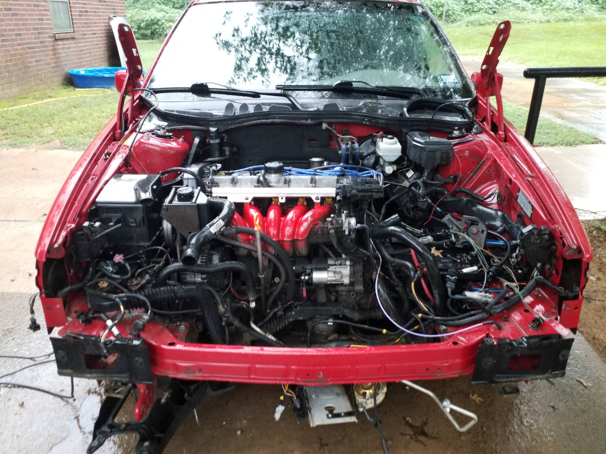

Update... See pics.
I have all the basics done for teardown. Plus I removed exhaust shield, a few exhaust nuts, the front and rear engine mount nuts, and trans linkage on top of trans.
Next step is to record the partial engine teardown + engine removal on Saturday. I found that one of the exhaust manifold nuts is blocked by the emissions warmup/evap thingy pipe right behind the cam cover. You will get to see how I go about getting that done. A grinder might be the solution.

Donrt destroy those SAS parts - they arent available anymore.
you can undo the union on the rear of the engine easily enough, and save the spaceship, the solenoid, and motor for the next guy
