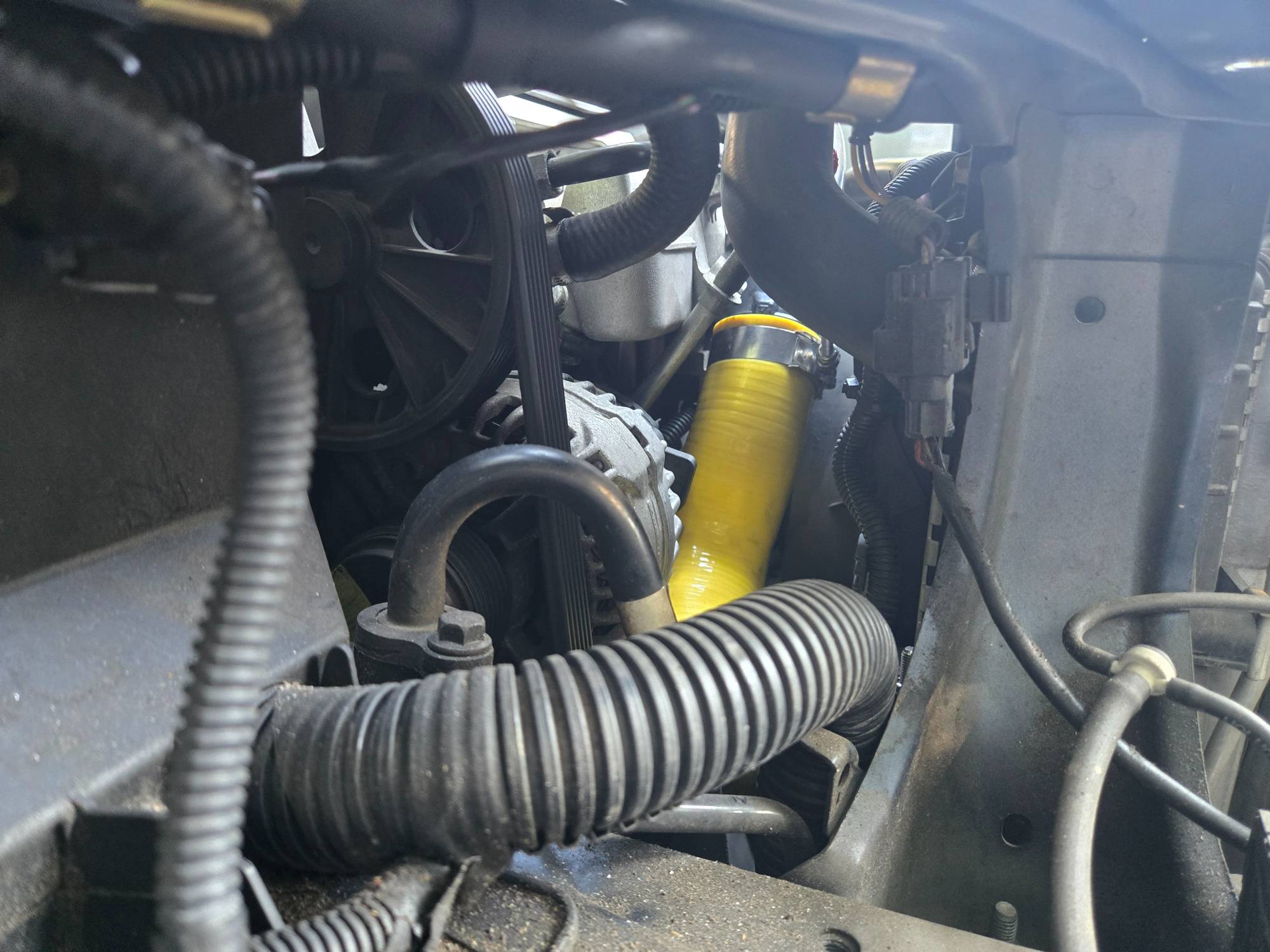

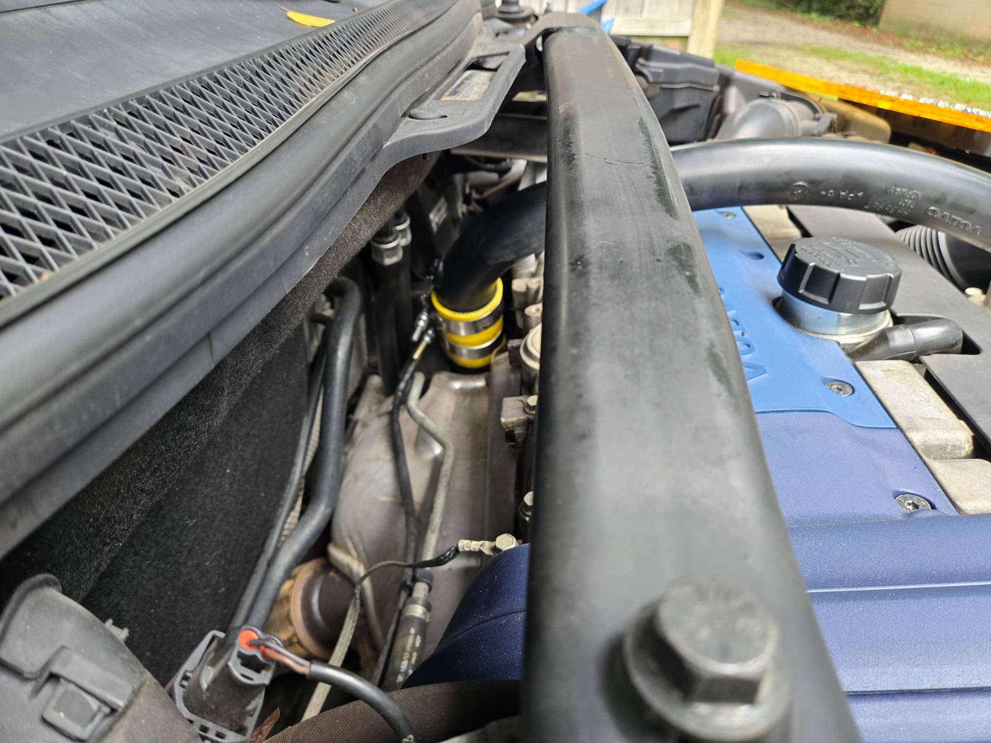

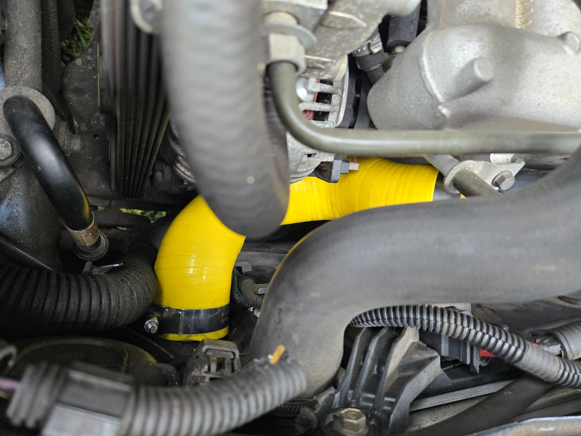

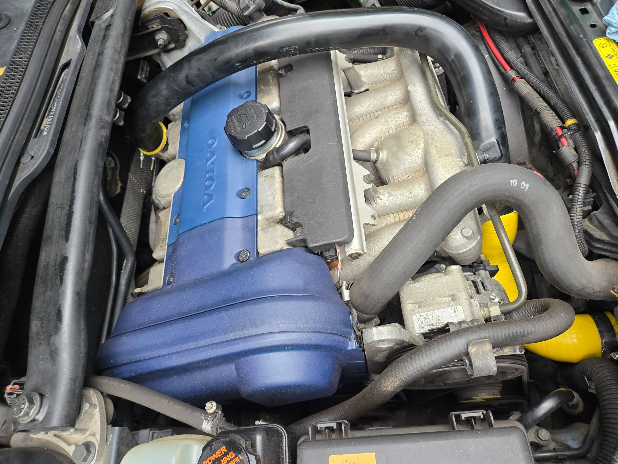

Ben finally got some TLC this week.
His hoses are mostly original and the turbo hoses were getting really gummy. I want to change all coolant hoses to yellow silicone hoses but I can't find them online. I think I'll buy straight hoses and shape them with springs so if anyone knows the dimensions offhand...let me know. They still look good but seeing "03" stamped on my radiator hoses is starting to stress me out.

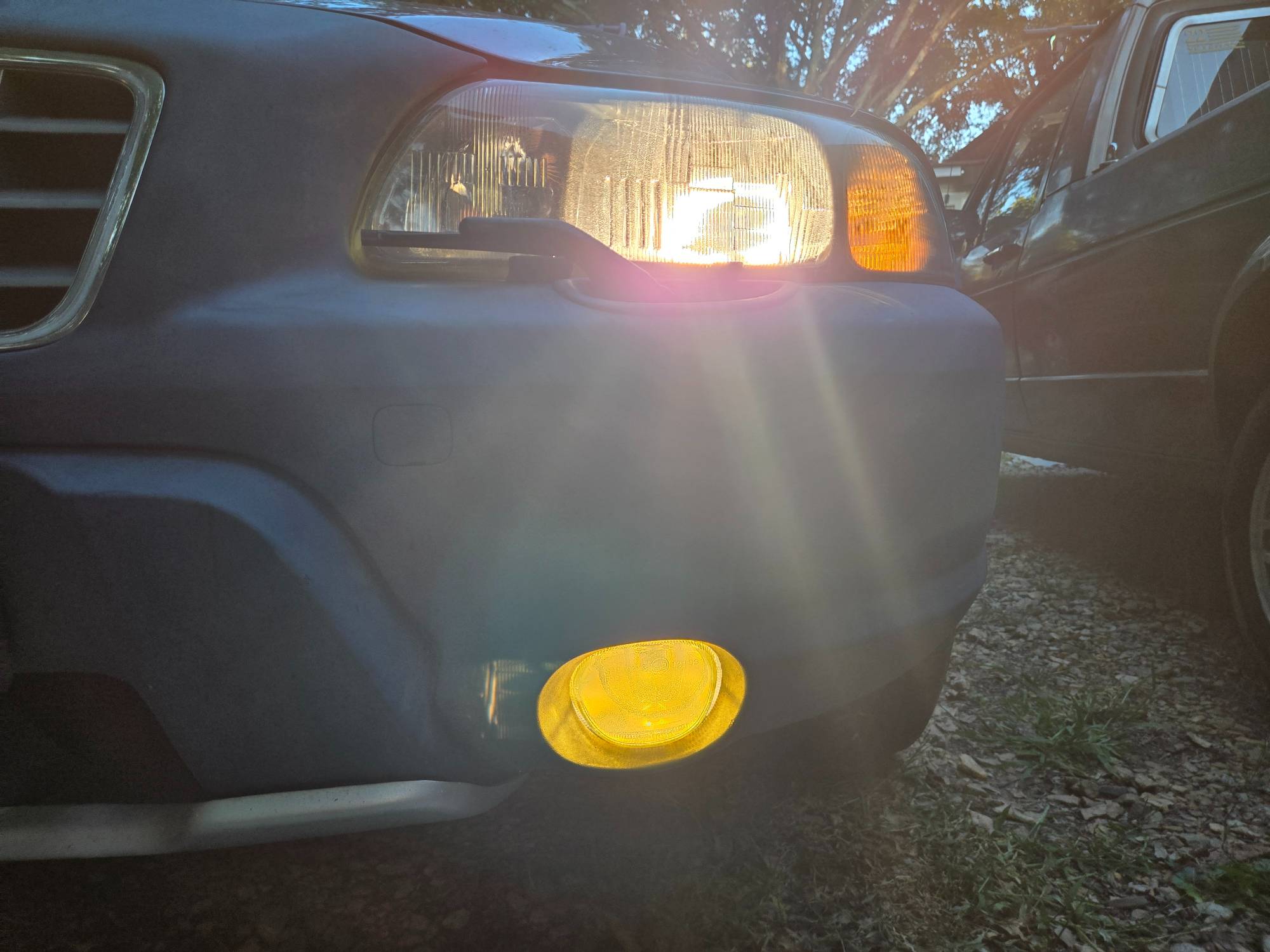

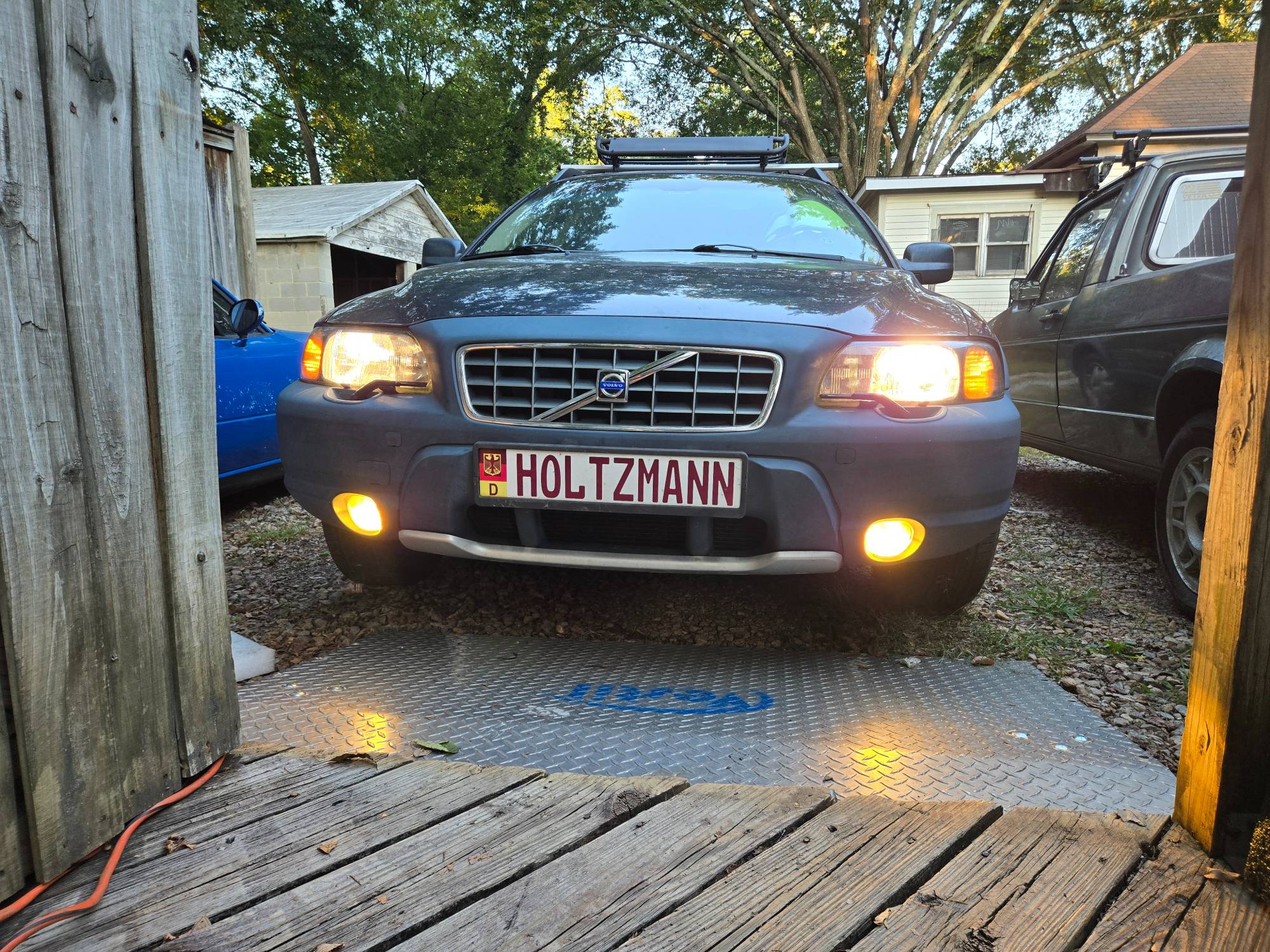

I've been meaning to install yellow light film I got in a trade on any car for about a decade now and I finally did it!

Starbuck wrote: 12 Sep 2025, 20:00 Ben finally got some TLC this week.
Silicone hose is great for long life, BUT silicone is slippery. Be sure your hose clamps are tight. If they can't be kept in place with high boost, use double clamps. We learned this with industrial turbo diesel engines.
