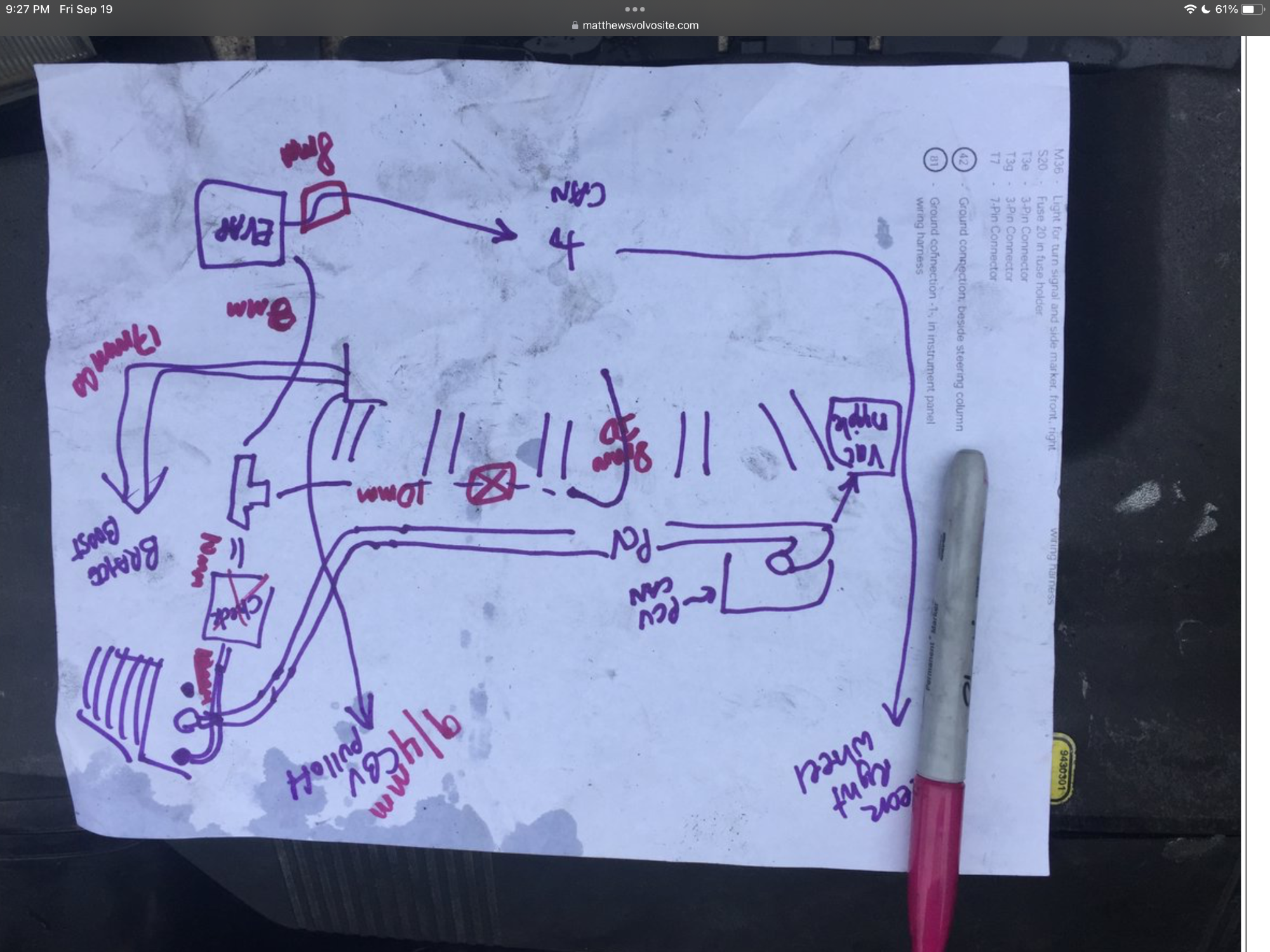

- Posts: 36147
Here’s the 1999 hose sizes
