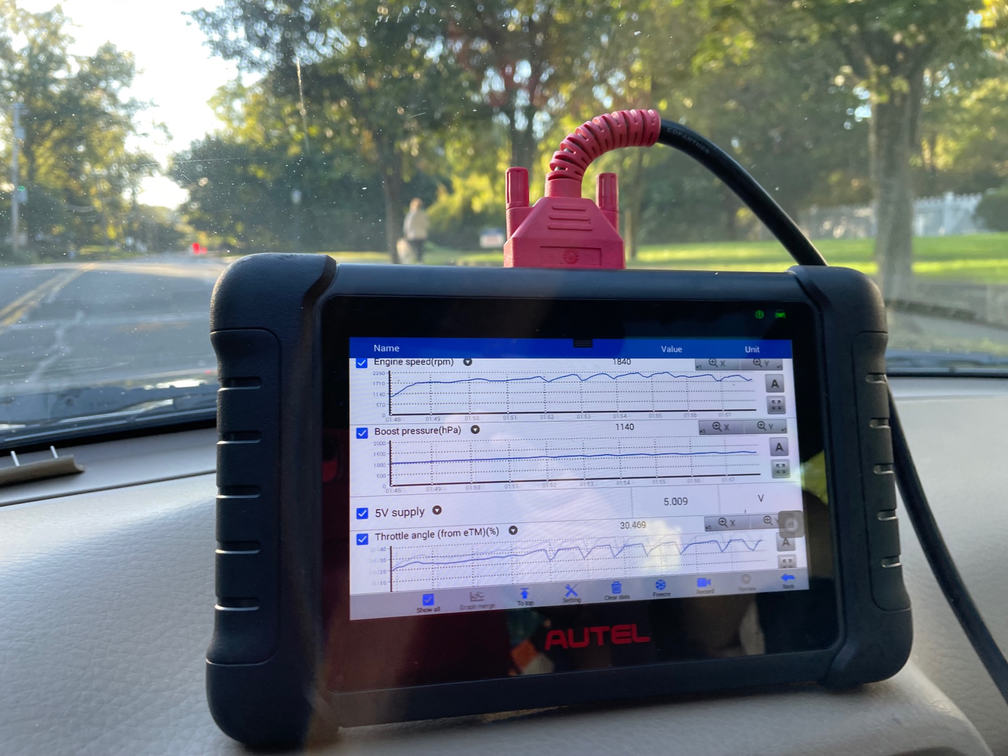

Got some data.
Throttle position is showing glitches and throttle body error codes.
I’m not sure she is boosting well , photo of data on a pull
