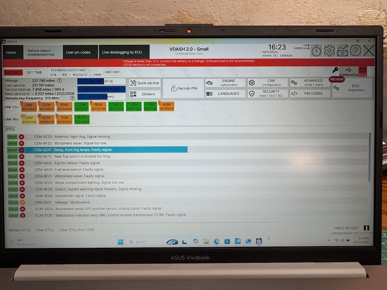

Scanned with VDASH, and here's what I get:
So, I'm afraid that I may have fried a bunch of sensors, and maybe even damaged the ECU or TCM.

See above. You need a solid 12.5 v to diagnose stuff on an electronic car.
Your charger won’t push 50 Amps unless you are cranking so I doubt that did any damage. The only code relevant here is that immobilizercode, that will cause a no start

Are you getting any warning messages in the info message center on the LHS of the cluster? Any mention of the immobilizer or key problems there?
The battery may turn the engine over, but when I over charged my battery (charger went rogue) it was toast internally as it have warped the plates. I got 12+V but not the CCA needed. If you can take it to a parts store that has a battery checker get them to do a full check. That will then eliminate or confirm the battery from the issue.
The other issue is damage to the alternator and the voltage regulator.
The real help here would be access to Vida to be able to check the various modules to see what is not talking to the car.
