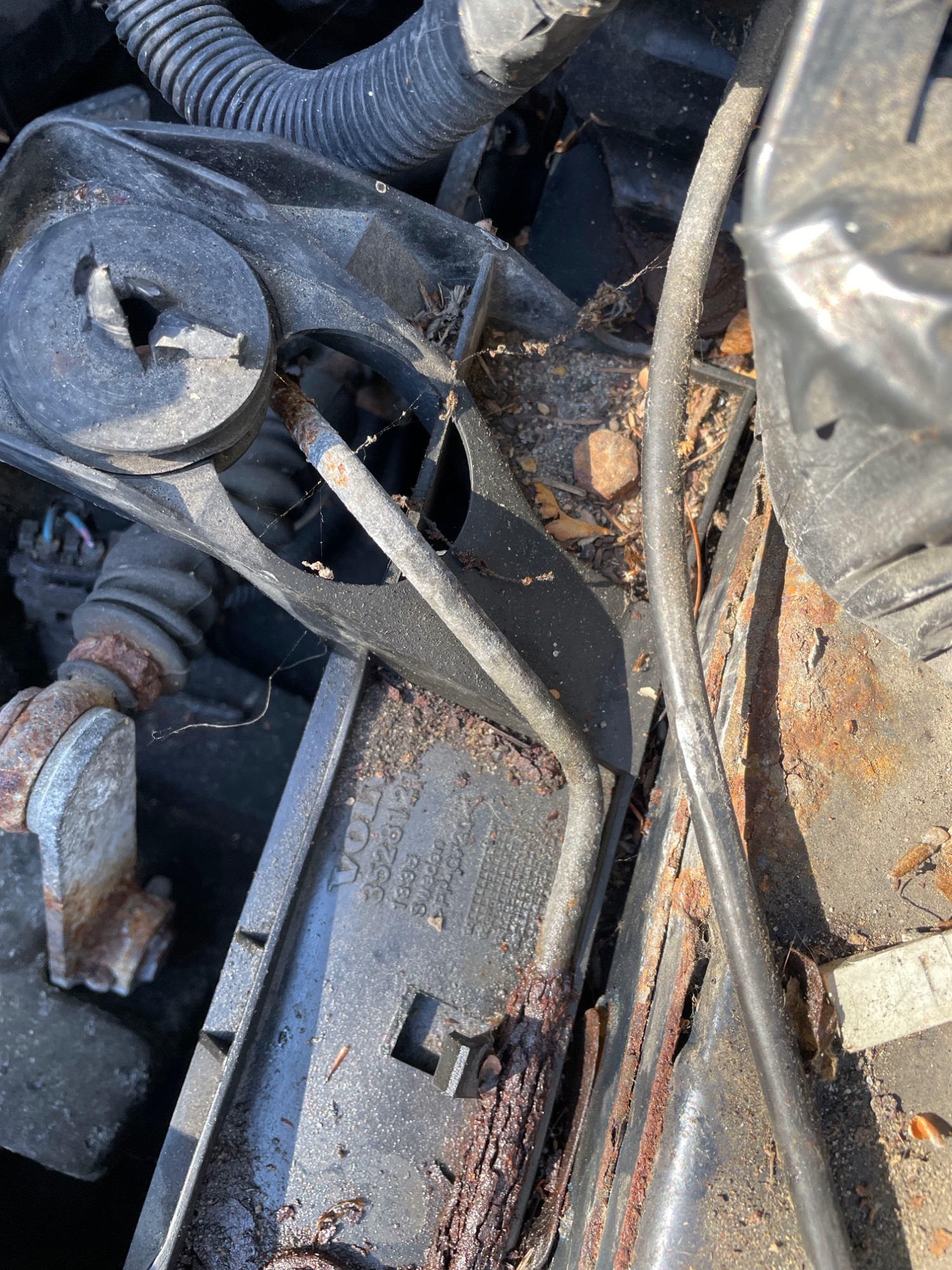

The ugly - rusted out clutch line. The M8 bolts holding in the air cleaner and battery tray were nasty too.
You have to feed the clutch line through the air filter tray, so take a pic of the puzzle

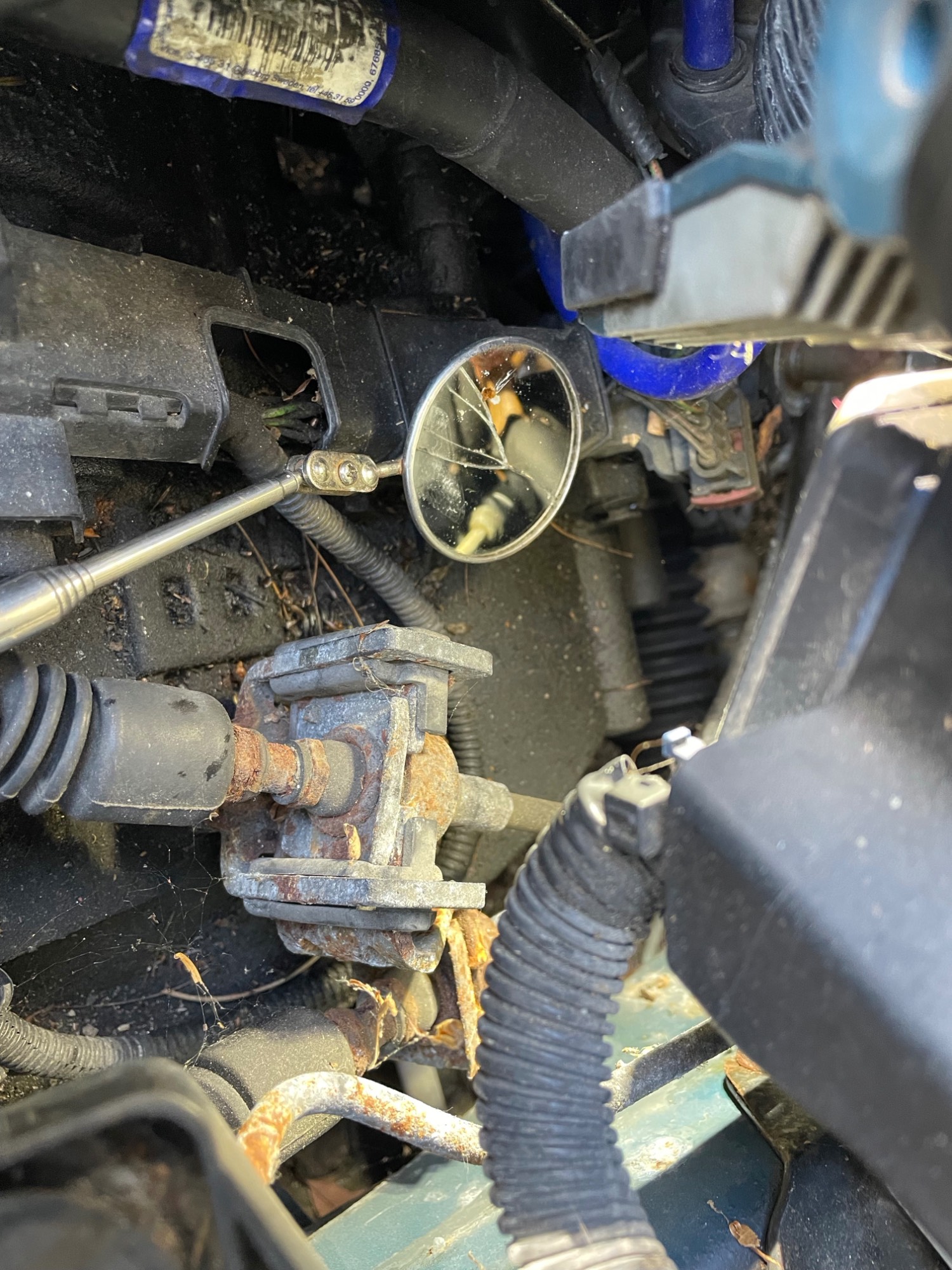

You can just see the clip in the mirror buried under the booster and fuse boxes, If yoiur spatials are good you can get that with a pick but they do rust in place....in which case...

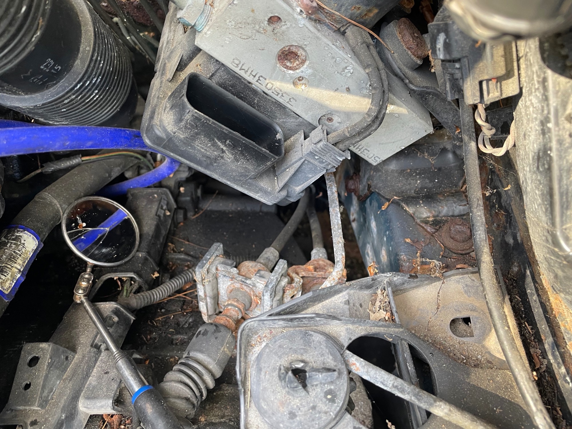

Another shot of the air filter box and clutch line - take a pic here first!!
Easy way - take your E5 and remove the ABS module
Now you have both line of sight and room for your hand and a pic and the clip pops out, and you dont lose it.
The clips look like this  - my clip to the first stop on the black plastic adapter was so rusted in I never got it off, so I cut the old clutch hard line so that I could ....

Two tricks
1. You have to release the clips by removing them fully to remove brake line from the clutch master cylinder, the 135 degree angle fitting/bleed valve, and the pipe to the slave cylinder
2 the master cylinder one can be done by mirror if your spatial relations are good, the easy way is to remove the ABS control module , then you get line of site. Clips can generally be reused, I had one rusty one. Part number above. You need three if replacing
