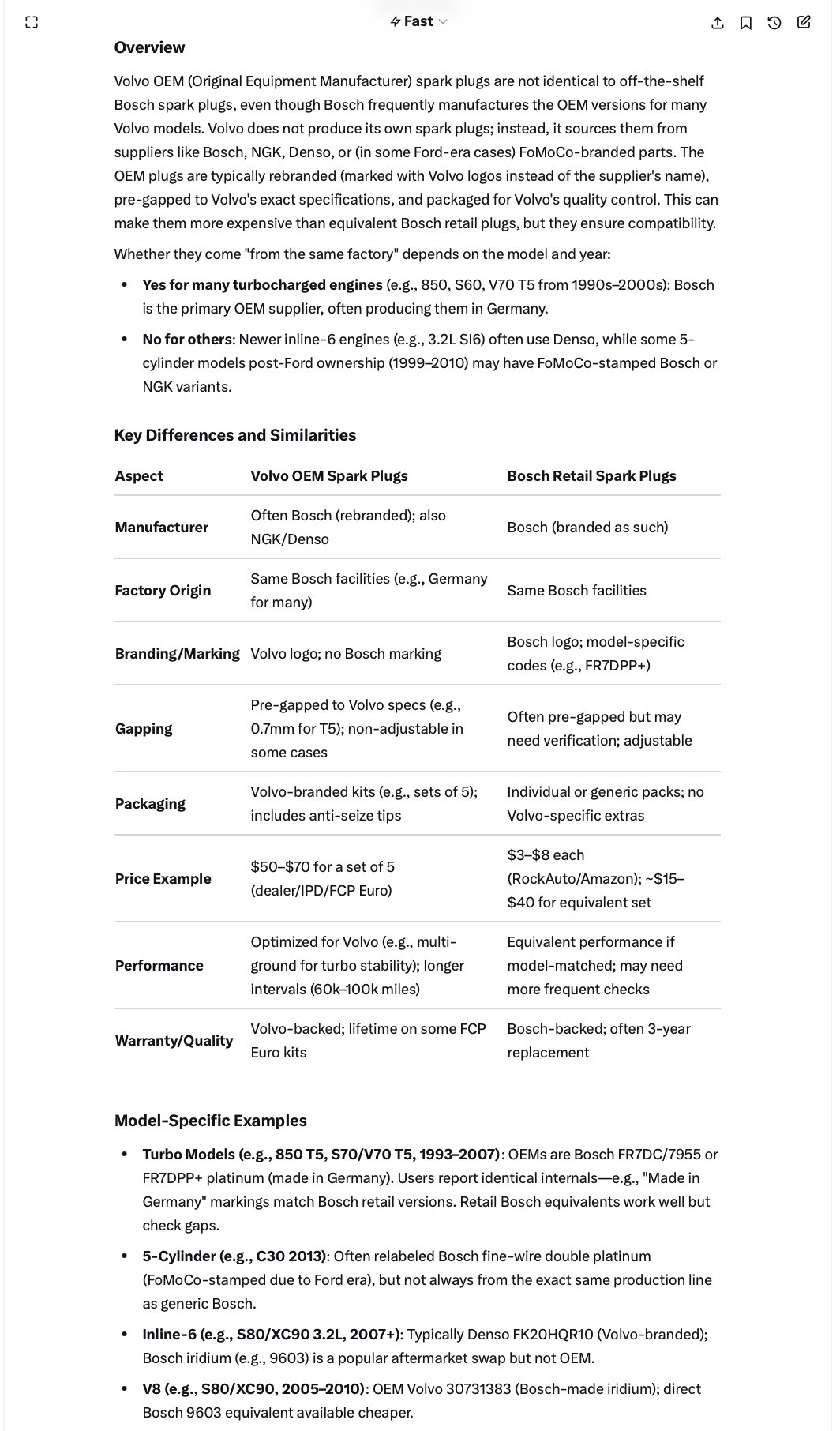

$89!? W the F. It's a bit of ceramic and metal that industry has been producing for over a century. No moving parts, no computer chips, no space lasers, nothing remotely exotic.
I use a tiny dab of anti seize, yes.
source https://x.com/i/grok/share/2UJdX4b6HzeypShxb87rmhsx4
