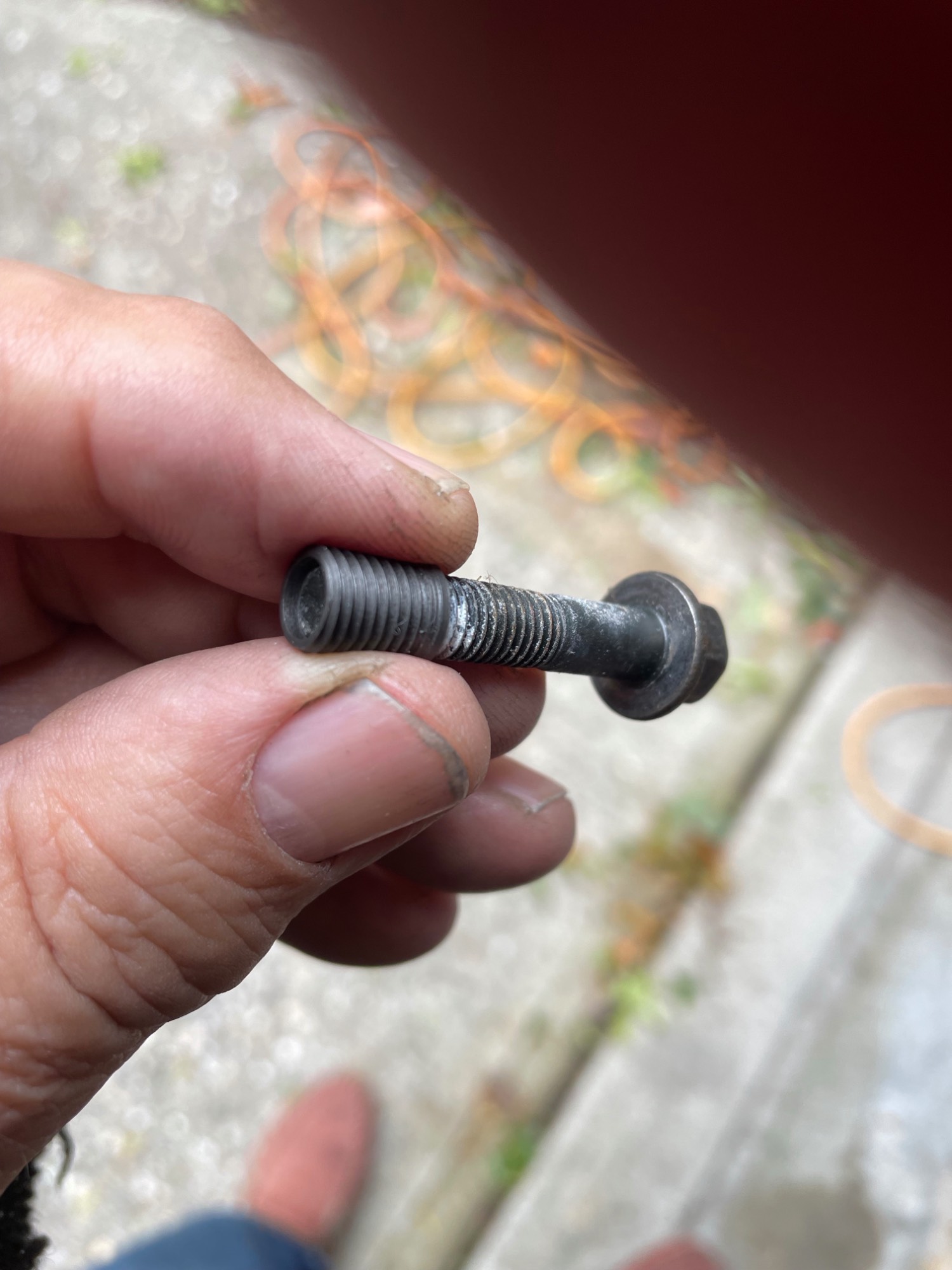

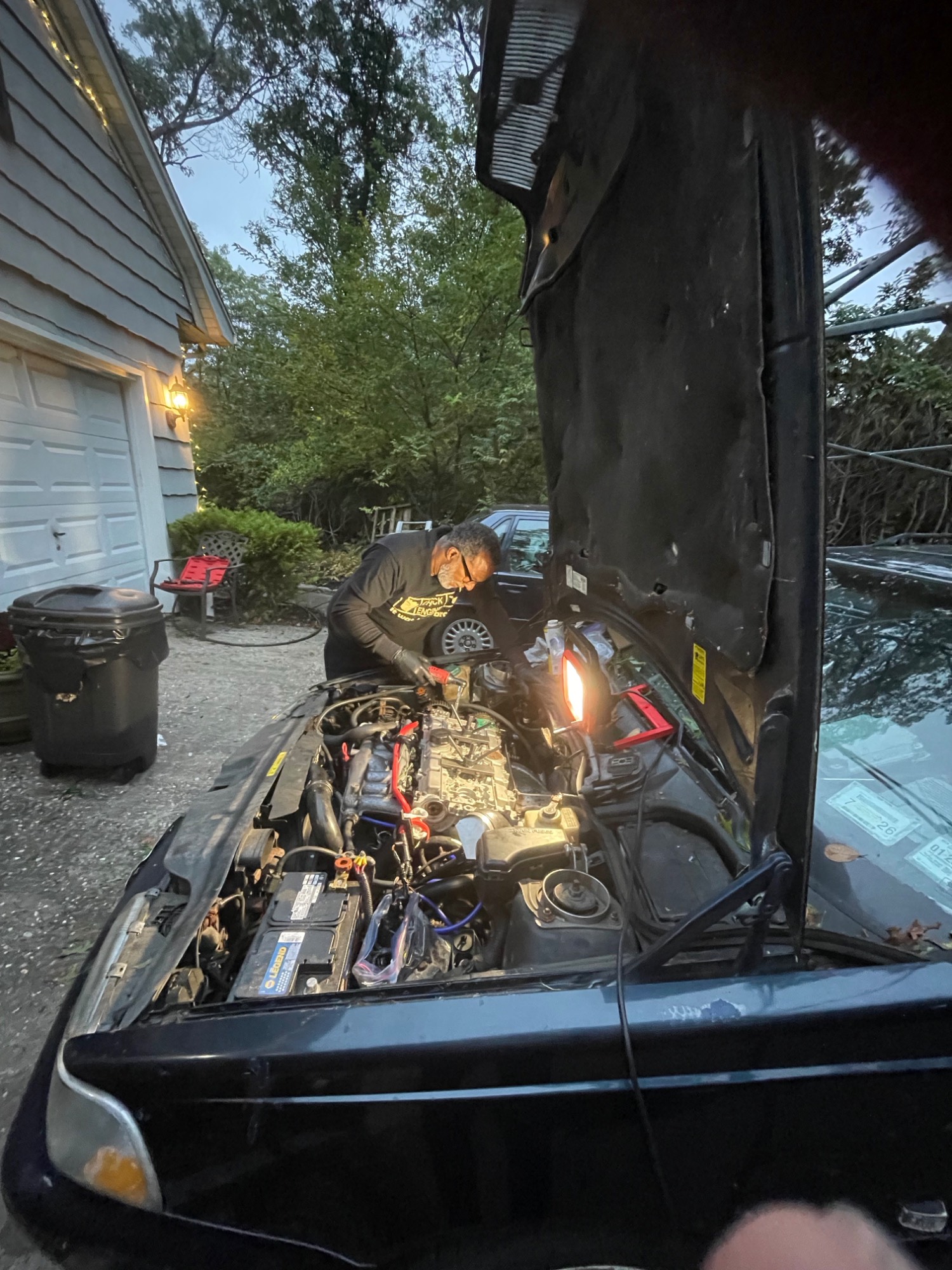

Very hard starting, crank no fire
Cam sensor code, oil leak from cam cover bolt making a mess.
Coding P0343 and P0014 , need to get timing set
Swapped in UBG cam sensor DENSO still codes
16JAN2025 NYSI passed at 261xxx

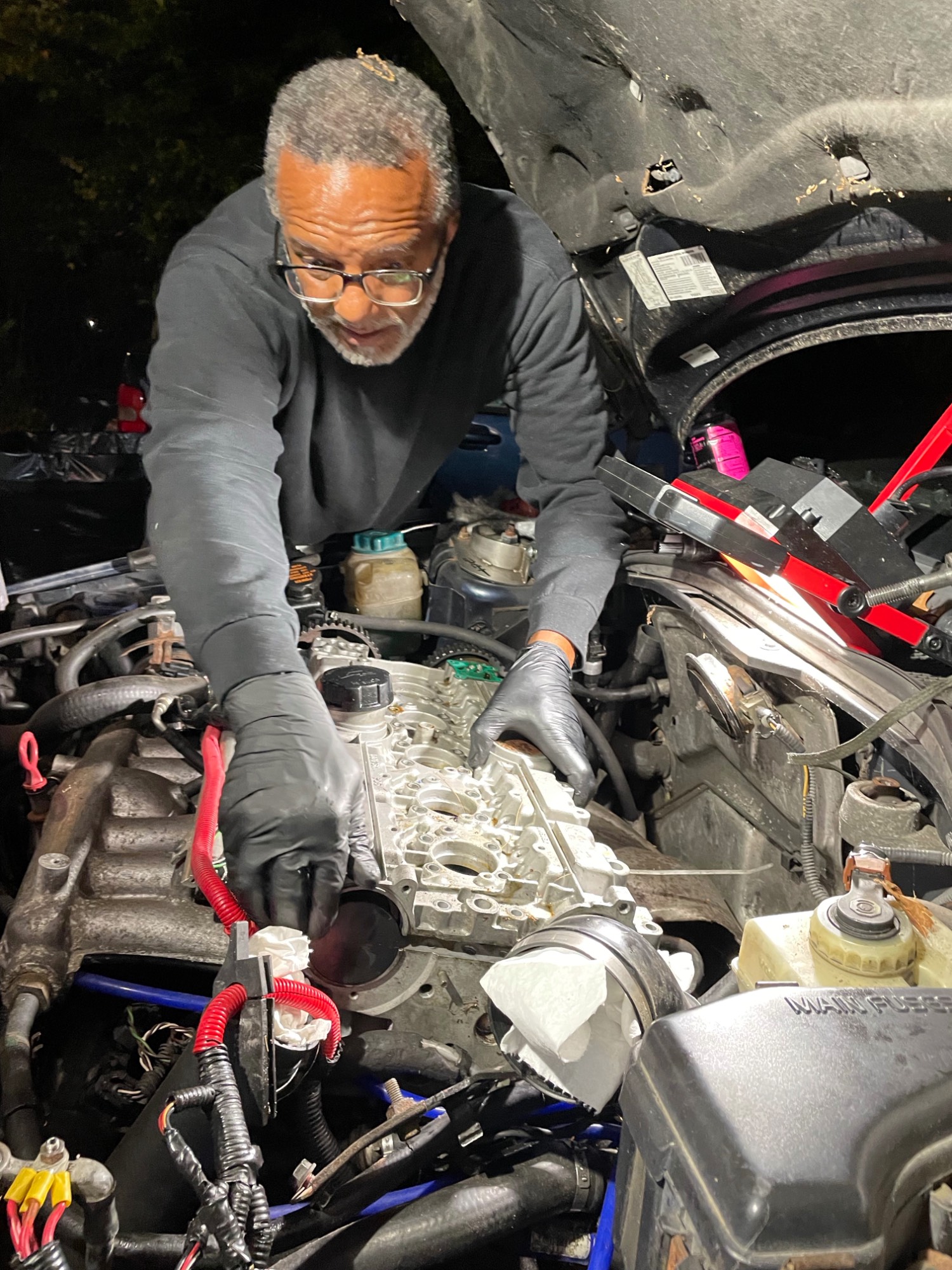

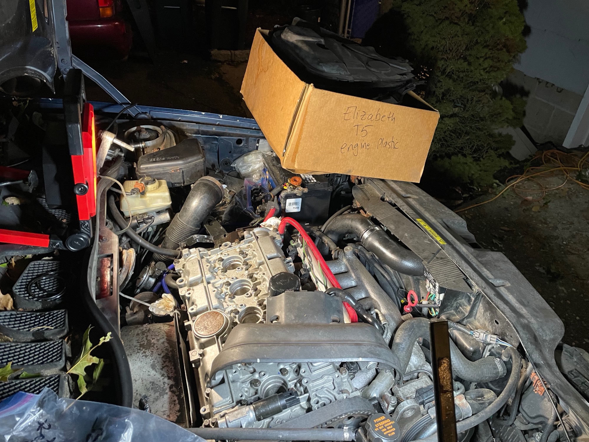

Too much work so I called in the pro help. Running with the Spinner, he put in 6 Timeserts and reglued my head back on Elizabeth.
Great to get her back on the road.
