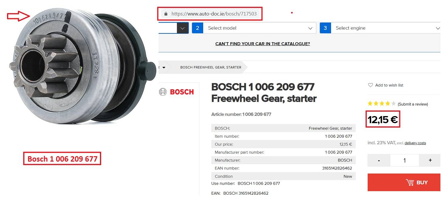

I just looked at the Bosch starter motor for P80, P2 (up to 2006 or so), Bosch SR0483X...
- The Bosch starter Bendix PN is 1 006 209 677.
- It is the common type with 9 teeth.
- In Europe, it is about 12-15 Euros or so.
- If anyone finds this in the US or Canada, please post.
PS: I think around 2007, the starter is probably similar with the only difference being the spade terminal
(spade terminal used until 2006 and maybe some 2007 starter???). The 2007 and later starter uses
eyelet terminal that you need to use a nut to hold it in place. Otherwise, the 1994-2006 starter looks
similar to 2007--->.
