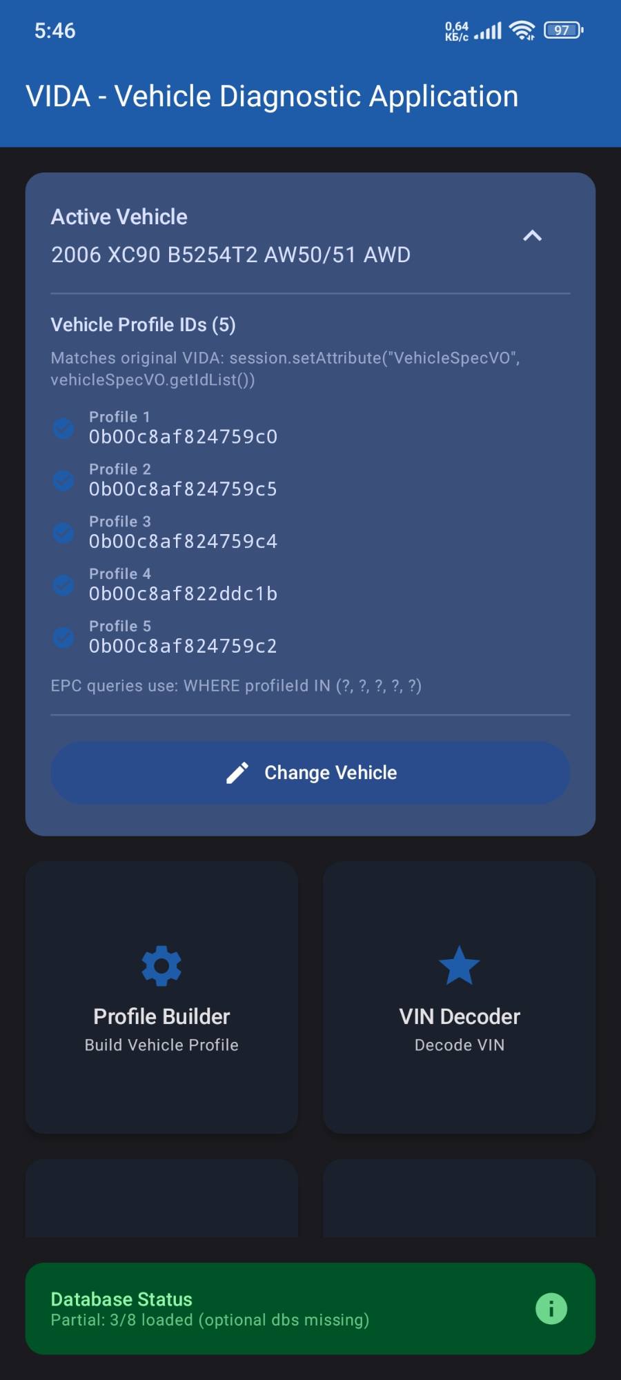

There is also no way to edit the profile, the edit profile button does not work, and the vin decoder does not workdikidera wrote: 14 Dec 2025, 13:56 What vehicle profile did you select? Also go in App Logs and see if anything was written there.

Thanks for this, I will begin investigating now, because I personally didnt get these issues with my own profile. For sure there is some error in the logic. The profile builder will work though.

Please test this new version. It should have fixed the issues, but most importantly, verify when the parts catalog loads that its data is 1:1 with the real vida. What is weird in your screenshot is that the vehicle shows 5 profiles, but on my android-vida I only get 3. What region is that?

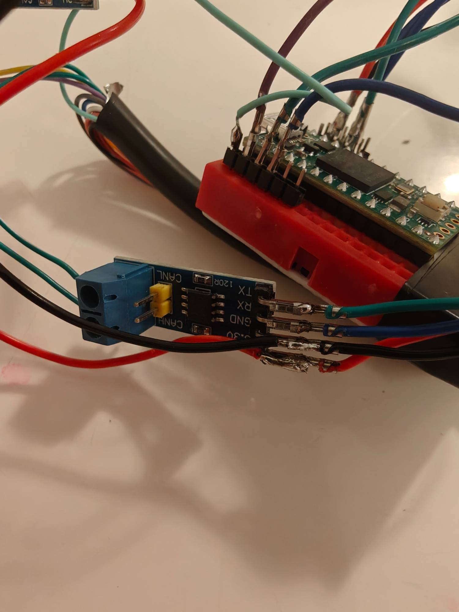

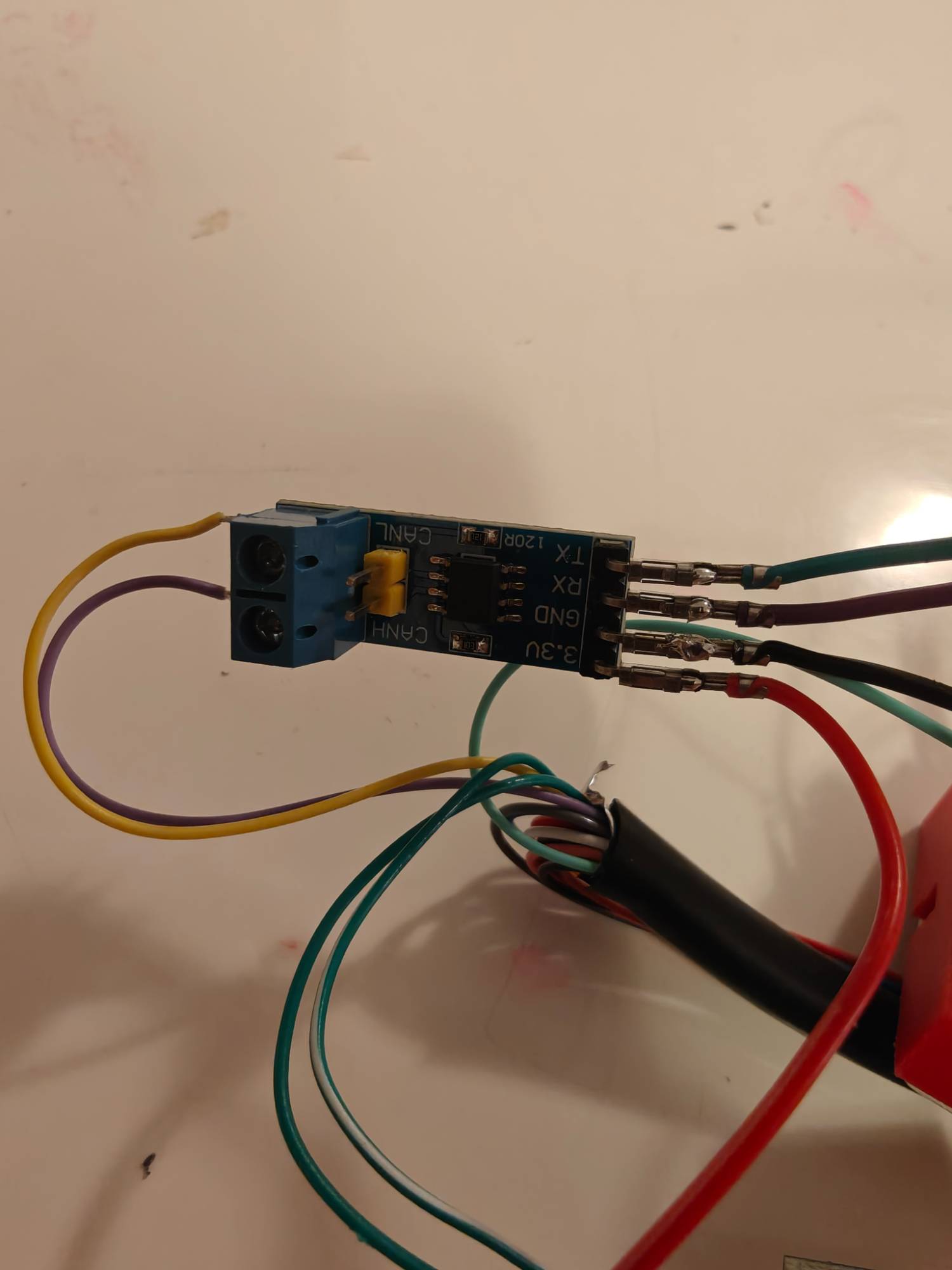

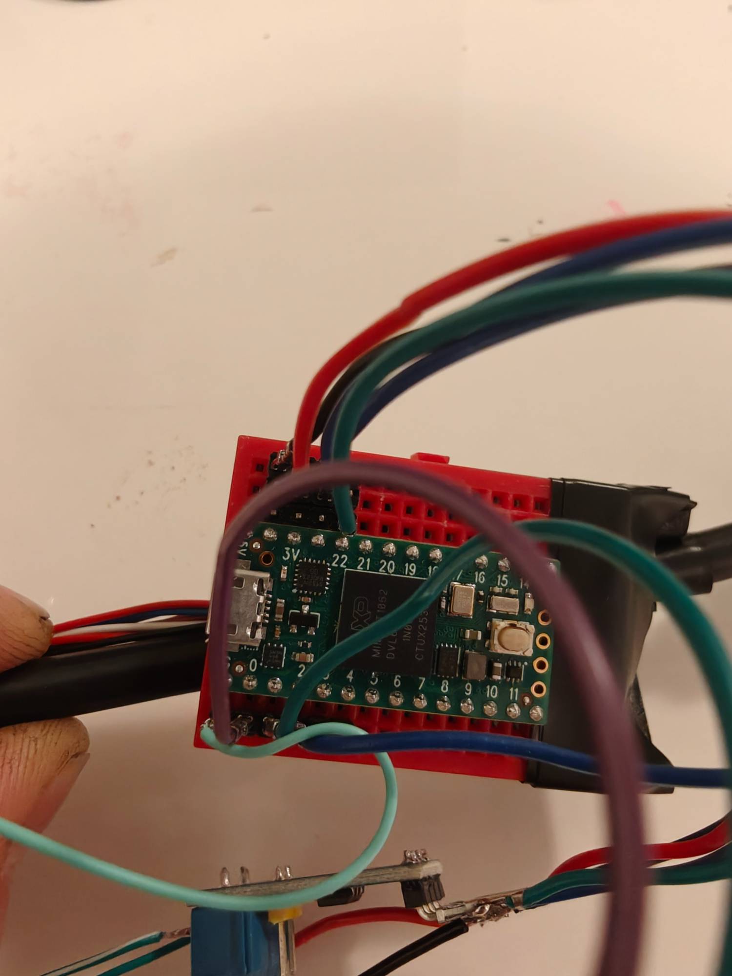

Try to remove this line: https://github.com/vtl/volvo-cem-cracke ... .ino#L1322 (and similar line in one_pass branch, try it there, too). Also show a good picture of your hardware?S40cem wrote: 19 Dec 2025, 08:05 Thank you very much for your reply.
