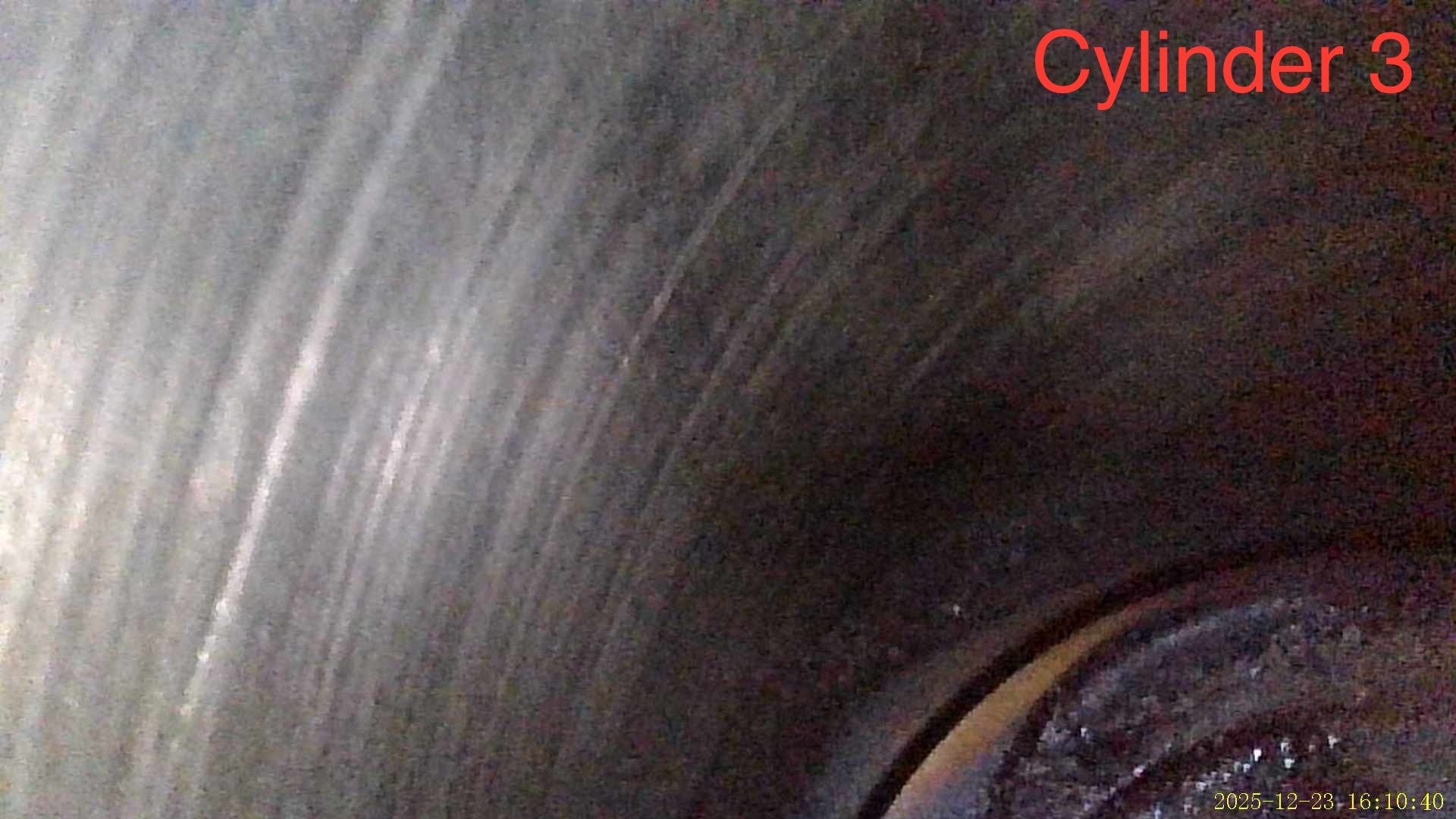

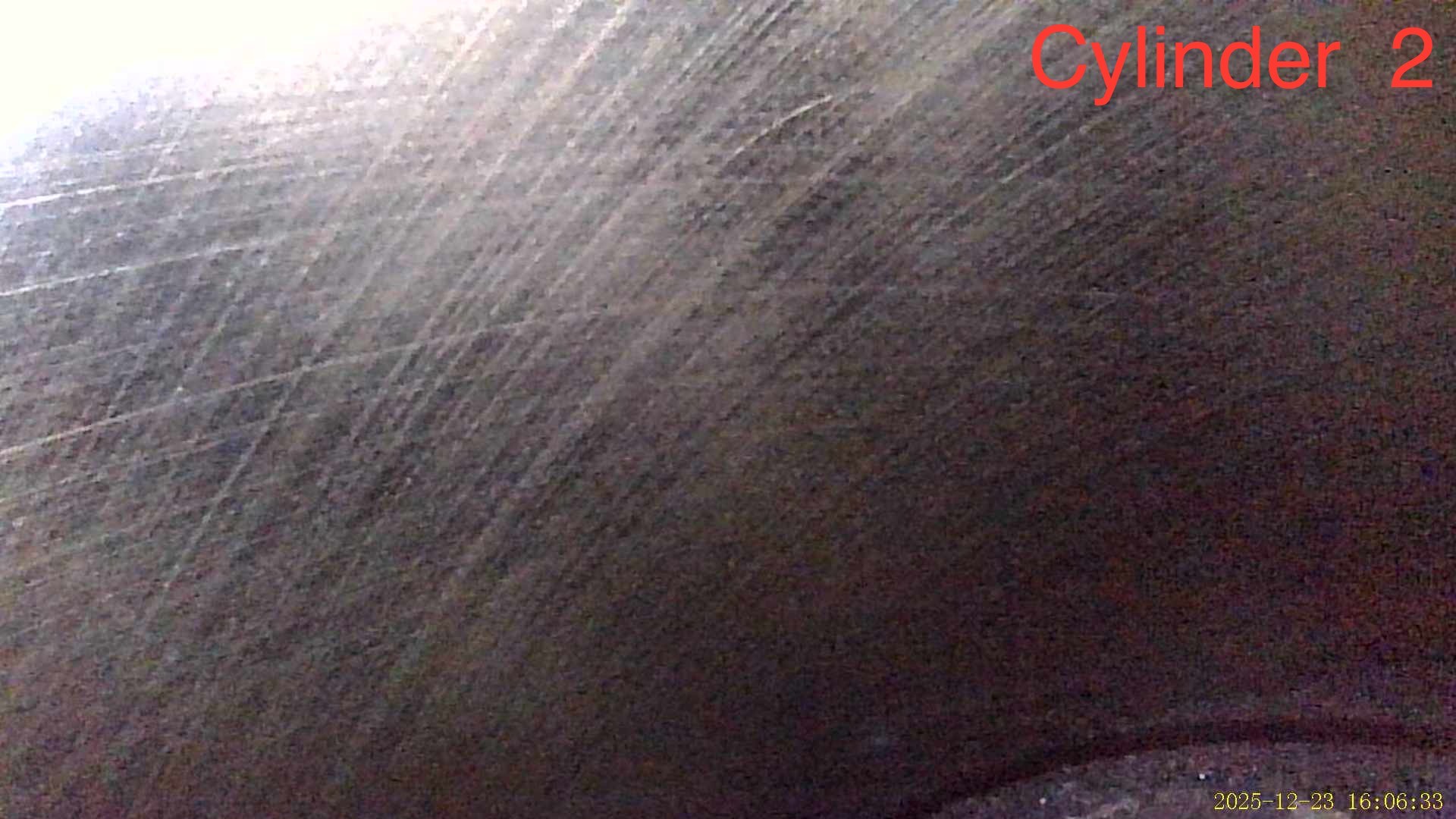

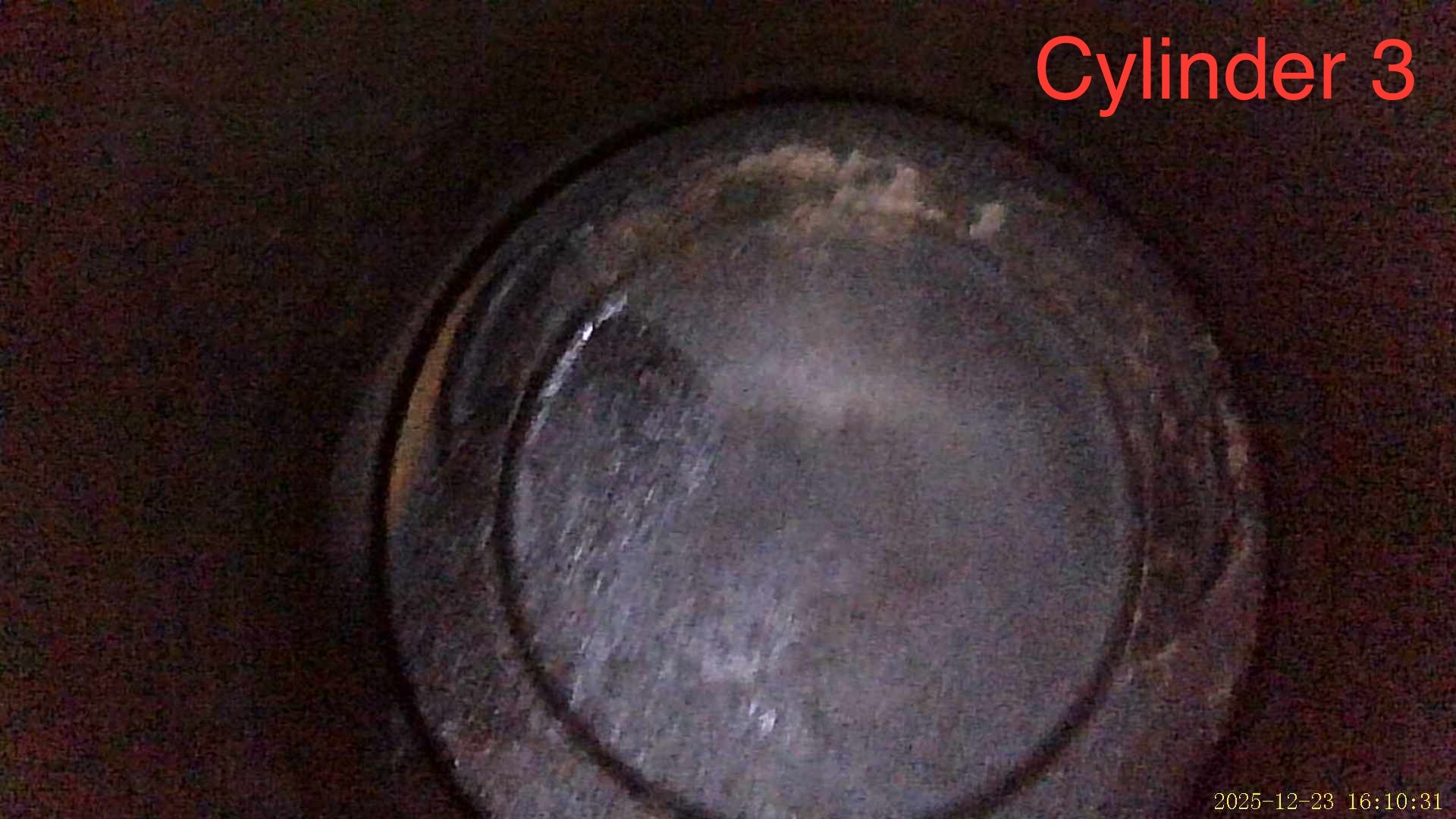

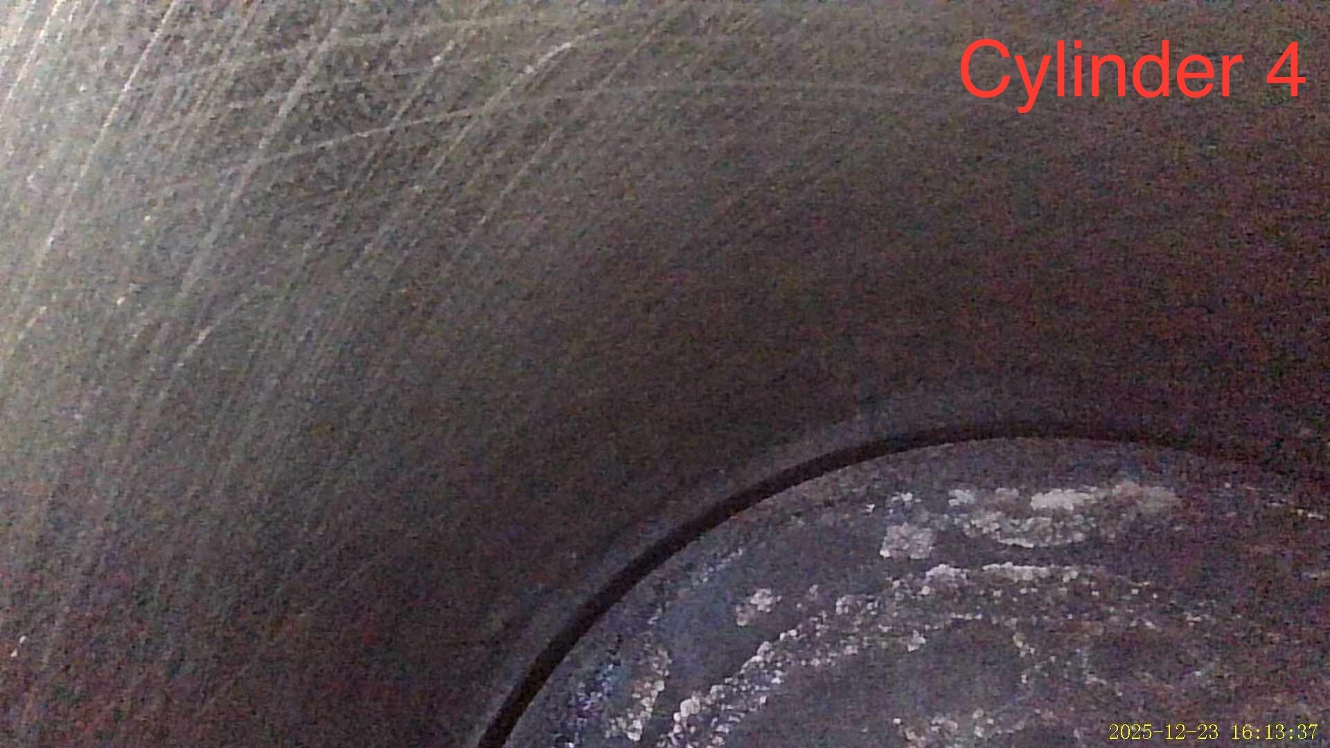

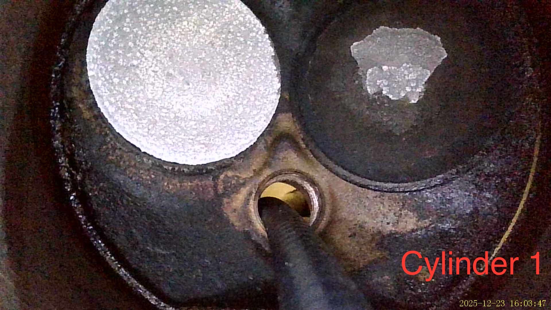

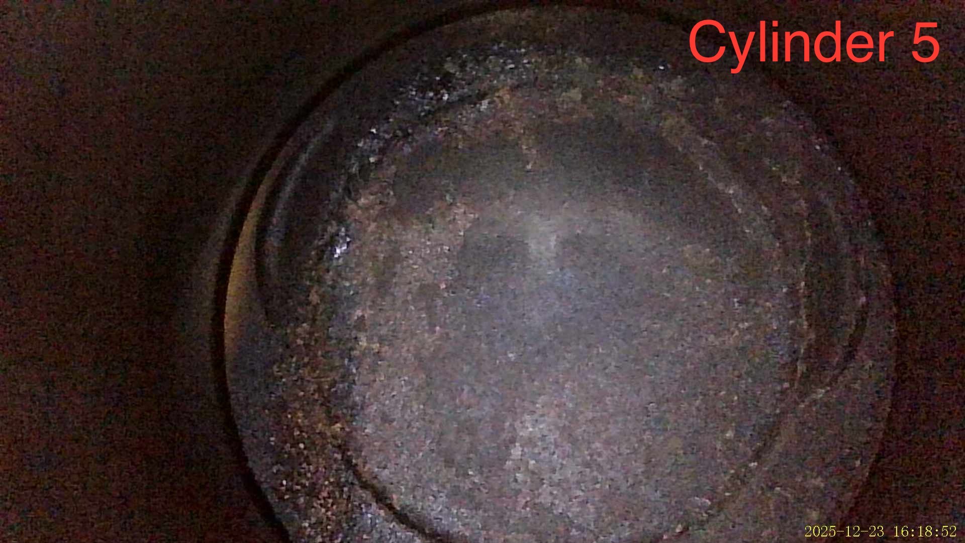

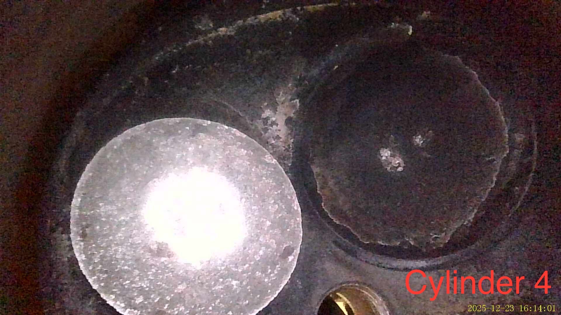

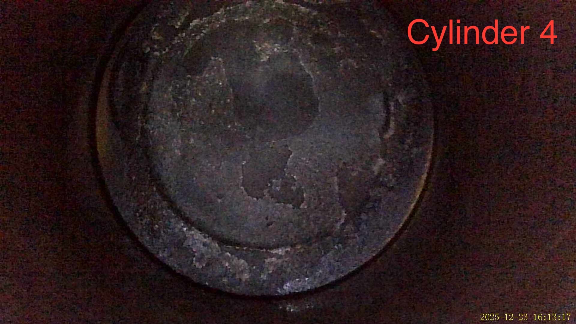

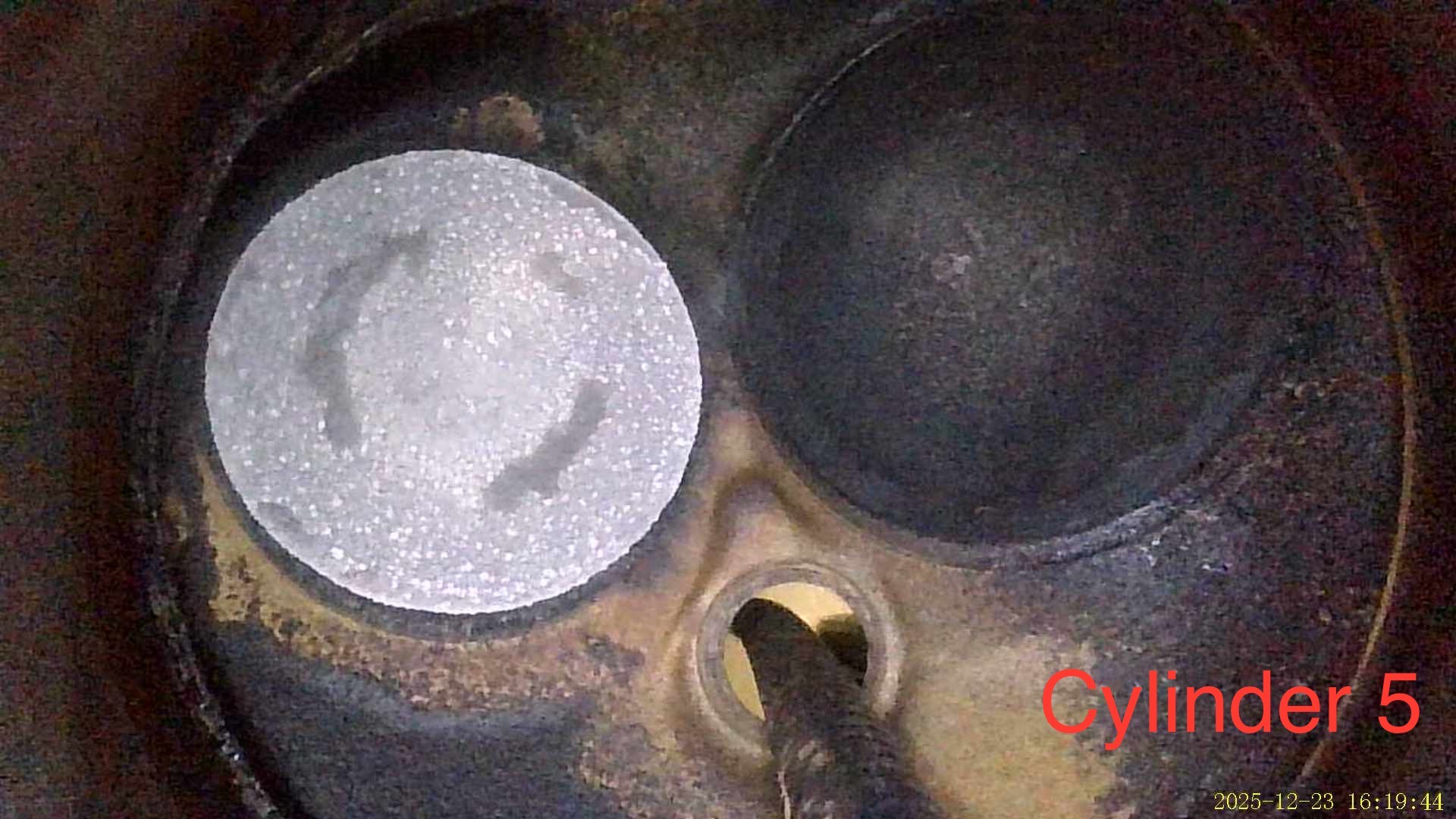

Bought a budget boroscope to check the cylinders out.
The car burns oil, especially at stop lights and long idle.
Compression is evenly across all cylinders. I don’t have a compressor to perform a leak test.
Any guesses on the pictures if a valve stem seal job is enough?
The car has 450k km currently. I drive less that 7500km a year.
How are my cylinders looking?

Those cylinders look beautiful. New seals and you should be good to go.

Yes, good cross hatch honing pattern.

Agree as well. As already mentioned, new valve stem seals are needed.
