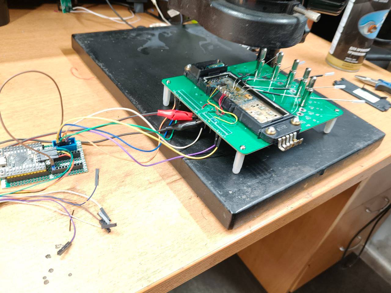

Rereading this topic, I came across a message from dikidera on restoring the ETM Magneti Marelli bootloader. I also restored ETM, but I used a tool to repair SD cards. It is convenient to aim the needles under the microscope.dikidera wrote: 18 Jan 2025, 02:23 Considering I am also working on an MC683XX chip, I used this Arduino library https://github.com/psobot/arduino-coldfire-bdm
It won't work out of the box as it uses Python 3.6 features which have been disabled in Python 3.7 and onwards, specifically nullcontext from contextlib package. However the code itself is useable.
The 28f400 is a standard memory chip, has nothing to do with K-line or whatever. The only caveat with the 28X, 29X chips is that they do not use any sort of serial communication but each data and address pin needs to be connected for a total of 32(maybe 33) pins, which is why BDM helps here. I have been crazy enough to solder 32 pins however and successfully read a 29LV200BC chip off a Denso board with an Arduino.
You are lucky to have such easy access to those chips.
I on the other hand have to be creative
