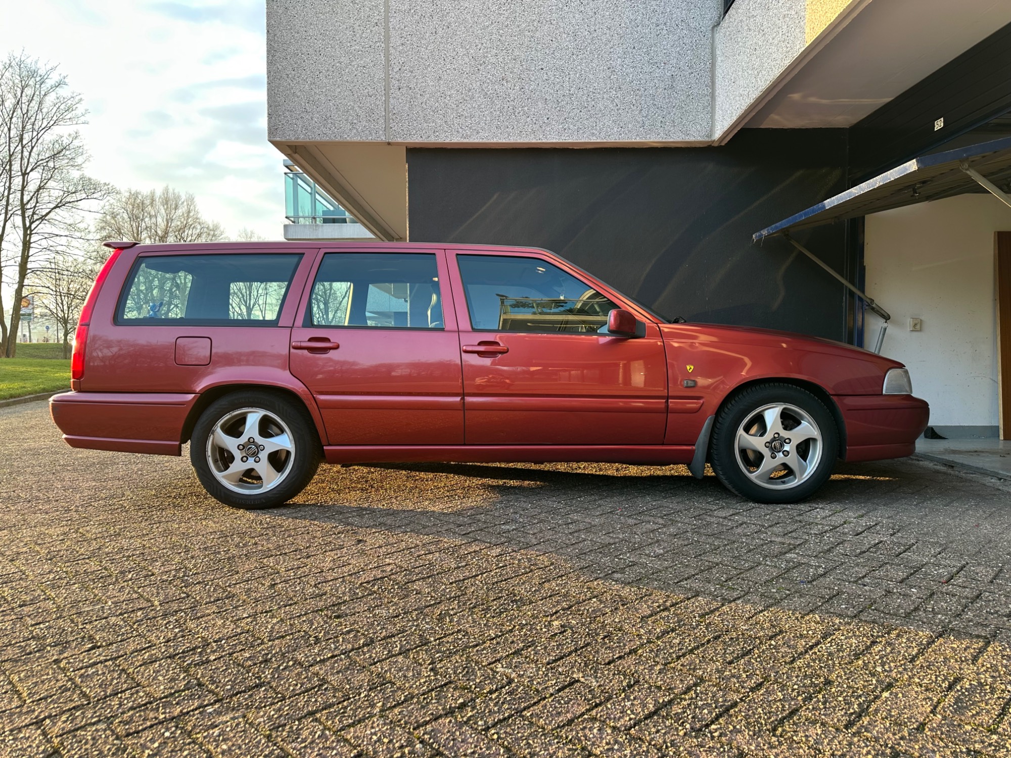

scot850 wrote: 17 Jan 2026, 08:25 Nice looking set of rims and tires! Yes, the rims do like to get really crusty after many years. Most of mine have ben powder coated over the years to keep them fresh and easier to clean.
That’s a great idea!
Not sure if the old set is worth it to fix it up.
It’ll need to be stripped, turned, coated and trued.
Just put the new set on. Here and there some paint chips and curb rash, but it’s not oxidised as the old wheels.
For the budget they’ll do more than fine.

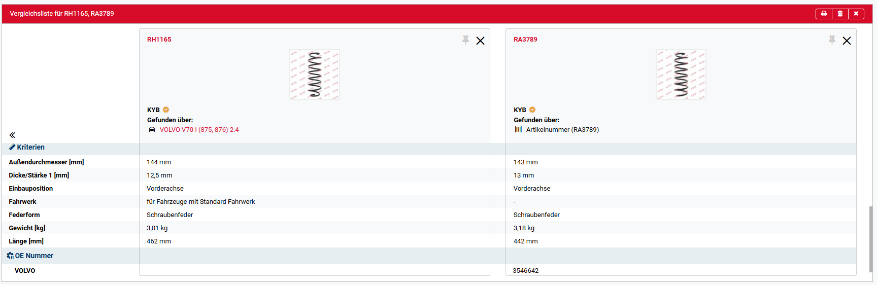

Chieber wrote: 18 Jan 2026, 04:10 C70 front springs should fit on a v70 right?
Your kyb springs shows up as c70 springs.
According the specifications there’s some difference in height and outer diameter between the kyb spring you have now and the kyb spring that shows up online for a v70.
Now this is where things get's odd. Searching for the part number that VIDA gives me, I get the RA3789.
Screenshot 2026-01-17 190110.png (71.39 KiB) Viewed 279 times

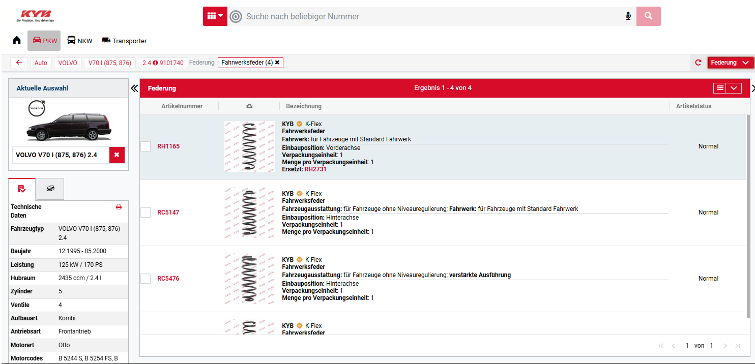

However searching for my car in the KYB katalogue, a different spring is listed:
And the RH1165 does not have any part numbers attached:
One way or another, I bought two Eibach R10753 springs yesterday. :D

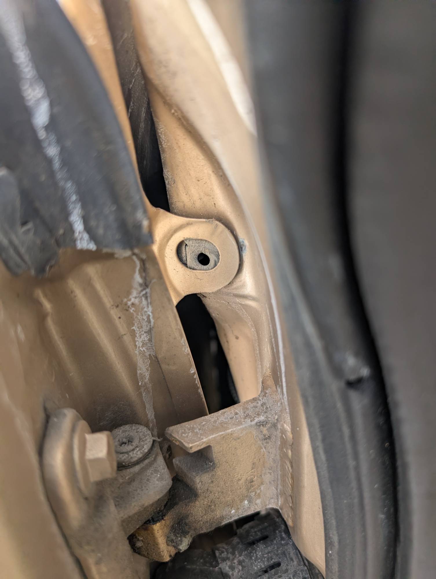

After church I filled up with gas and topped off the wiper fluid. The light has been flashing every time I take off for a few days now. I just haven't done anything about it until now because of the cold.
Also, I'm tired of seeing this bolt missing. Anybody know the size or part number?

454cid wrote: 18 Jan 2026, 12:17 After church I filled up with gas and topped off the wiper fluid. The light has been flashing every time I take off for a few days now. I just haven't done anything about it until now because of the cold.
Try swiping one of the 10mm head bolts from the top of the fender, hood up, and see if it fits. I can send you a spare in Nautic blue. Those bolts also fit the air guide hold tabs down under the engine

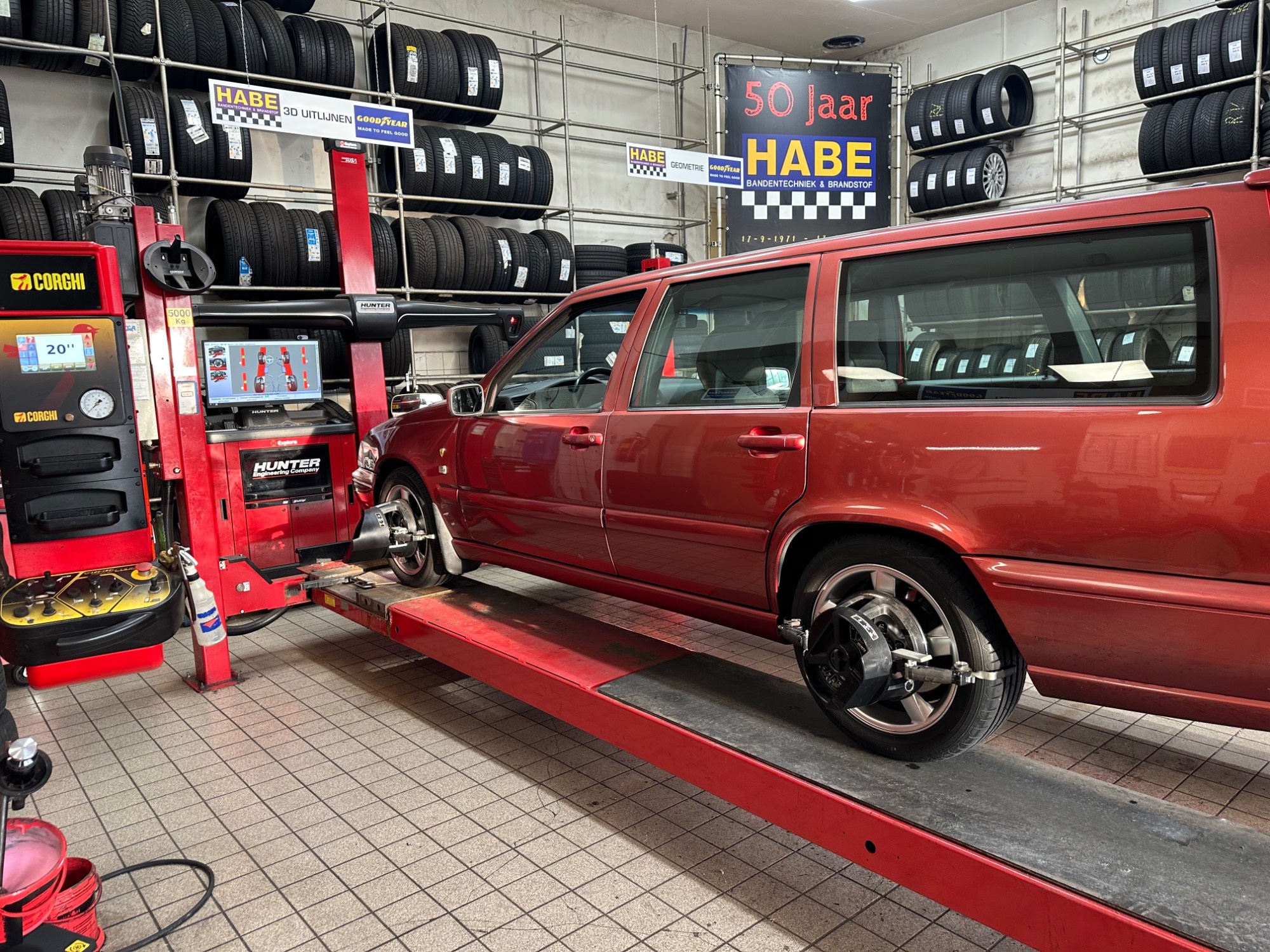

I forgot to take a picture of the alignment specs :oops:
