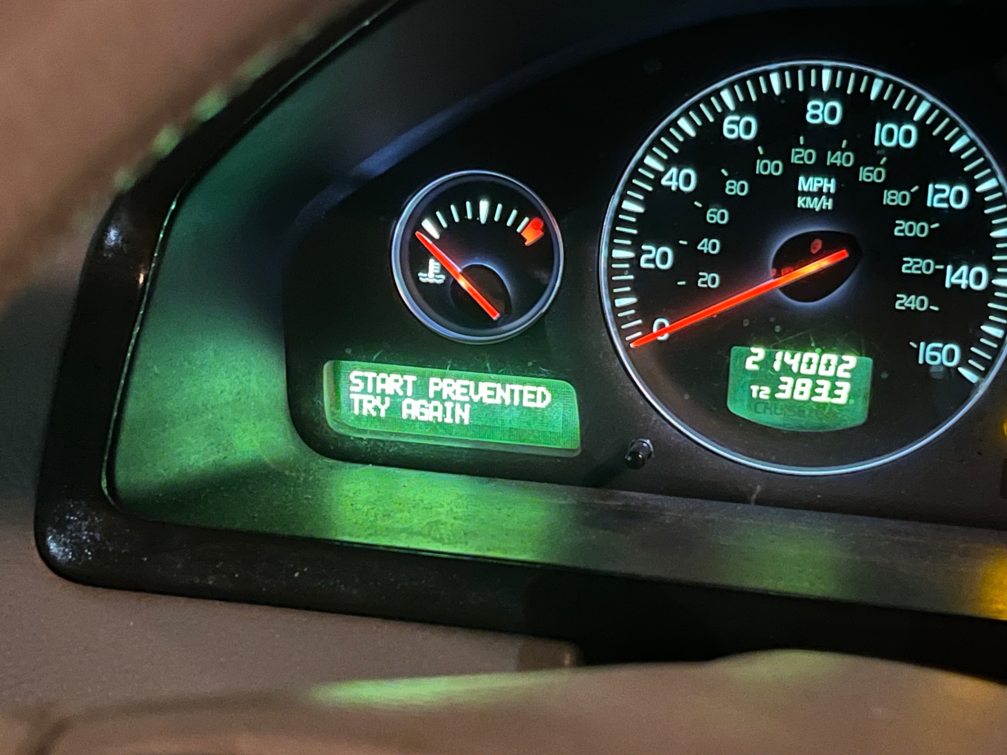

.93SCMax wrote: 05 Jul 2024, 08:32 I've been through the infamous ignition switch tumbler problem. Read many posts. A while back did the lower plate removal, and tumbler cleaning. Worked great for a while with smooth key action and easy starts, but always came back to eventually sticking or getting hard to turn to position III. I've recleaned the tumbler with quick dry brake cleaner, blew out with compressed air and then added WD40 dry lube. Key now turns smoothly to III and then returns to II as it's suppose to. Problem is, all I'm now getting is "Start Prevented Try Again". I can remove the ignition switch on the left, turn the inset clockwise (like to start), and I get the same dash message. I've tried different keys, even the valet key (never used before), and get the same message.
Would disconnecting the battery for a period of time reset the lock-out?
Would my immobilizer be the root cause? How can I troubleshoot this?
I've read some say disconnect the battery and touch the + and - cables together. This seems risky but would this clear the lock-out?
Could it still be the ignition switch (8645226)?
I can head to a pick and pull for another immobilizer ring, but we will be in the mid 90's the next week and I'd like to avoid that. I'd also like to avoid replacing the entire tumbler as it seems to be working smoothly at the moment.
One last thing, 5sp mt so no transmission lock-out. Once she starts, I'm good to go...until the next key turn.
Thanks for any input or self experience you can add.

Solution: Immobilizer antenna ring was bad, possibly contaminated when I cleaned the ignition tumbler. New OEM part (8621509) was $72.99 shipped from FCPEuro. Once installed, all three keys started the car with the 1st turn of the key.
Advice to those with ignition tumbler problems, remove the Immobilizer antenna before cleaning out the tumbler.
Thanks to all who offered advice.

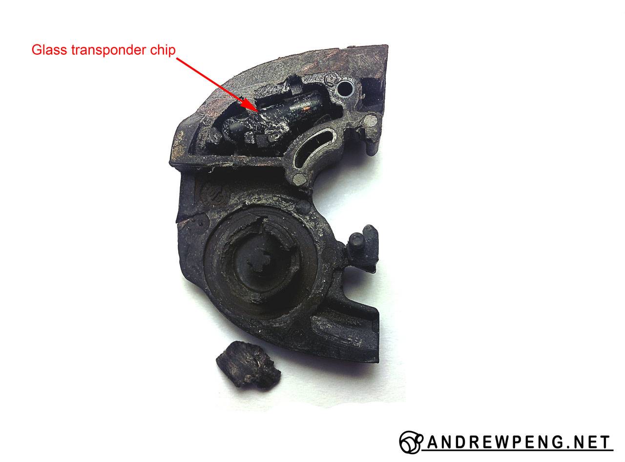

The transponder chip is inside a glass cylinder and it looks like a large grain of rice. This eBay listing has a good picture of the transponder: https://ebay.us/m/ghflvE Look for "ID48 Volvo transponder" if the listing is gone.
The transponder is buried in adhesive near the switchblade pivot on the top half of the key and it is very easy to break the glass when digging it out of the glue.

These are two separate circuits. Immobilizer chip is MegaMos Crypto ID48, the remote fob is I forgot what. ID48 rarely fails, but fails. The blank chip itself was like $2 last time I looked, but Volvo upcharges you a lot.Krons wrote: 18 Jan 2026, 10:11 Is it possible for the immobilizer chip for ignition to fail, and the lock/unlock still work?
