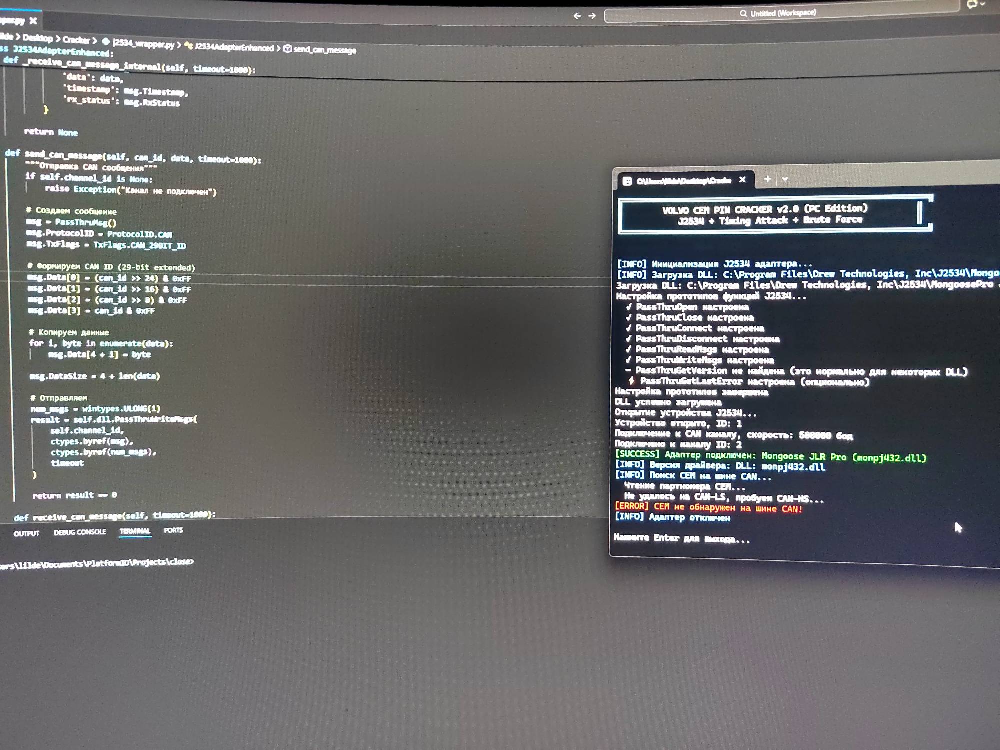

Or, to put it another way, I have a ready-made device lying around, it has STM, 2XCAN, and turbo Bluetooth on board. Someday I'll find the time to finish the firmware and add a cracker.)))
I want to make j2534 and have your code on board that runs on demand.

I see no reason why it can't be done. The hardest part will be converting to yet another CAN library. But it was done once already, MCP2515 -> FlexCAN.
I know you're not a fan of AI slop, but it can likely convert it in under 5 minutes. :D
I've already tried. Unfortunately, it hasn't worked yet.
