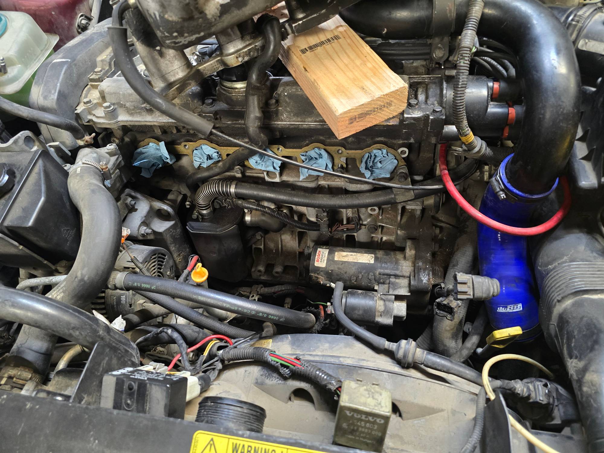

I also removed the intake manifold and cleaned all the hard to reach ground cables. There are 3 attached directly to the block, 2 behind the starter and 1 below the PCV box near the oil pan. Cleaned the alternator wire and starter wires while I was in there. And of course if you're this deep in, you might as well remove and clean the PCV box. Mine only had some minor gunk in it. A little brake cleaner took care of that.
Also since my ECT harness was broken, the wires are very easy to access with the intake manifold off. I could replace the ECT as well without removing the coolant hose but chose to leave it since its working fine. If I found my self in a situation where the thermostat housing bolt were seized and you needed to change the ECT, removing the manifold really isn't that bad. The gasket is cheap and the fuel lines are very flexible once the clamp is removed. I just left my gasket in place since it was undamaged.
For the ECT wiring repair, I used a generic 2 pin pig tail harness from Oreillys. The wire gauge is overkill at 14 gauge but it has given me any problems. And this is probably a bit safer than the Wago nuts I had placed temporarily.
Got everything re-assembled and performed a test idle. No changes to idle after ground cleaning and ECT wiring repair.
