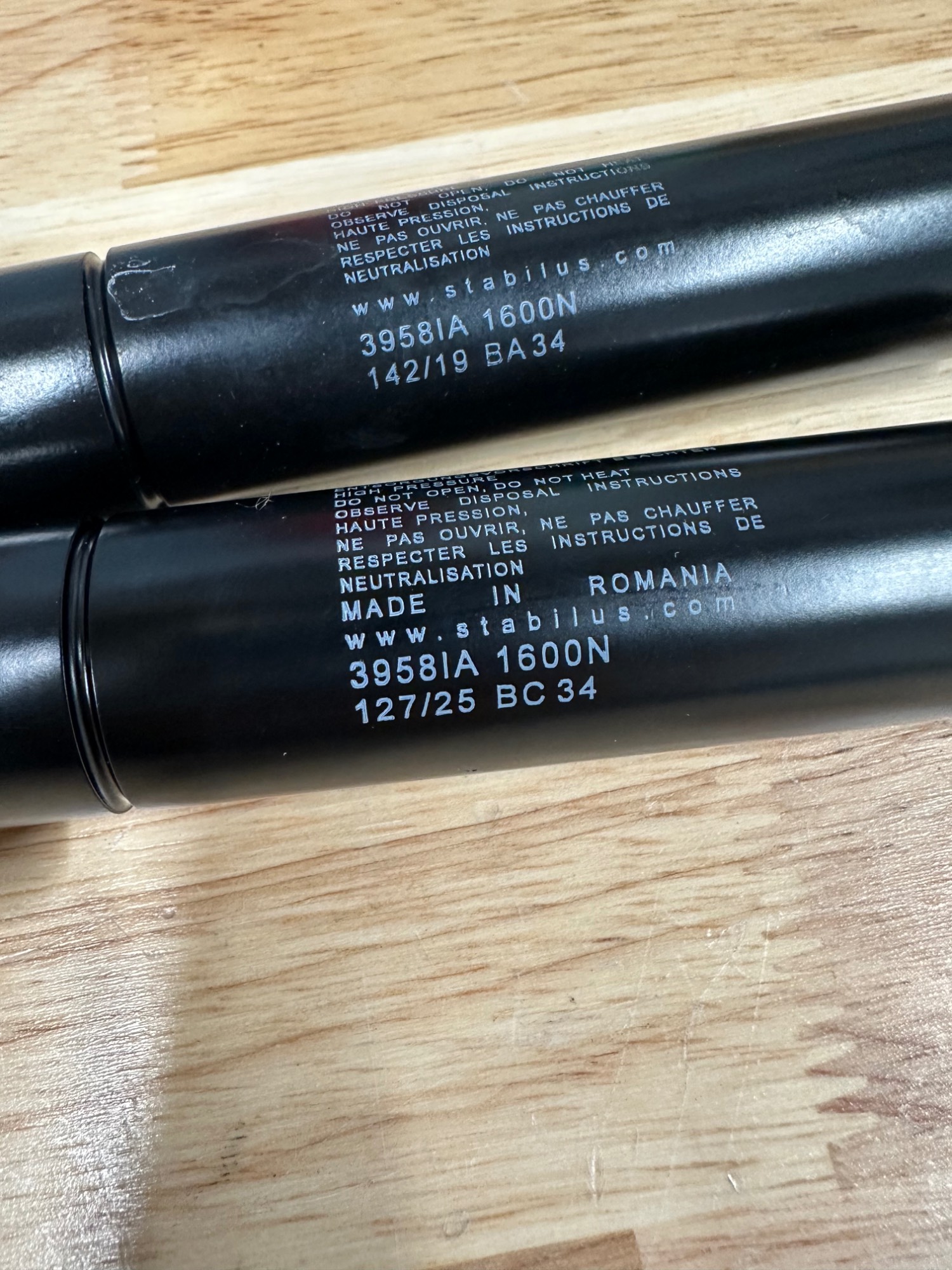

These oem tailgate struts didn’t last 5-6 yrs. that’s if the 19 stands for 2019.
I bought the car last year and the tailgate struts was already not working well. Now it goes smoothly up automatically.
The new struts are manufactured last year. Hopefully it’ll outlast me owning the car.

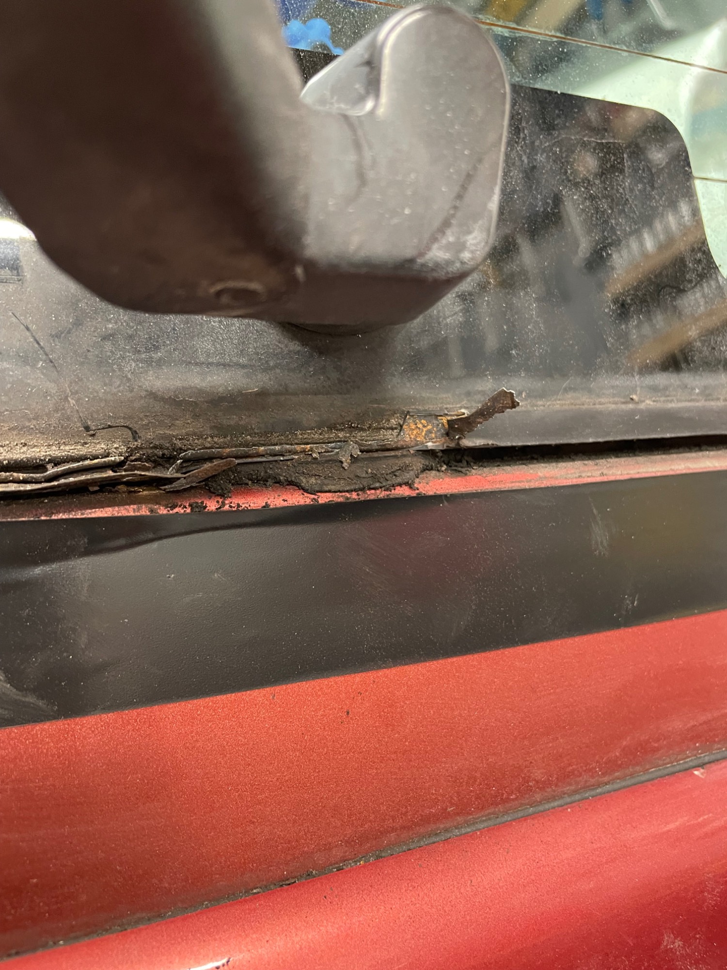

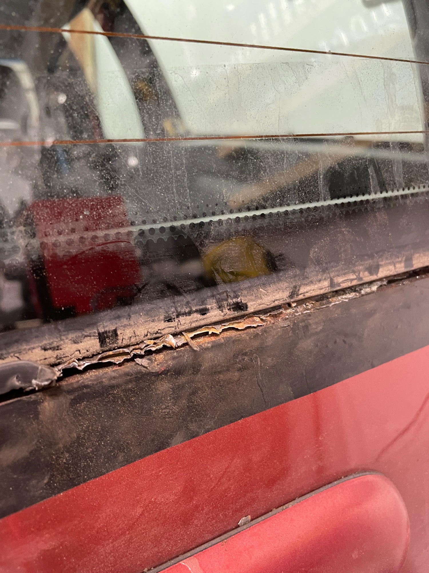

I’m warm in the box, trying to remove the darned tailgate window strip.
It’s stuck in the glass adhesive. I have to cut the metal part and mangle it out.

It's a true PITA to remove, I used various small pliers. I then derusted it, painted it and filled in the groove with sikaflex.

Chieber wrote: 25 Jan 2026, 08:53 And we’re complaining when it’s 1 degrees Celsius now haha.
Would a heat gun help with this project?
Unfortunately not. I check the window date stamp and it’s from 2008.
So the tailgate window has been replaced and they used a lot of adhesive which wasn’t applied nice and evenly.
