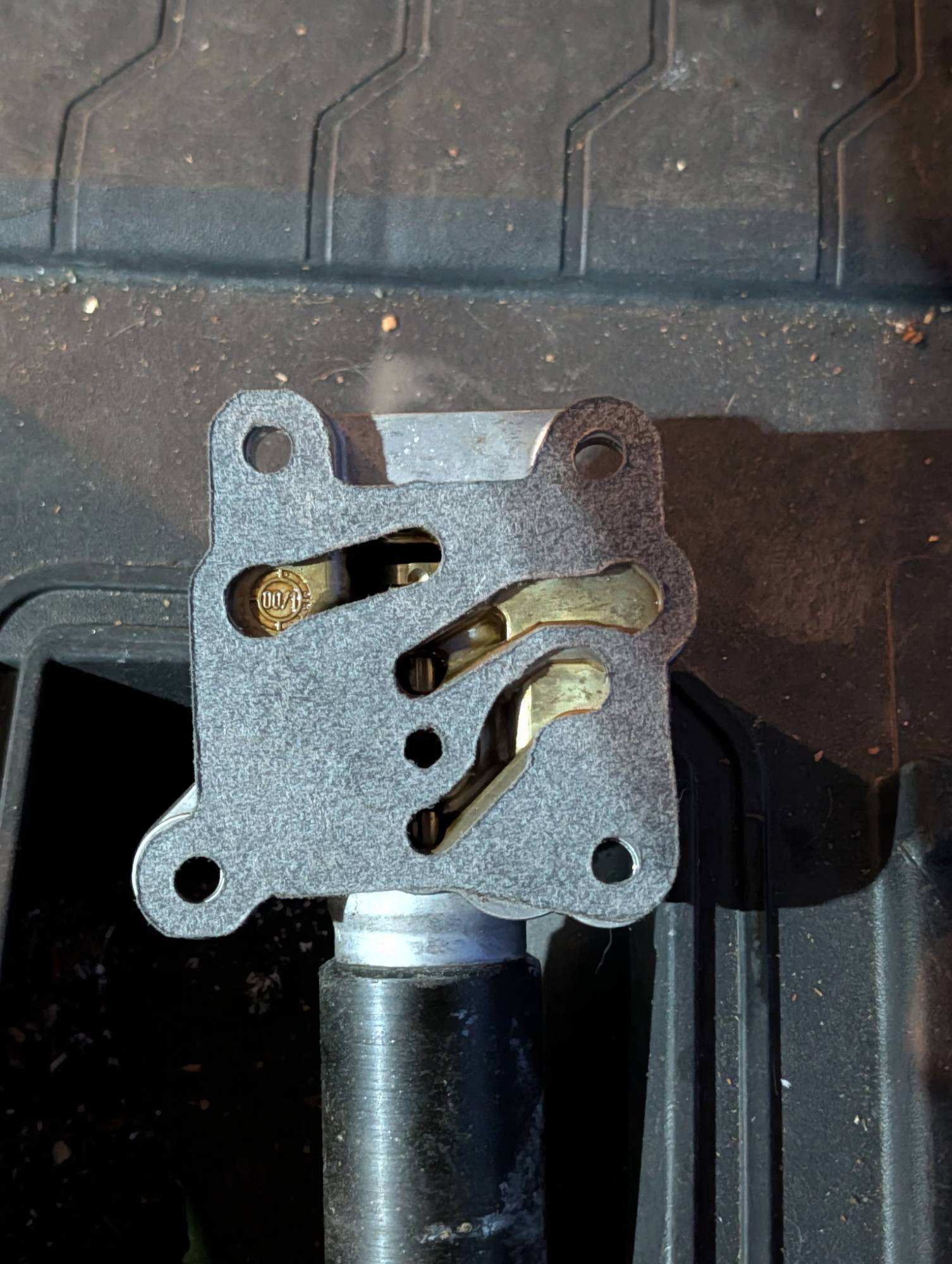

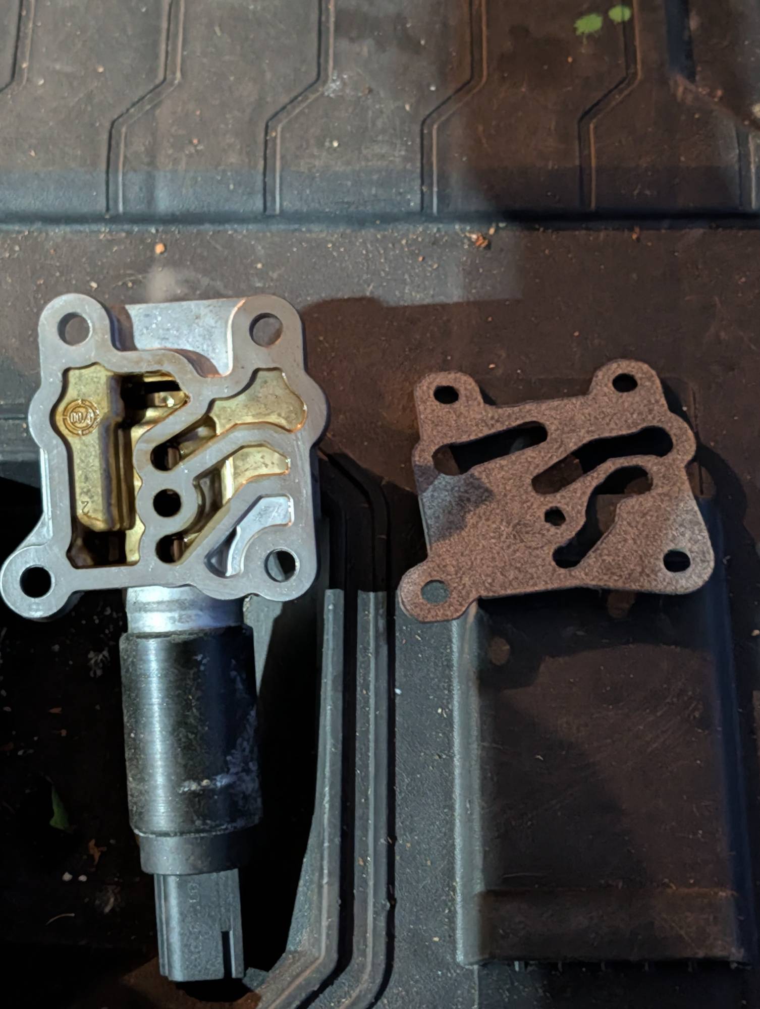

a bit misleading. but as these cars get older and parts are harder to find and i needed a vvt solenoid gasket (yes, i know theyre still currently available) i was curious if one could easily cut complex shapes out themselves from gasket sheet at home using a cricut (or silhouette or whatever brand your wife/gf might have) cutter.
the answer is, yes, quite easily
also, i know this needs a piece of wire cloth over the one hole, i just dont have the right size mesh at the moment

i cut the one above on a cricut, it's basicly a 2 axis cnc cutter, the one i had access to has a 24" X axis and an infinite Y axis, it cut the vvt gasket (rubber/paper type gasket .7mm thick) in 4 passes, probably could have done it in 3, but the amount of time difference would be negligible. if i needed a metal reinforced one i would likely get a fiber or diode laser head for one of my 3d printers and use that instead.
manually is fine, but i'd really rather not if i don't have to.
