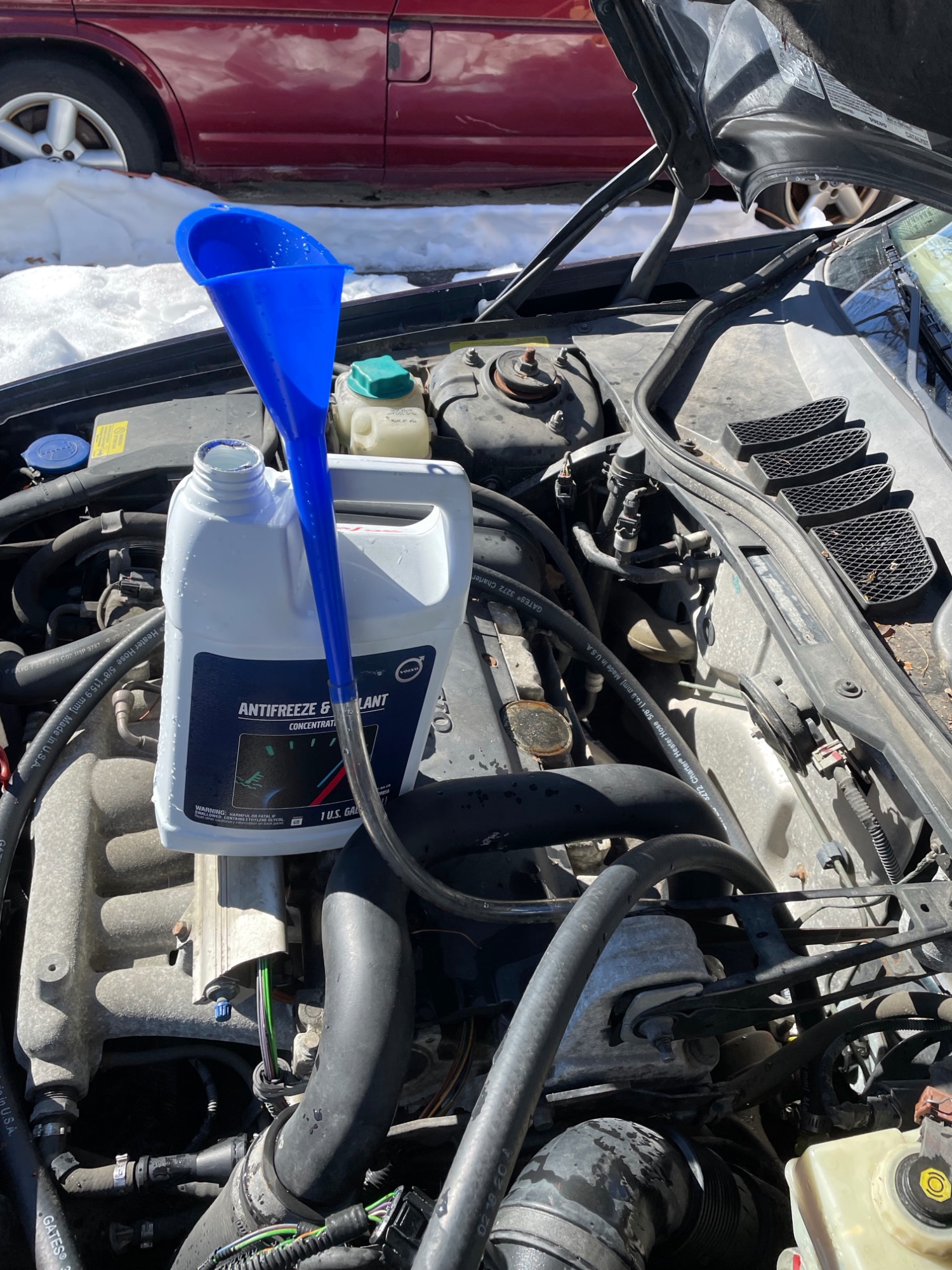

No , but full credit given. Got hood up and she took almost a gallon of coolant. Not sure where it is leaking but heater core is prime suspect. I better get that light fixedDub24 wrote: 31 Jan 2026, 14:26 Are the windows fogged up ?

I will check bulb and circuit in warmer weather. I think this car seeps at the radiator and I blew coolant at idle while I shoveled driveway. Glad I didn’t hurt anything. Good lesson there.scot850 wrote: 01 Feb 2026, 00:27 No low level warning light? Had it stuck in the header tank?

Topped it off and ran 3 miles into town. Reservoir empty
:O
I must have a gallon of coolant sloshing under floor so now it’s a spring project.
I will bypass the heater core later today when home to confirm core leaking

Knocked off the heater core in 40F sunshine, 2 hours in drivewa
Bypassed core to confirm leak, used 5/8 hose for this
T15 screws rear each side. T25 screws in vertical position
T25cmachinecscrew on sealing block.
New orings
Juno Approved!
Part number 9144221 FCP ORDER R671910733
