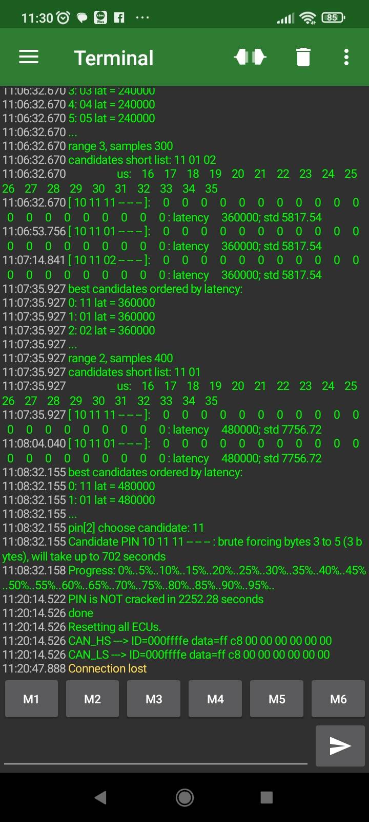

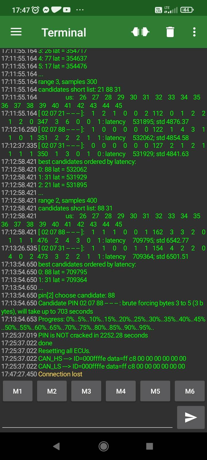

Resetting all ECUs.Code: Select all
$ ./seed-gen --seed "fa 6e b8" --key "2d d3 8c" Searching all hash collisions for SEED fa 6e b8, KEY 2d d3 8c at 866 tries per second 3.23 hrs [ 1] PIN 00 10 08 28 81 10.75 hrs [ 2] PIN 00 33 51 81 48 13.24 hrs [ 3] PIN 00 41 28 09 80 15.73 hrs [ 4] PIN 00 49 02 90 19 39.05 hrs [ 5] PIN 01 21 73 73 81 39.49 hrs [ 6] PIN 01 23 11 85 37 41.28 hrs [ 7] PIN 01 28 68 91 43 42.27 hrs [ 8] PIN 01 31 76 61 93 42.71 hrs [ 9] PIN 01 33 14 97 25 47.95 hrs [ 10] PIN 01 49 47 86 74 51.14 hrs [ 11] PIN 01 59 42 94 66 51.50 hrs [ 12] PIN 01 60 56 40 92 53.86 hrs [ 13] PIN 01 67 90 01 33 54.70 hrs [ 14] PIN 01 70 53 52 80 57.08 hrs [ 15] PIN 01 77 95 13 21 58.81 hrs [ 16] PIN 01 83 33 31 83 ...
