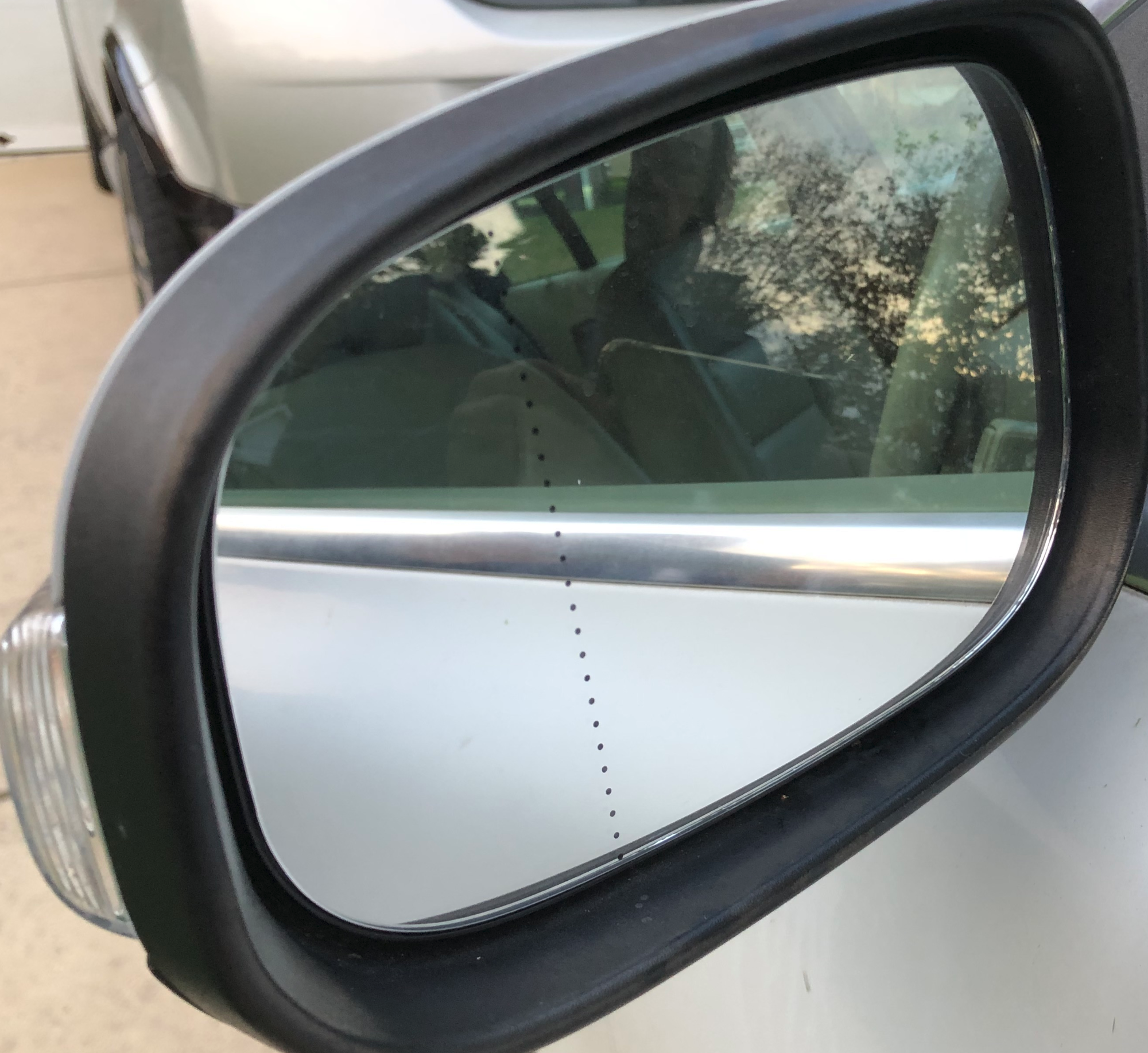

The P2 mirror also fit our 09 S80 3.2 currently not on the road due to my health. I did however replace the missing mirror. You can either replace the mirror glass or mirror assembly meaning the glass already attached to the black plastic backing plate, which those two tabs clip to and pivot on. On our 08 C30 we replaced the glass only as it was already pricey by itself. I opted for the assembly for the 09 S80. I think there were no grease on either the pivot nor flaps as dirt would accumulate turning the grease gritty. It's just a guide and serves no purpose for stability nor tightness. If the flaps are Teflon it's self lubricating.

I have the 3" (no smaller) convex mirrors on all my cars including the Volvo's smaller mirrors. Got use to them, the larger and smaller while driving an Iveco bobtail years ago and just can't do without them now. I will see how this new mirror with built in wide angle works before deciding on installing the convex mirror. Not sure when I can get the car on the road however. Hope it's cheaper in Canada as I paid more last year.
