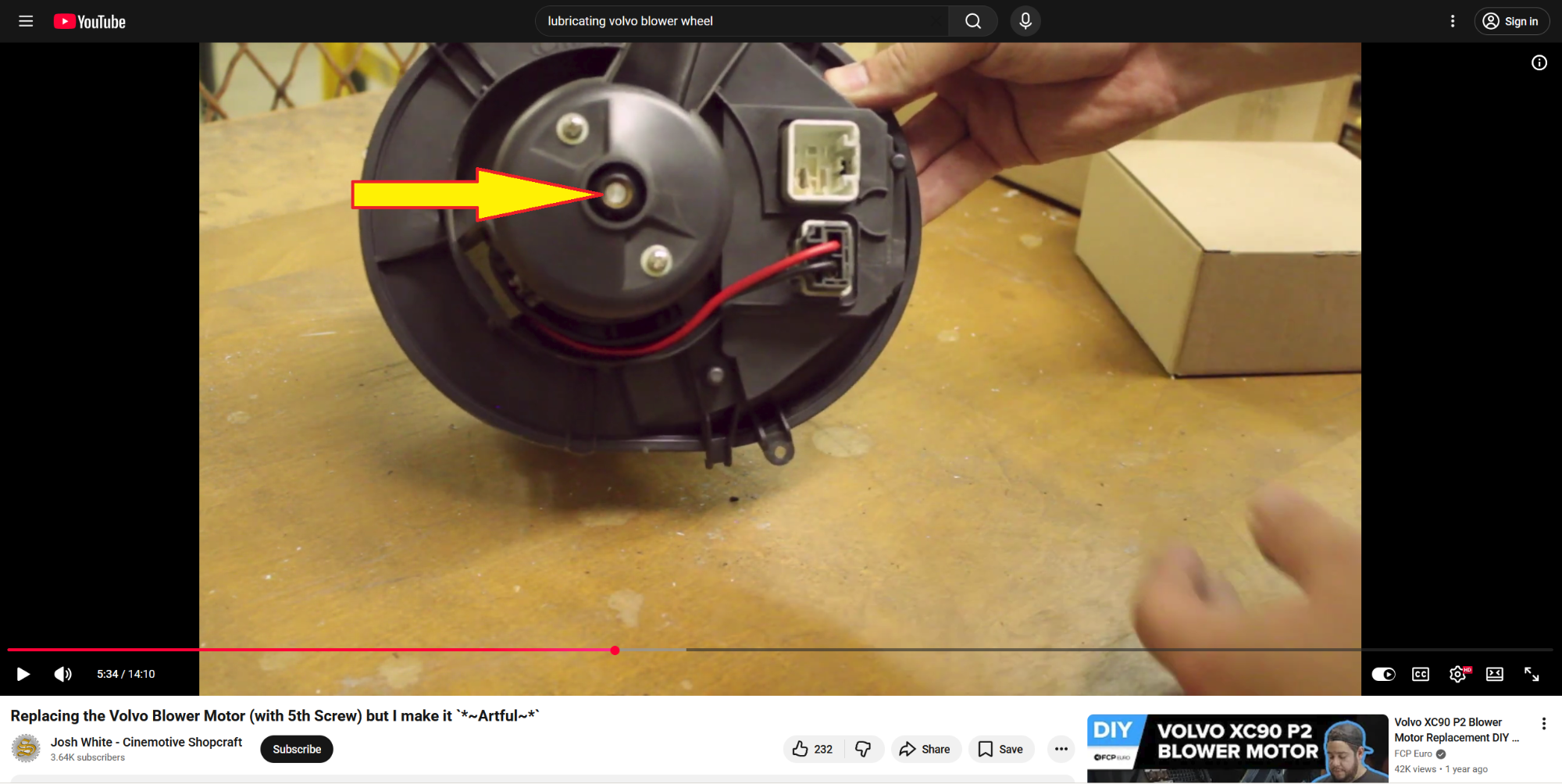

I have two that I need to work on sooner or later so I just did some research. The video doesn't show the bushing till the blower is removed. Someone who has done the work please confirm the location to spray the silicone.

Easier from top underneath the windshield cowel maybe?
