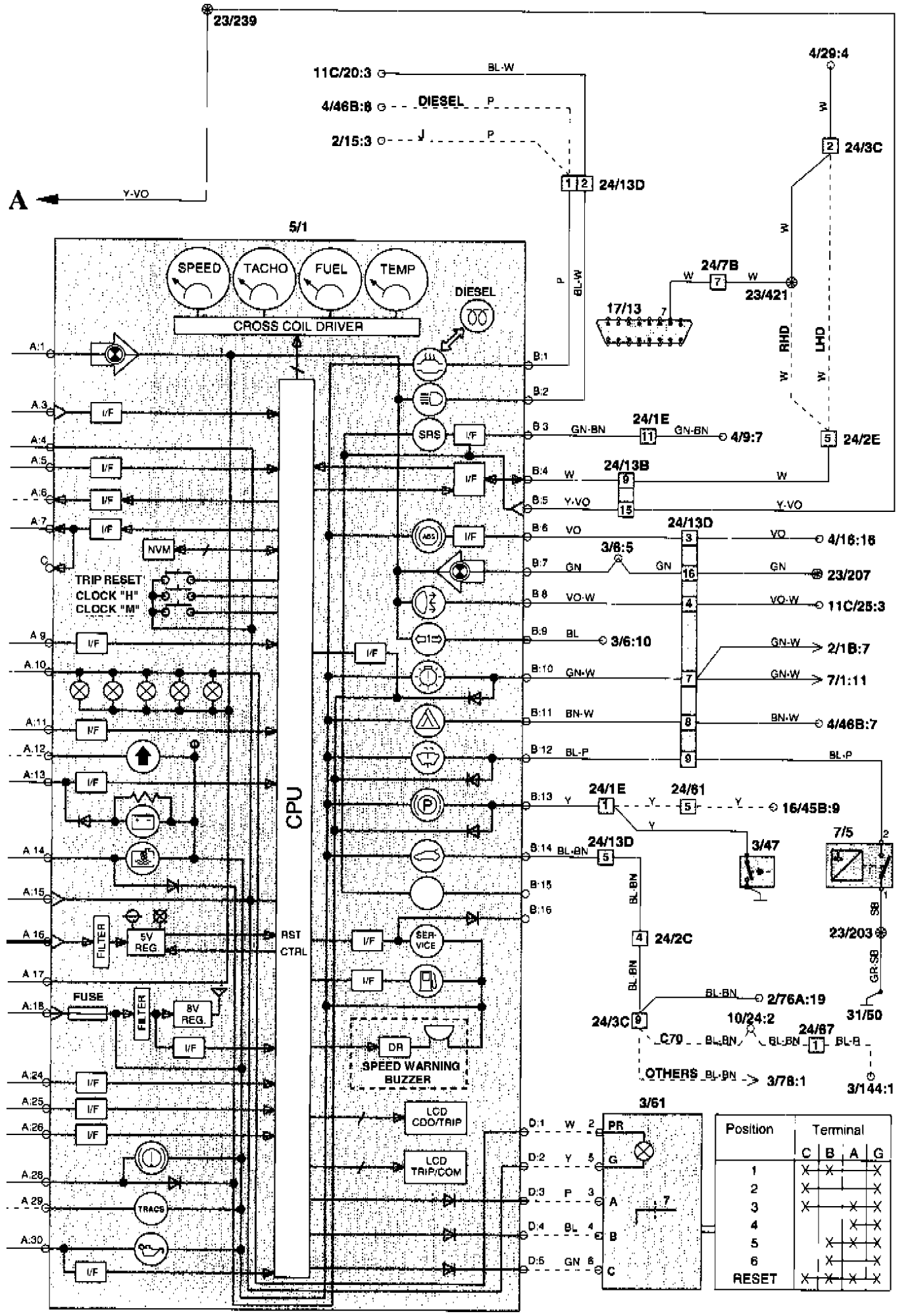

I had a quick look on the circuit page but the tach gauge is driven by the central display module CPU

Ahhh, I see, Do you think the CPU is faulty? Or is it possible there's just cracked solder joints/bad caps? Is this a common issue?abscate wrote: 19 Feb 2026, 17:31 I had a quick look on the circuit page but the tach gauge is driven by the central display module CPU

I’ve never dived into a driver display module or central display module ( I’m not sure what the official name is)
This is what you get in VIDA on the 99 v70, the 98 might be a bit different
I’m not sure where engine speed is fed into the display processor, somewhere on the left

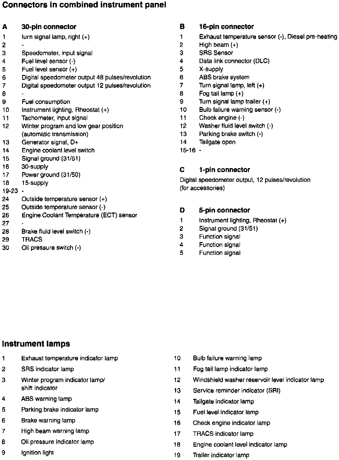

I managed to find a 98 specific one, from what i gather A3 is speedo input and A11 is tach inputabscate wrote: 20 Feb 2026, 00:58 I’ve never dived into a driver display module or central display module ( I’m not sure what the official name is)
Considering fuel and temp are working, It would be surprising if the CPU failed, I'm thinking maybe there are some bad connections somewhere.
I'll dig out the cluster when I get the replacement bulbs in the mail on Monday. Thanks for all the help, I'll keep y'all updated
