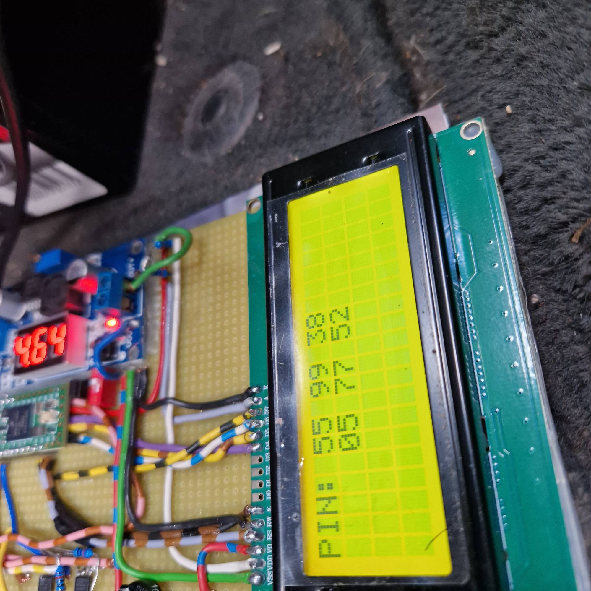

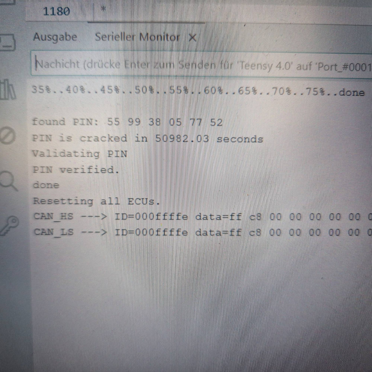

Hello everybody,
I have registered me at "Matthews" because of getting an 2005 Volvo V70 2nd Generation; so the step to tune up "my" Volvo was not far away; now I´m here and, of course, I´m impressed and thankfull about provided information and know-how.
I have build my own "CEM-Cracker" for further diagnostics, for e.g. coding new keys and so on.....
The result after a "few" hours.....
Many thanks to whom created such a powerfull tool !!!
Many thanks and a nice day
Greetings alex3211
Greetings alex3211

14 hours? On a 500 Kbps CAN bus? It usually takes 20 to 40 minutes.alex3211 wrote: ↑Today, 04:14 Hello everybody,
Greetings alex3211
Hello vtl,
maybe its founded in my soldering-skills and/or board-wiring.....the cem-cracker software has calculated 2 bytes only; four bytes where identified by brute- force.....so for the first time and finally with success.... I'm satisfied
Nice day
alex3211
Nice day
