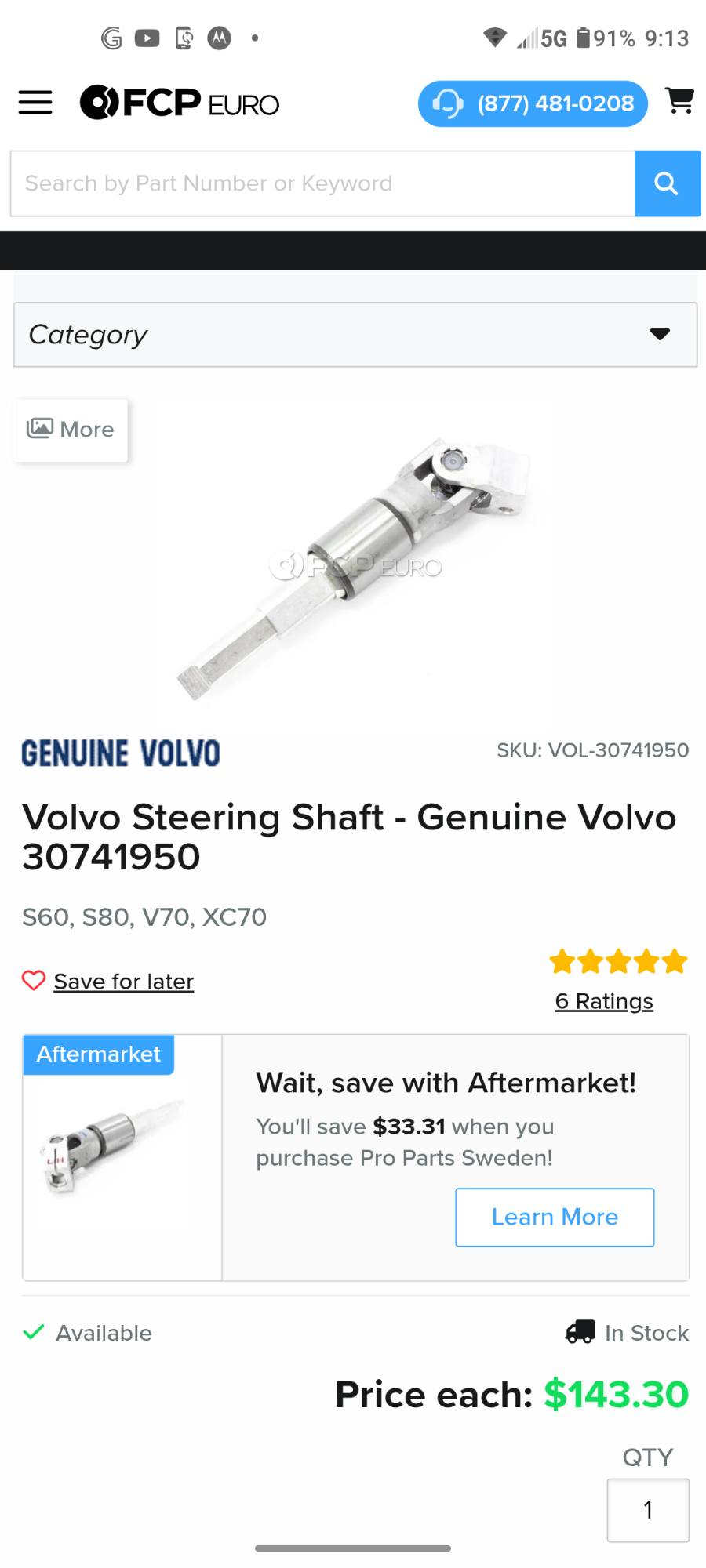

My question is how do you replace the steering u joint and could someone tell me what the OEM number of the part is?

- I think the PN is in the photo below. Use genuine Volvo part only.
- If you are short of budget, then find a standard u-joint (I think it is 15x40mm type but check to be sure). This setup has no circlip, so it is similar to driveshaft staked u-joint. Use a C-clamp to press it out (brace the yoke ears with a piece of metal first). Once the new u-joint is in, re-stake it using a small-tip punch + hammer.

Budget is not a problem, I am willing to buy an original item, I love my car and do not want to compromise on quality.cn90 wrote: 28 Feb 2026, 08:18 - I think the PN is in the photo below. Use genuine Volvo part only.
When checking by VIN number, the number they provided me for the part is 3409939 - https://www.tascaparts.com/oem-parts/vo ... ft-3409939, which is different from the one in the screenshot.

Actually,
The u-joint replacement is easy if you have done it before (driveshaft etc.).
No compromise on quality.
However, it is easier to replace the entire thing.

I will replace it with a new part. It is not that pricy.cn90 wrote: 28 Feb 2026, 11:29 Actually,
