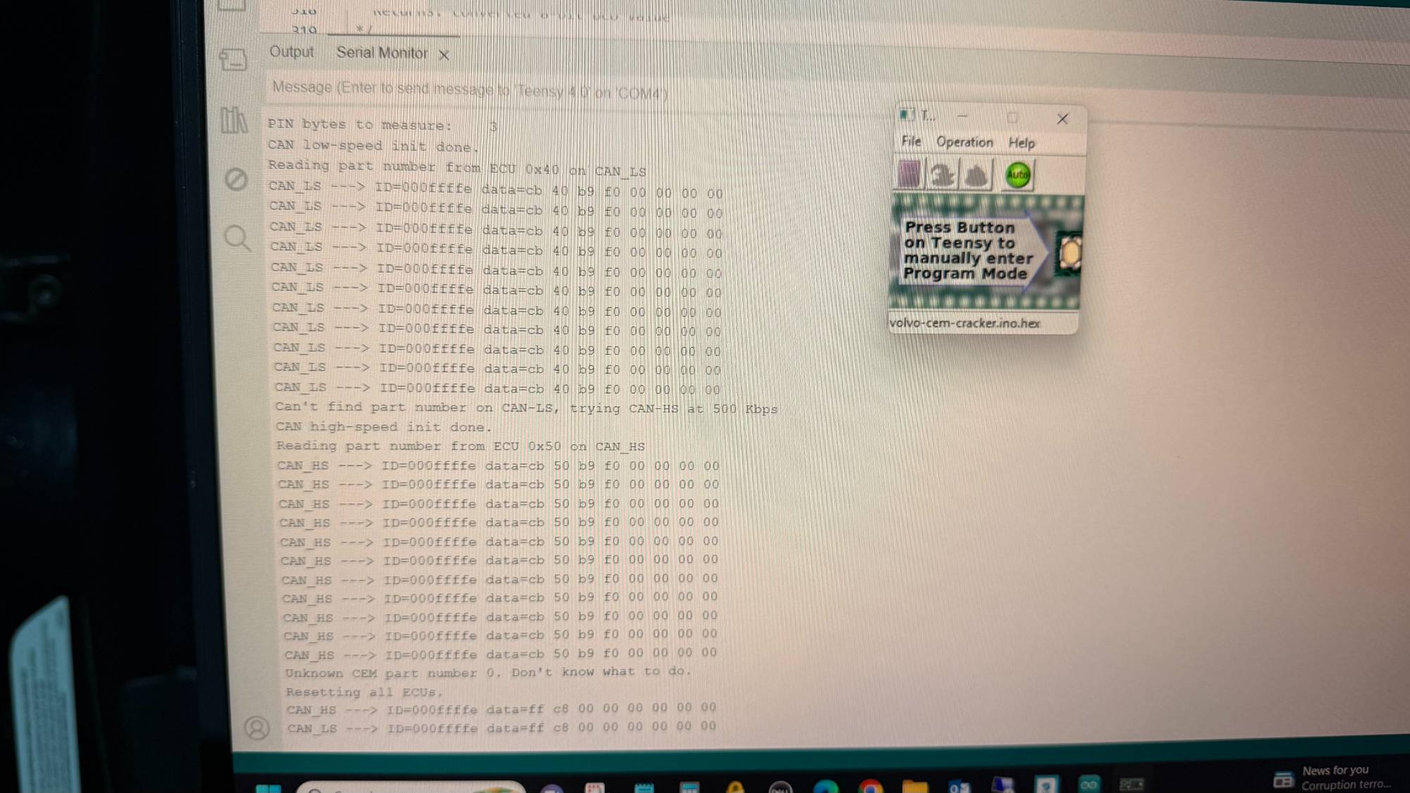

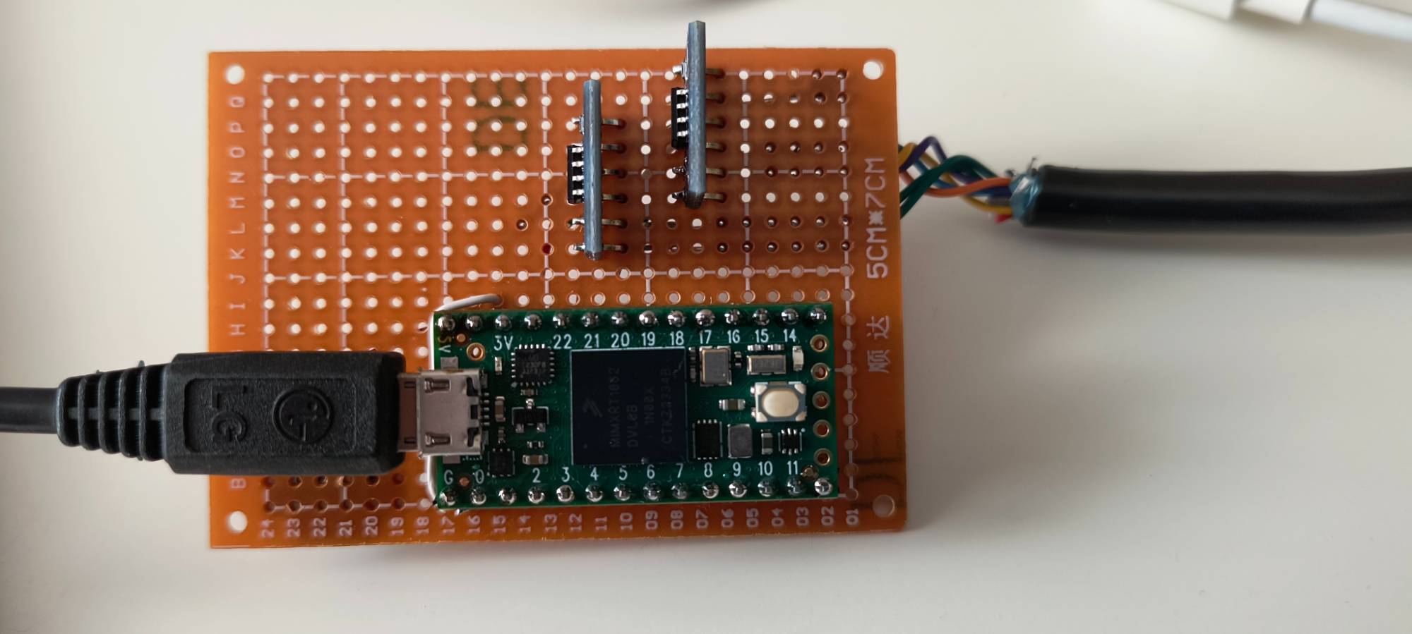

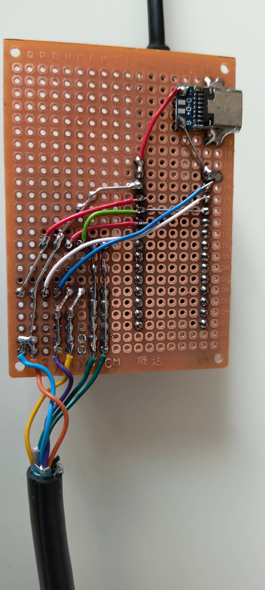

Hi all, thank you for this wonderful project! Some months ago I bought a 2010 S40 2.4i, and I am looking for some help setting up my own device, as I have some trouble connecting to the vehicle. As I am not familiar with either programming or electronics, I asked one of my friends to assembly a CEM pin cracker based on the documentation found at GitHub. However, when I try to run the program, it says at the end: "Unknown CEM part number 0. Don't know what to do. Resetting all ECUs." I understand that it refers to the lack of CAN bus connection. Could you please help us identify what went wrong during assembly? I made some photos of the device as is. Thank you very much for your insights.

Do you see any CAN messages running?Rubie wrote: 02 Mar 2026, 06:17 Hi all, thank you for this wonderful project! Some months ago I bought a 2010 S40 2.4i, and I am looking for some help setting up my own device, as I have some trouble connecting to the vehicle. As I am not familiar with either programming or electronics, I asked one of my friends to assembly a CEM pin cracker based on the documentation found at GitHub. However, when I try to run the program, it says at the end: "Unknown CEM part number 0. Don't know what to do. Resetting all ECUs." I understand that it refers to the lack of CAN bus connection. Could you please help us identify what went wrong during assembly? I made some photos of the device as is. Thank you very much for your insights.
It is something like here in the picture. I will shortly run a test, and copy the output of the serial monitor.vtl wrote: 02 Mar 2026, 06:24Do you see any CAN messages running?Rubie wrote: 02 Mar 2026, 06:17 Hi all, thank you for this wonderful project! Some months ago I bought a 2010 S40 2.4i, and I am looking for some help setting up my own device, as I have some trouble connecting to the vehicle. As I am not familiar with either programming or electronics, I asked one of my friends to assembly a CEM pin cracker based on the documentation found at GitHub. However, when I try to run the program, it says at the end: "Unknown CEM part number 0. Don't know what to do. Resetting all ECUs." I understand that it refers to the lack of CAN bus connection. Could you please help us identify what went wrong during assembly? I made some photos of the device as is. Thank you very much for your insights.

These all are send requests sent by Teensy to car. Teensy does not get any messages from the car.Rubie wrote: 02 Mar 2026, 09:21 It is something like here in the picture. I will shortly run a test, and copy the output of the serial monitor.
You can try to remove autodetect: https://github.com/vtl/volvo-cem-cracke ... er.ino#L14 If that will not help - check your device.
Thank you very much for the tips, I will try them in the coming days!vtl wrote: 02 Mar 2026, 09:27These all are send requests sent by Teensy to car. Teensy does not get any messages from the car.Rubie wrote: 02 Mar 2026, 09:21 It is something like here in the picture. I will shortly run a test, and copy the output of the serial monitor.
