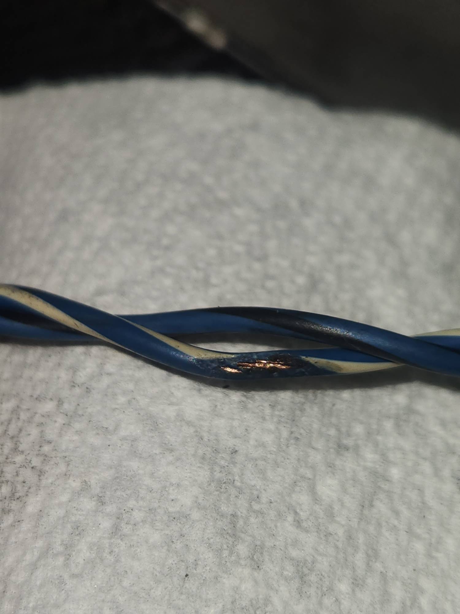

Here's the solution to my problem, courtesy of Dave in the U.K. who PM'd me: it was a wiring short inside the engine wiring loom. It would only short once heated up. More specifically, one of the 3 wires on IAC circuit would short when hot, but not when cold. I was able to verify the short by testing between IAC wires and the corresponding pins on the ECU socket. Trying to attach pics here of the wire damage.
All I can figure is the 10 gauge ground wire for the cooling fan, which wire runs through the loom, overheated in a 4" section damaging its insulation, exposing copper, and that then caused damage to adjacent wires, allowing some of them to short to ground. The section in the loom where this occured is close to the back end of the A/C compressor. I found 6 wires with exposed copper, several more with insulation worn almost all the way through. One of the IAC wires was one with exposed copper. I removed the ground wire entirely from the loom and ran a replacement 8 gauge wire independently, outside of the loom. The rest of the wires cleaned up well, copper strands seemed intact and insulation seemed relatively decent beyond the small openings shown in pics, so I individually taped up each of the spots and reassembled the loom. Haven't gotten beyond that point because I'm taking the time to address some other maintenance issues (lower radiator hose and tackling the engine-side heater hoses since I'm already this far into things). So folks will have to wait for a verdict on whether this solves my problem, but given the exposed copper it seems pretty clear that this was the cause.

That is a really unusual fault. In nearly 30 years of owning P80 cars I have never heard of an issue like this. So I am amazed you were able to find the wiring damage. Well done to you sir!
That almost looks like rodent tooth mark damage possibly.
