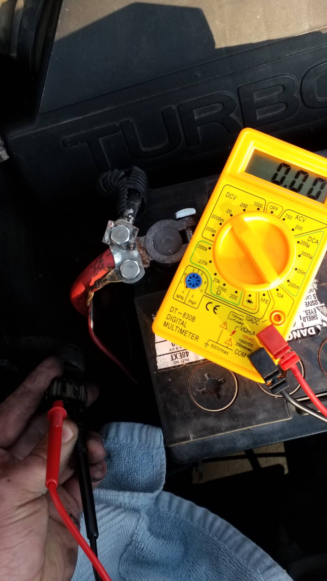

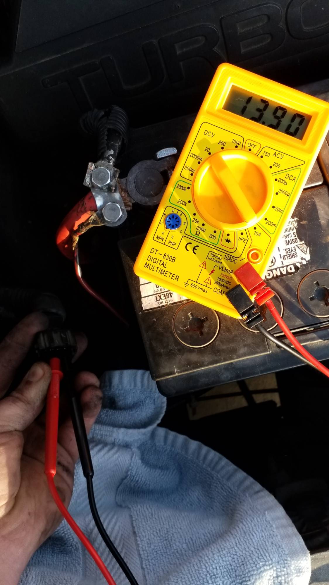

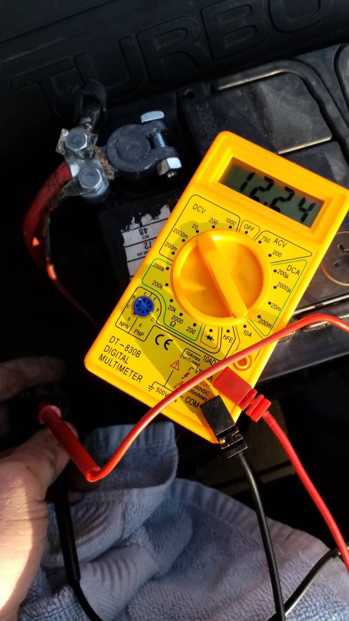

Major update: Review all the videos I posted. They should all be captioned underneath.
While I did replace the speed sensor on back of trans and that didn't fix the issue, I did find weirder and crazier things happening. Could that left power wire on the iac (based on voltage pics) be causing a problem?

How did you track this issue down? It would be helpful to understand your diagnostic process as it is a weird issue.
Thanks,
Thanks,
- CIK7
- Posts: 1702
- Joined: 14 Jan 2019, 08:15
- Year and Model: 2026 Sportrailer GLT
- Location: Antlers, Oklahoma
- Has thanked: 350 times
- Been thanked: 108 times
That's why I was so thankful you recommended paying Robert $10 to solve the issue. I told him everything going wrong with the electrical. He was the one that said it sounded like either 1 or 2 (not all 3) J relays might have gone bad. I changed them. Voila. Everything's peachy now. I did not diagnose anything since my last post on this thread.scot850 wrote: 04 Mar 2026, 18:41 How did you track this issue down? It would be helpful to understand your diagnostic process as it is a weird issue.
