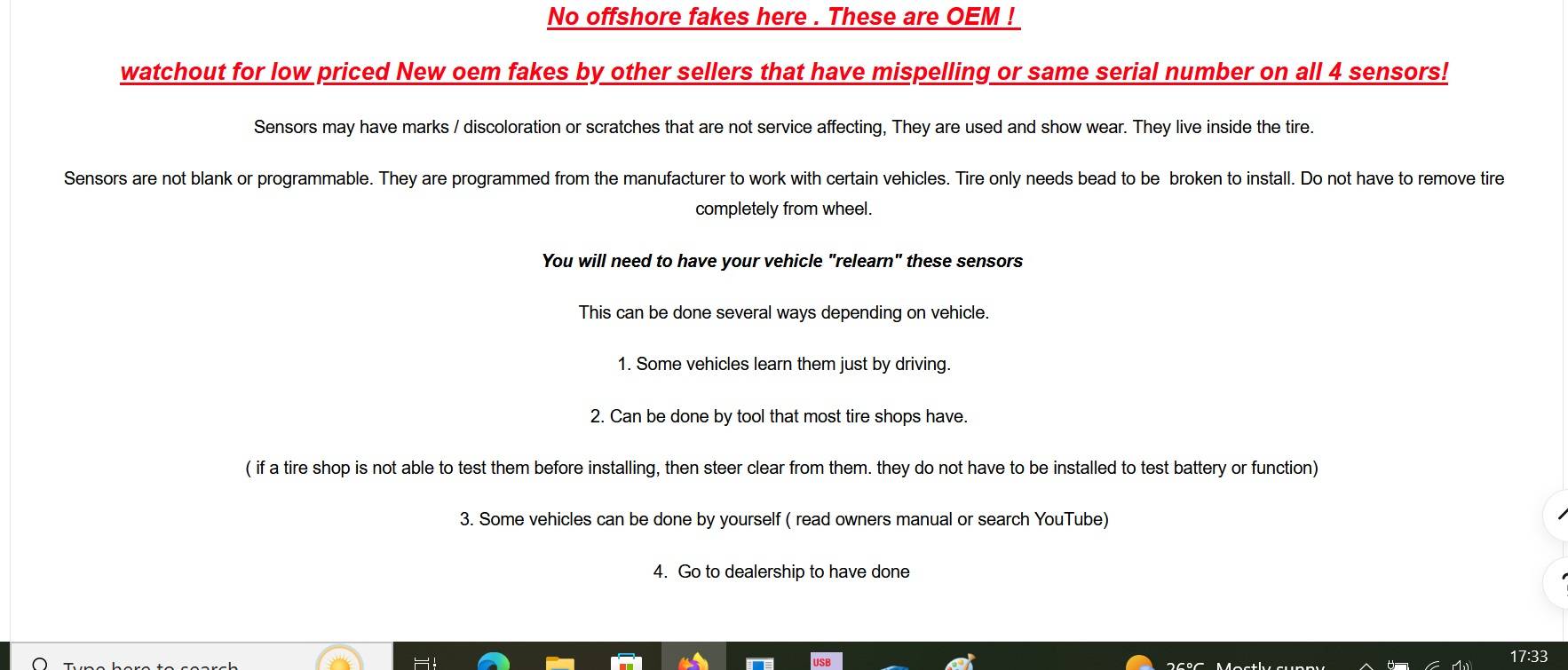

Are you planning to change the batt on the old ones or just swap in new ones or aftermarket ? i hear the latter is easier but more expensive as i hear you need to have them programmed but ask tyre shop first.
These are for the P3 but refurb battery changed seller note:Sensors are not blank or programmable. They are programmed from the manufacturer to work with certain vehicles

Apparently P3 cars just learns the new sensors and referb does NOT mean battery is changed
