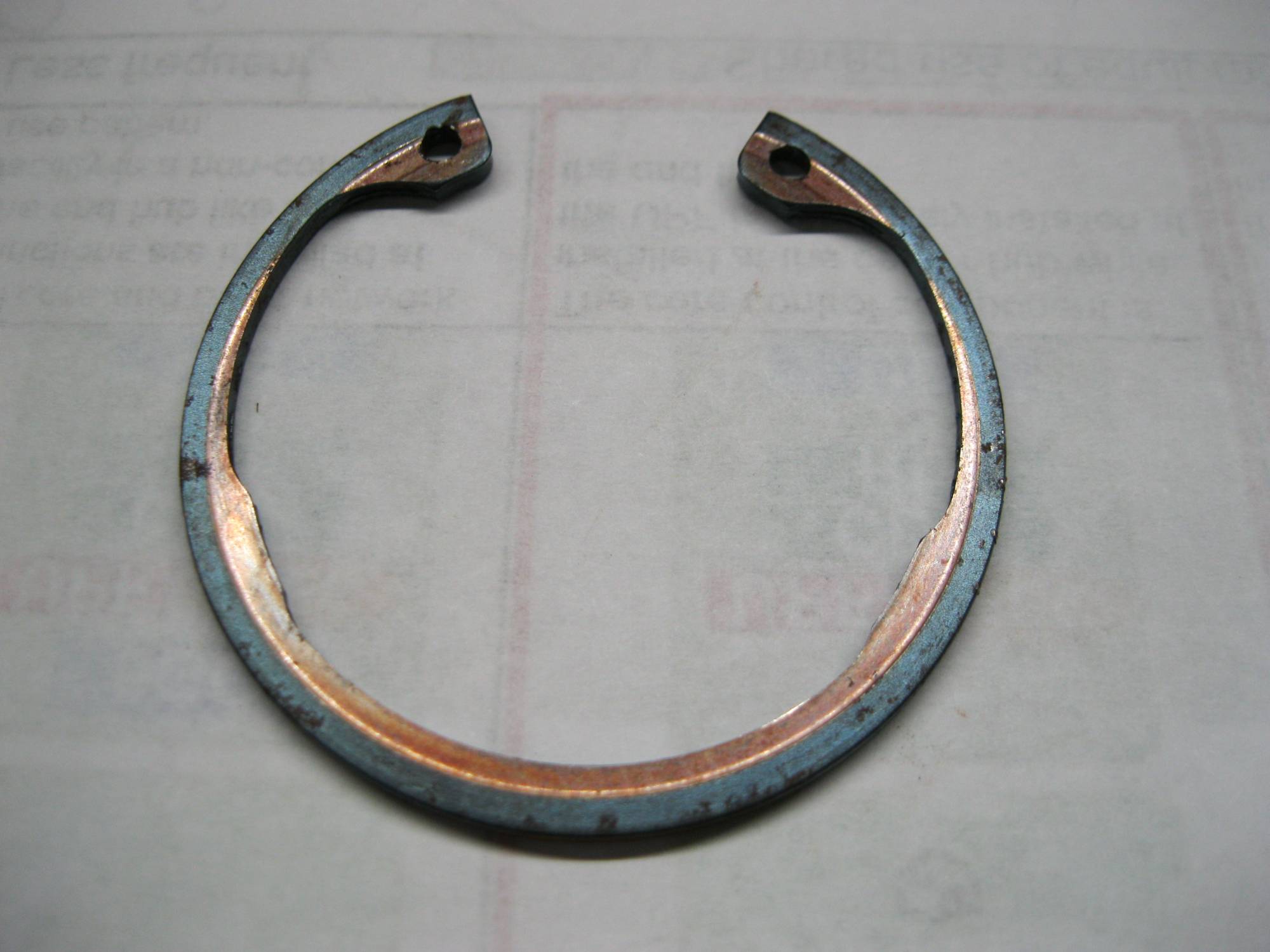

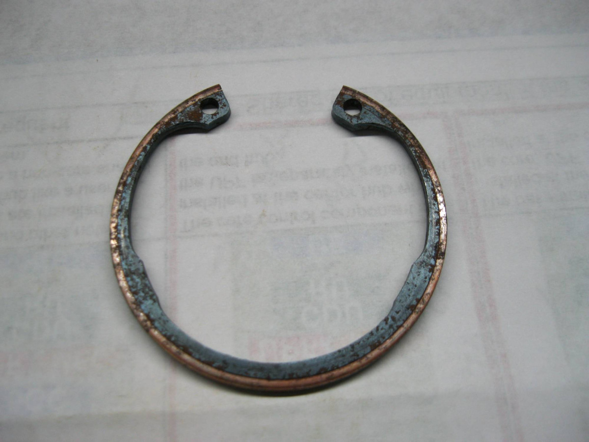

While I’m waiting for my angle gear to get reworked, I have some time to think more on my decision. I’m in a position to purchase a “new” Volvo exchange angle gear but I hesitate to do so as this is my second failure. Why me? Dunno, my mechanic packed a new sleeve full of grease when he did the first replacement in 2016.
I kept my first sleeve for a costly reminder of my driving but once I had the latest one out, I looked at them. On both sleeves, the wet transmission side is perfect. It’s the angle gear side that fails and the failure is dry rust wear over time at the spline interfaces. Dry rust wear, on a sleeve that in 2016 was well greased and had perfectly new splines on both sides. One thing I noticed, on both sleeves there are depressions in the snap ring on the angle gear side. When I look closely, the depressions appear to be made by the gear stripping and spinning on the surface with some pressure, this is where the sleeve meets the angle gear input shaft. In both cases, there’s a “smear” of metal as the input shaft spun but what’s critical to me is the fit. On both my sleeves, the clip is the limit to which the sleeve can be installed on the angle gear input shaft. I don’t see any lateral movement once it’s all put back together, it's a tight fit.
I believe that when the angle gear assembly is put on, the sleeve fits solidly against the transmission by virtue of the circlip being pressed against the angle gear input shaft as the unit gets bolted down. If this is a true, then there’s no appreciable movement of the sleeve and wear is no longer a rust exacerbated challenge.
This is what we’ll find out.
Photo of the sleeve transmission side, pretty much perfect: Photo of the angle gear side, see spline and circlip wear: Photo of both sides of the circlip: Photo of the angle gear to transmission mounting (note rust, see how "open" the mounting interface is): Last but not least, a poor man's diagram of the interface: edit 031026- add circlip photos, modified drawing
