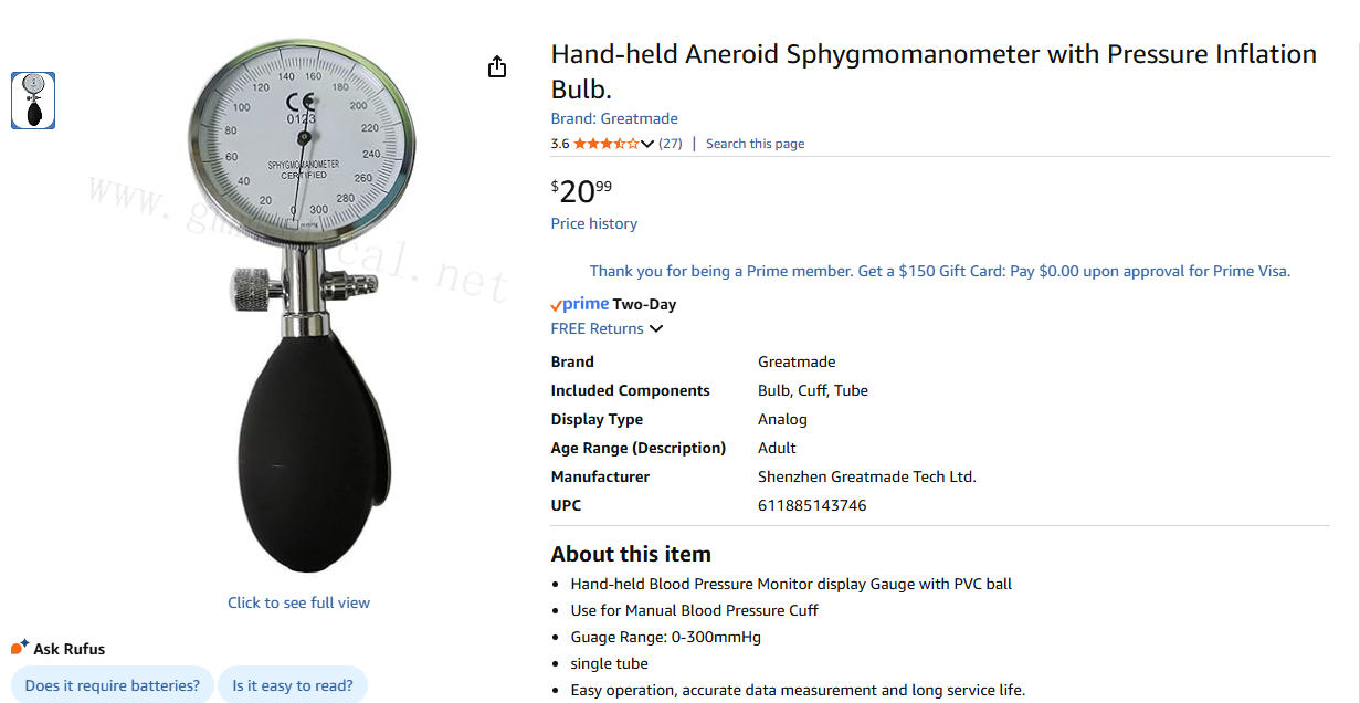

Ordered a new wastegate actuator from turbochargerpros for about $50. I'm pretty sure I've been running with minimal (if any) turbo boost for a while now. Hoping this failed diaphragm fix will restore turbo function. I don't have a good setup for resetting the wastegate preload. Was actually going to get a cheap sphygmomanometer with bulb (similar to a blood pressure cuff) but it only reads up to 6 psi (300 mm/Hg shown below). Maybe that is good enough, as I've heard factory value is 4.5-6 psi. Other pressure gages run up to several hundred psi and there's no way to be able to dial it in to low ranges effectively.

sphygmomanometer
sphygmomanometer
