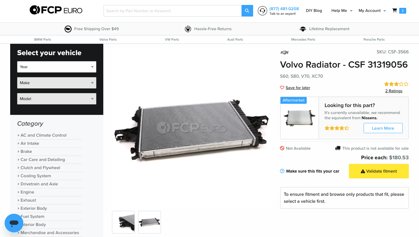

Just a warning for anyone doing research and considering buying a CSF radiator for their P2:
I bought a CSF from FCP Euro after doing some research and seeing generally positive things about their plastic OEM style radiators. I also felt reassured because I've gathered that FCP is very careful about the products they list on their site.
My confidence could not have been more misguided. I installed the CSF radiator only to realize that the transmission cooler lines wouldn't seat fully into the ports on the CSF radiator. In fact, neither the top nor the bottom port would accept the transmission line enough for the plastic green clip to lock in. The clips went perfectly fine into the OEM radiator I removed and I tested a backup set of OEM transmission cooler lines and confirmed it wasn't just an issue with the lines on my car.
This is either a case of a completely incorrectly designed part or the transmission cooler ports installed on my radiator were just from a bad batch, but who really wants to risk it?
It does look like FCP Euro has now removed these from their site, but I still see them available from other places.
Now my daily driver sits in pieces in my driveway while I try to figure out how I can source a Nissens radiator the quickest.
Hope this helps someone else avoid a headache!
