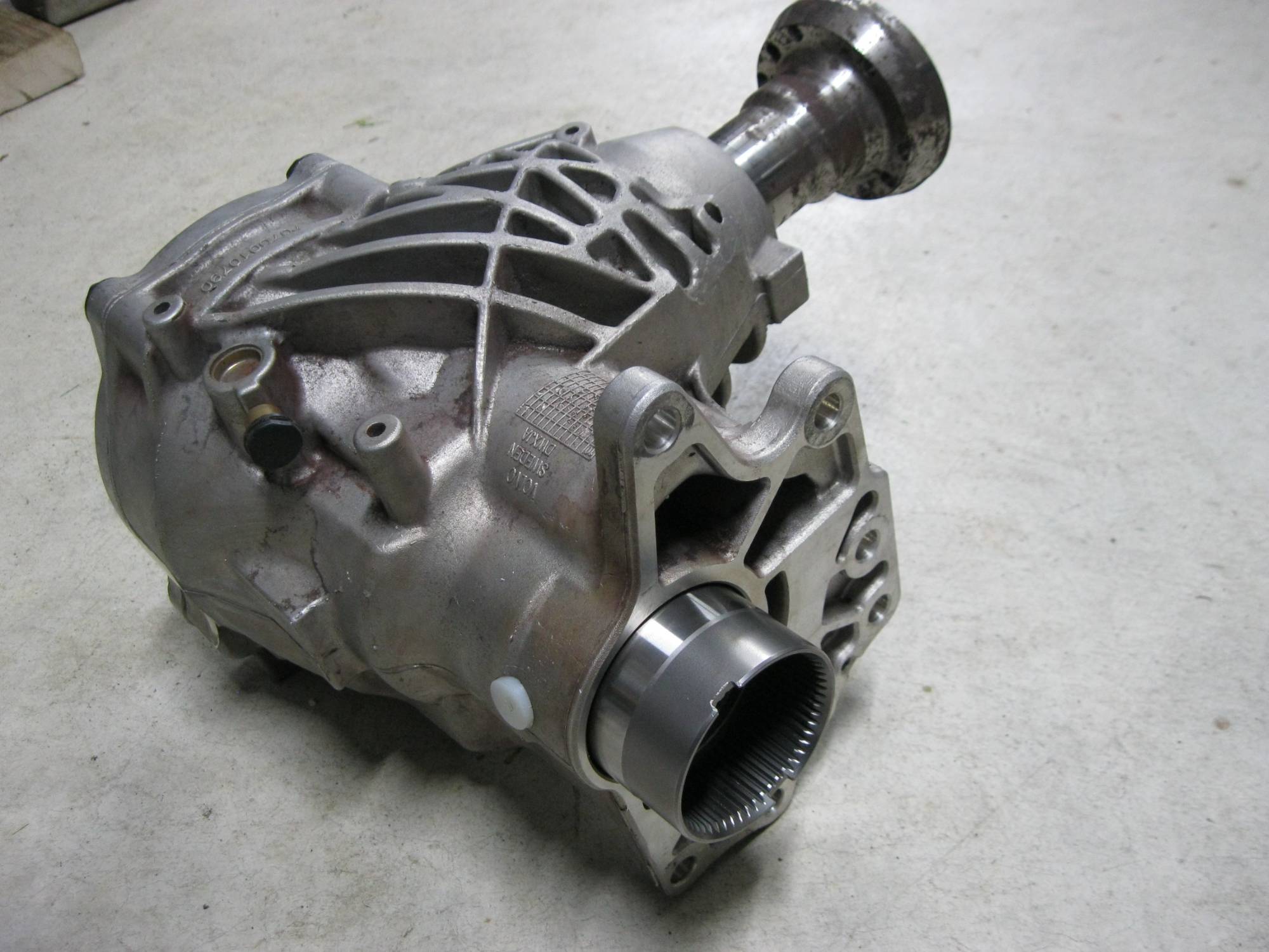

Angle gear back. Machinist went into the input shaft with a flat bit (no bevel) a little to get some weld material as a "pin". Inner sleeve seal will be installed backward so it does not lip, R axle will go in and I'll try and center things as best that I can before cranking the 7 bolts down. I'll post when it's done and I'll keep this link for updates. We'll see what happens.

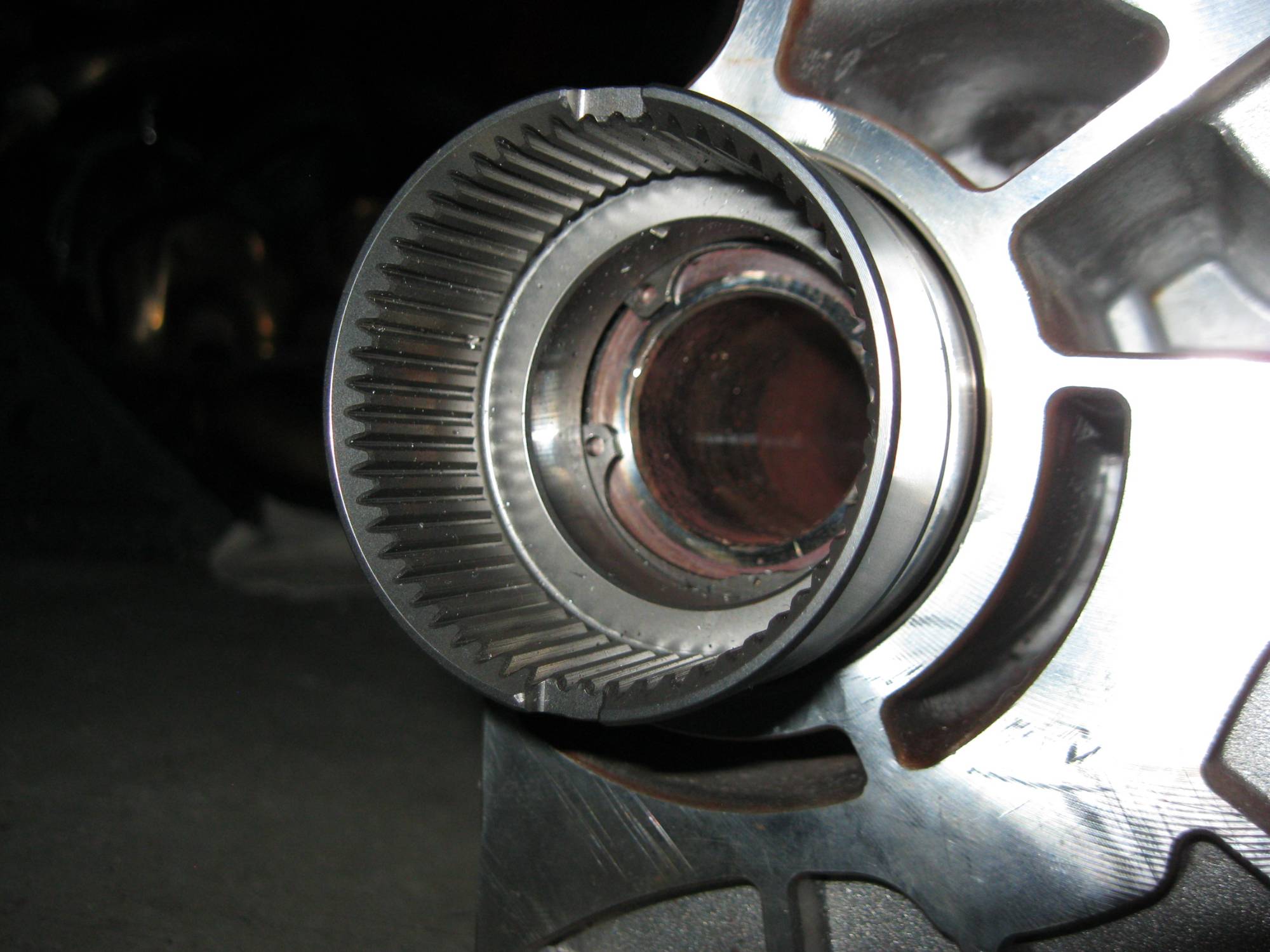

Looks good, I'm not real familiar with the P-3 angle gear and collar sleeve as compared to the P-2's. I would ask how tight the splines and collar fit on the transmission end on the P-3? On the P-2 the collar and splines on the transmission end seem to have a slight interference fit, hence the necessity to use an incredibly powerful puller to remove the collar. For this reason I had to file every individual spline groove to ensure that the collar sleeve "slid" on and off uninhibited prior to welding it onto the Angle gear, such that the collar sleeve and angle gear assemblage could be removeable once installed. Also there may be a specific hygroscopic grease specification for that end of the splines.

New collar had good "bite", we'll see if the welds hold. On my TF-80, the collar literally falls out when the gear is removed. I "feel" like the gear went in okay, had to move it a bit to get in the last 1/2 inch or so. Went in fine overall and, as the inner seal was reversed, I'll hope everything is correct. Really, I don't know how well this will work but I'm curious to see if it will and I have resources to replace whatever is needed with new if things are not satisfactory.
