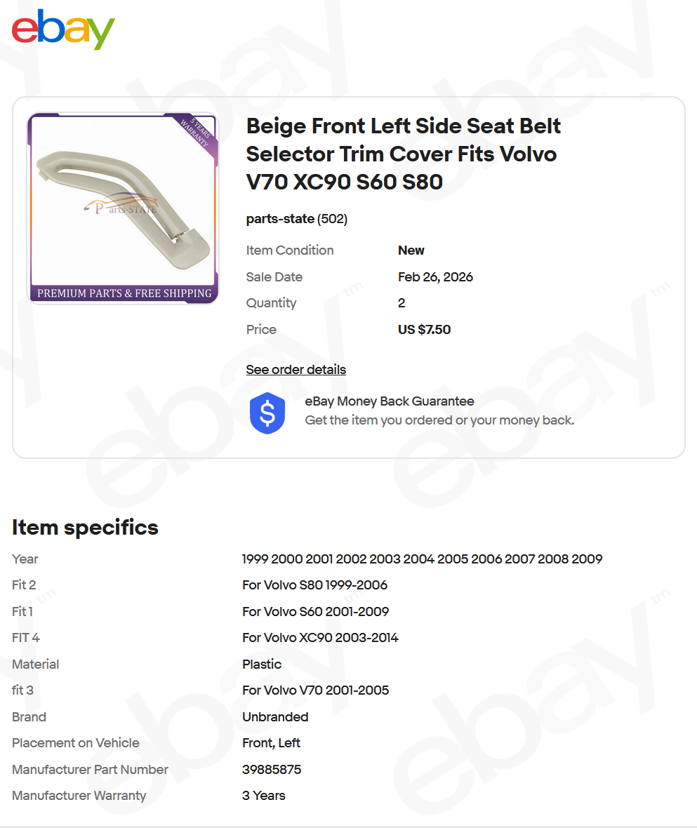

I ordered 2 of these after the seller accepted an offer of $7.50 each. Ordered Feb 26th and arrived today Mar 15th. Total with shipping was US $19.31.
The split section has a bridge and I'm assuming it's for protection during shipping or part of the mold. From the eBay listing picture it looks like you have to snap it in order for the seat belt to slide in.
Beige Front Left Side Seat Belt Selector Trim Cover Fits Volvo V70 XC90 S60 S80
https://www.ebay.com/itm/406555876917

Good price. I paid $27 for one from dealer. Currently waiting for it to arrive. As far as I understand (and plan to do on my car) you snap(cut) that part to slide belt in and click in place. Hopefully it will not pop out each time you use the belt.

Superglue toothpick? I am having a hard time imagining why such would be necessary. I am waiting for my replacement part, but cant imagine doing toothpick. Based on the picture it looks like that cut was made to get the belt through. Then via "jaw" clips it connects to the b pillar where it should self center itself. Please help me understand what I am missing. (Dont want to break $25 part)

My guide went about a year ago. Seat belt was snagging on the worn guide.
Got a new one from the dealer.
The guide is not a complete circle as it has to surround the belt. You just bend it open at the gap and move it over the belt.
Then close the gap. Slide it up the belt to the pillar. As the guide fits into its location, it is secure and won't open.
